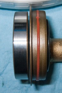

Post by wjw »
Anyone used Marlin Axle Seals on their 80?

Post by mudlva »
Havent seen those seals looks interesting..
Humm re parttime issue. Same set up as 40. 60 and 70 series and they dont leak...
Doneno otherwise
