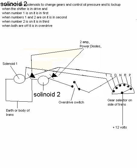

here is my manualization I did to my Toyota with the A340 style auto.
There is a heap of info for the A340 or AW4 on the net...
