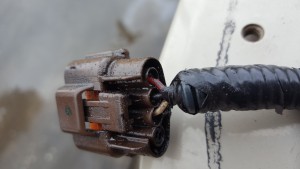

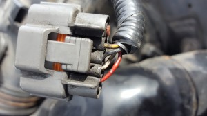

Posted: Mon Aug 28, 2017 1:35 pm
by Bompie
zd30 afm
zd30 afm
does this work? trying to do it off my phone.

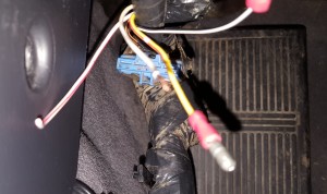

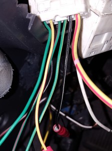

by Bompie
qd32 body loom plug wires
last pic is the zd30 loom

Posted: Mon Aug 28, 2017 7:04 pm
by Crash bandicoot
Bompie wrote:20170827_092941.jpg
That one is easy. Positive ,negative and ecu value out
Use the qd a.f.m the zd30 plug will have a temp sender as well for ambiant air temp.

Posted: Mon Aug 28, 2017 7:22 pm
by Bompie
easy fix that one then. thanks. now to sort the body plug. white with red stripe. traced it on the qd body and it goes into the main body loom plug. then i traced it on ecu loom and it goes to ecu pin 56. white wire traces back 2 ecu pin 61& 70. now i dont have a qd32eti ecu pinout but i have some others and they are numbered the same. browsing through a couple of diagrams the 3 pins (56,61,70) always seem to be 12v power supply 4 ecm. i might try and locate a 12v supply from the eccs relay and try to power it up.
Thoughts?

Tonight's update. It runs. i went back to the doner truck and traced the wires. the red/white goes to egi relay pins 3,6,2 the white goes to egi relay pin 7. The yellow/red goes to egi relay pin 5. the black/white goes to fuse box fuses 16,17,21,22,25.
so back to the 2 body loom plugs i joined the black/white together. i joined the 2 white together . i joined the small yellow/red(qd side) to large yellow/red(zd)side. then ran the a 12v+ to white/red. and from that it runs. i havnt hooked up the temp gauge but i know its the small yellow/red on the zd side of body loom plug. hope this info will help anyone else in the same situation.
