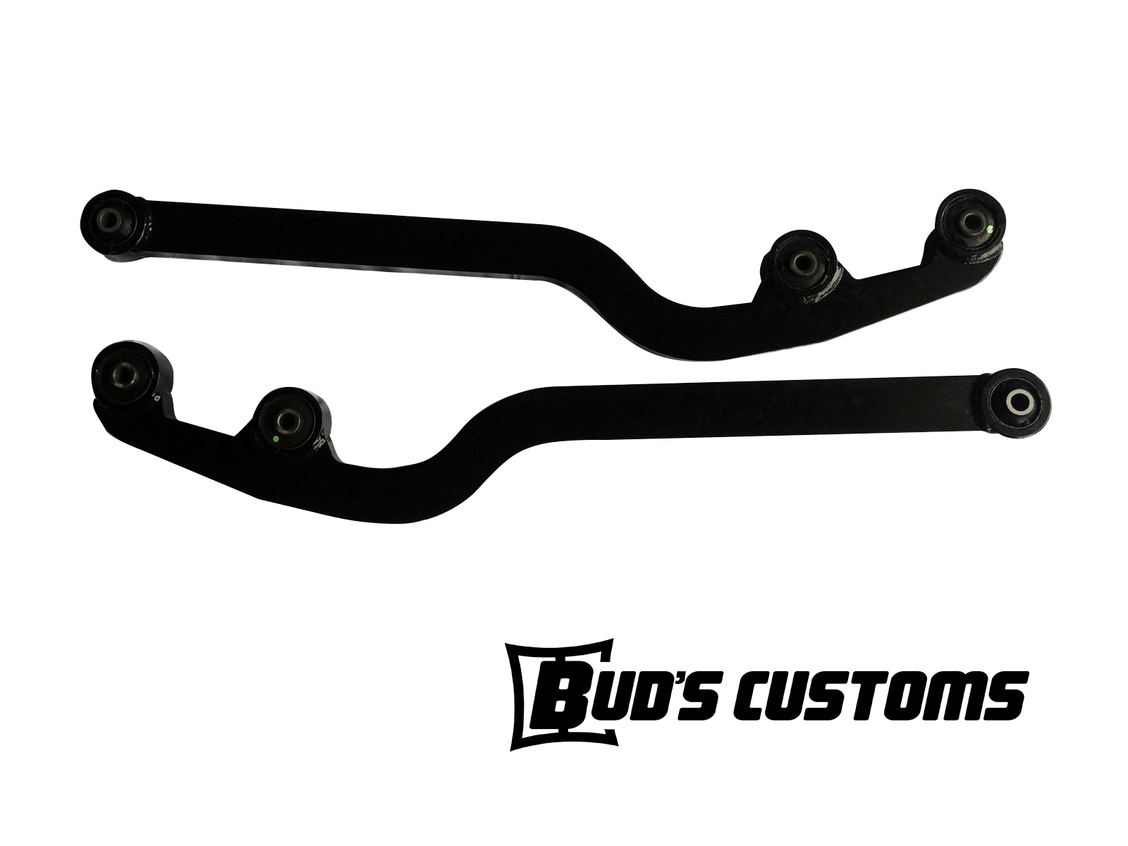

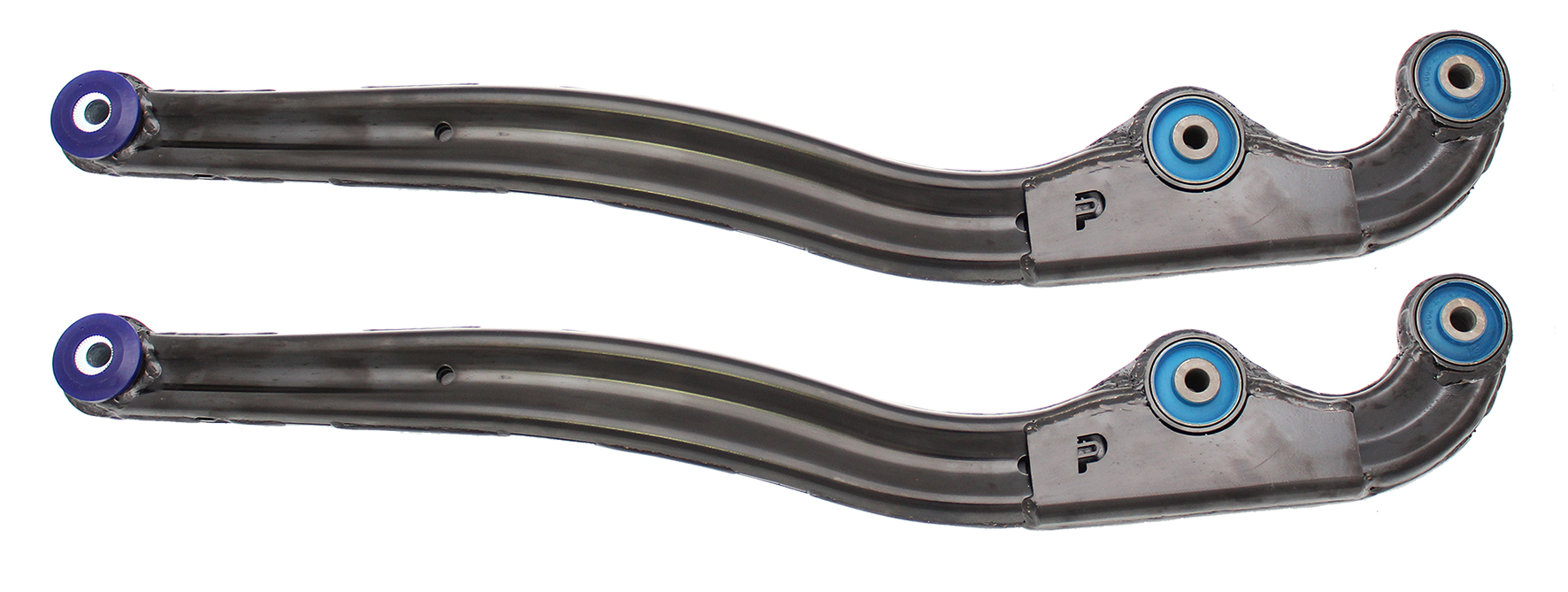

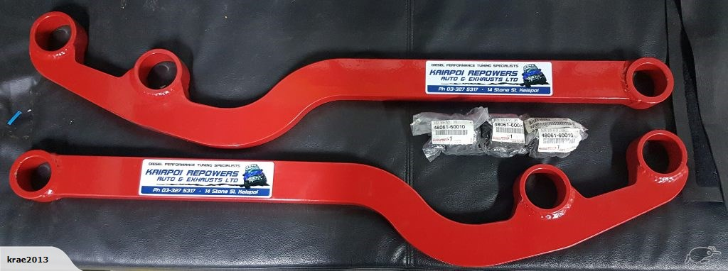

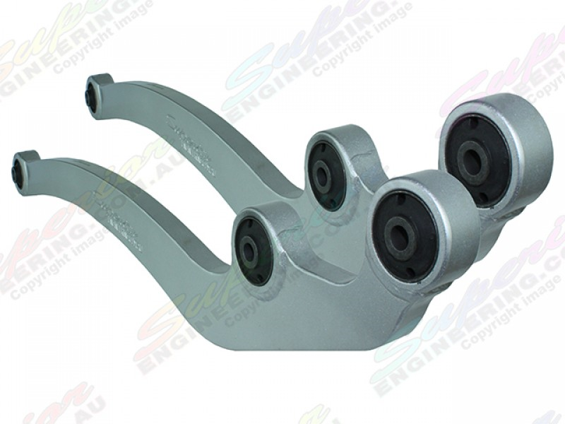

has anyone or know of anyone who has made their own radius arms? how did it work out?
there are a few that can be bought but aren't cheap.
can't be too hard for a competent engineer can it? need to be certifiable.

You probably can't angle the arms up very far on the diff like that without them hitting the steering tie rod that sits above them. You can see the custom arms in the pics above have a big kink there to clear the tie rod.

No worries then :D My LJ71 had it behind but hilux/surf must have it in front? In that case you'd probably be better off making your own vs aftermarket lift prado arms as you could make them without the kink & they'd be stronger.
