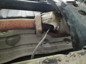

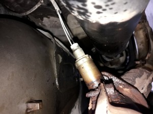

Gidday,
In the process of ripping out the exhaust on my 94 Terrano and I found these. One of them has to be an o2 sensor?? (big one?) But what about the other one?? (small one?)
It is a vg30e motor and manual.
Cheers.
Josh.
BlakeNZ
Posts: 710
Location: manawatu
Re: What are these?
Post by BlakeNZ »
small one is a cat "overheat" sensor.
sirLachlan
Posts: 109
Joined: Sun Apr 03, 2016 8:28 am
Re: What are these?
Post by sirLachlan »
The small one does nothing other than turn on the cat temp light on the dash .
The big one is for closed loop fuel trim at idle /cruise . Saves you gas
