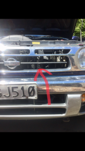

I’m wondering could it have anything to do with the fan in the pictures below as I have never seen or heard it on. Started truck today and put aircon on and waited and still not on. Could this be the problem?

From my perspective, i would replace the thermostate with a genuine nissan one, replace waterpump and viscous fan, take the radiator in to get professionally cleaned or replace it with a new one. I put all new parts on my terrano qd32, i towed over 3.0 tonnes with it up a steep hill afterwards and didnt move on the gauge.. The fan your pointing at i belive is for the a/c to cool the condenser.
