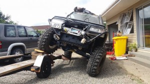

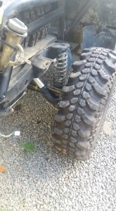

so been a few days since i posted here .... week or so haha
went and sawed the factory mounts off a pajero chassis for the trailing arms what a arrrssseeee of a job lol
cleaned them up and fitted them onto the chassis where i needed them i wasnt sure of placement as in do i run them on the under side or out side but i went with out side so far so good .... fingers crossed
made a plate to beef up the chassis rail at the front as chassis was only made of 2mm so ran some 3mm down it to make it stronger you cant see in the pic but i have drilled a large hole through the plate and secured the plate in the middle also so plate is fully welded on the edge and also in the middle
went to the scrappys today and got some heavy wall pipe for the steeering shafts that are now longer so have sorted that as well today
i allways go for the paint it when its together method and it allways looks crap and cheap so i buffed the diff head down today primed it and brush painted it with a couple coats of blaaaaaaccckkk my favourite colour haha
ended up fully welding the brackets and priming around the brackets and the parts of the housing i was finnished with
yet to come is the panhard mounts and the shaft it self i was planning on running a pajero factory panhard but i think the bushes will bind and steal some travel/ flex
ill dump a hole heap of pics here
not bad for a young bugger in a cramped single garage i reckon haha quite stoked how its coming along
poor little suzuki :lol: :lol:

all the pics didnt load grrr sorry if theres double ups

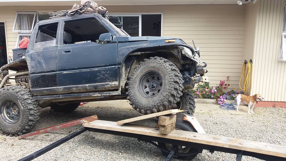

got the truck together enough to drive it today after making the panhard brackets and making what may be the most piece of over kill panhard for a suzuki haha i ended up going with a cat1 size tractor link (for using impliments behind tractors ) they use a very robust rose joint / rod end so i have sorted that mounted it heres a flex shot i think i need softer springs yet

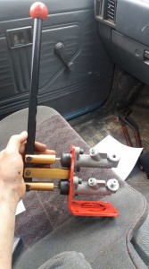

so got a bit done did the rear end while i was waiting
shaved the bottom off the diff ,added diff trusses mainly due to having them laying round for a 413 so made them fit
added discs and vr4 galant calipers
used a boc locker :lol: in the rear and installed it and repositioned the shocks as well
added a fiddle brake set up as well got this from e bay and mainly went with this design to save space in a tight cab
and man what a bastard to bleed up !!! took 3 litres of fluid and a lot of time and swearing !!!
sorted now

axles back and fitted up all is well lost a bit of huff on the project and want something turn key fun ! so this is up for sale at the mo see what kind of hits i get

i ordered some mean 10 inch travel bilstein shocks from 4wdstuff gret guys btw! (shameless plug there !)
fitted them up yesterday used the modified mount i had made on the diff housing earlier andc mr suzuki the legend put a crossmember right where i needed one so drilled through that 100mm off centre and ended up using honda accord 97 ish 2.2l front springs in it they are damn close to being grouse ! soft enough that with all my junk on the tray it dosent loose too much height but still a long ass spring !!!
today should see the airlocker being installed into my spare diff head
and hopefully my gearbox in the old tow rig re installed and sold welll fingers crossed !
will post pics of the tre airlocker and install when i do it

heres some pics for ya troubles
subaru seats from a subaru outback
the front drive flanges
rear end
and also my tray i want to change but not sure on design yet
