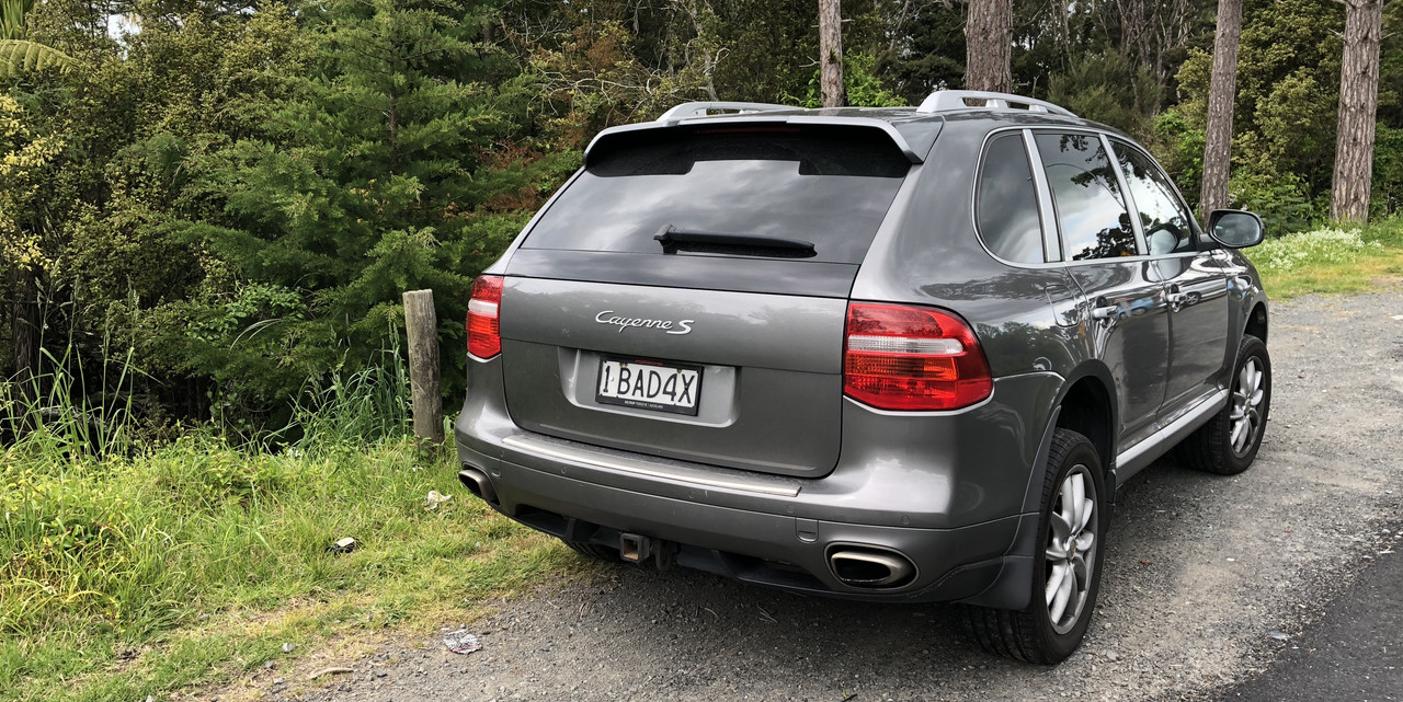

So I sold the X5
Now for the next project....
Should be better off road than the X5 as the Porsche has diff locks & Low range.
