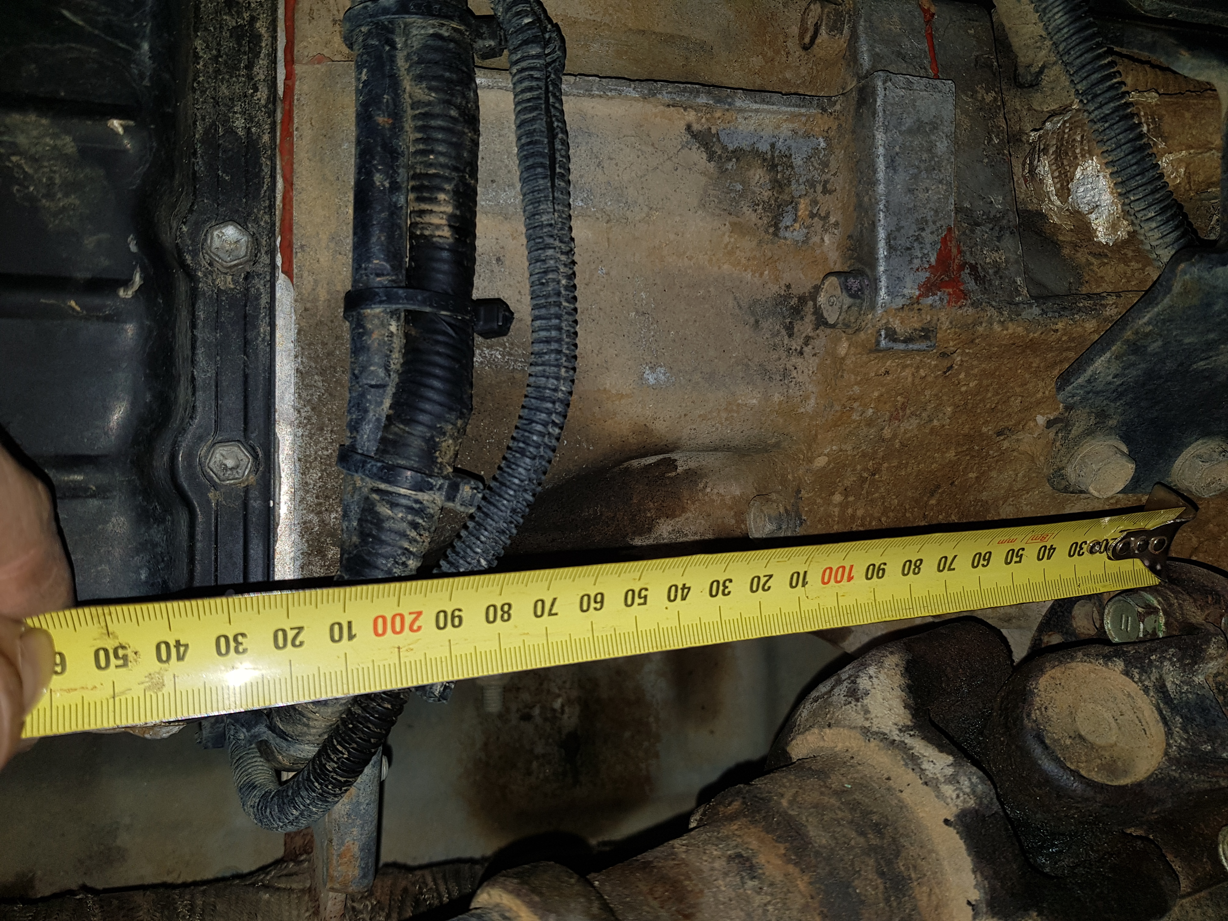

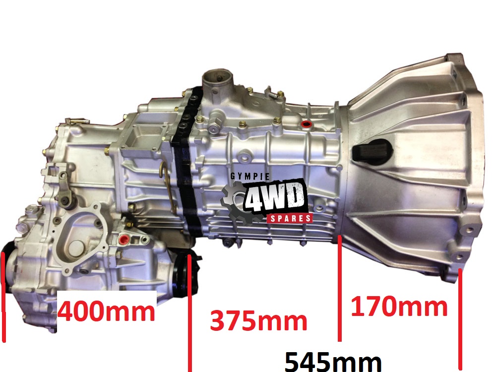

Ok some numbers for you.
Ignore the fact I have grabbed an image of a manual 80 series trans... It just shows a good overview of where I measured from...
The distance between the two mating faces of the transfercase drive shaft flanges is the 400mm dimention...
The 545 measurement is from the joint between bell housing and engine back to the front face of the drive flange.

interesting it would mean my front drive shaft would be approx 220mm shorter than it currently is, so overall length would be reduced to about 550mm long, seems quite short.drive flange would be about rear trans sump bolts.
rear shaft would need to be approx 50mm longer.
