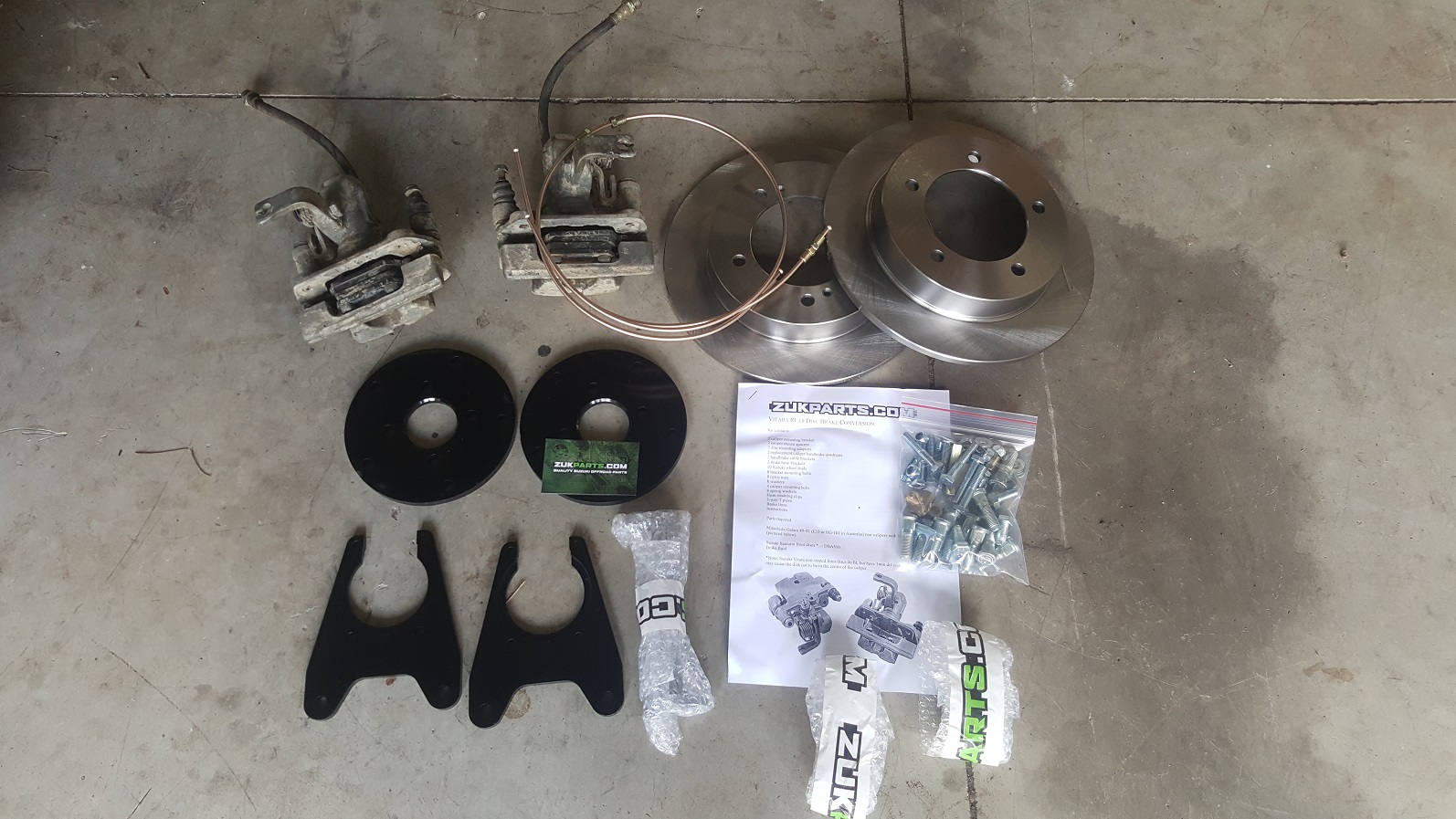

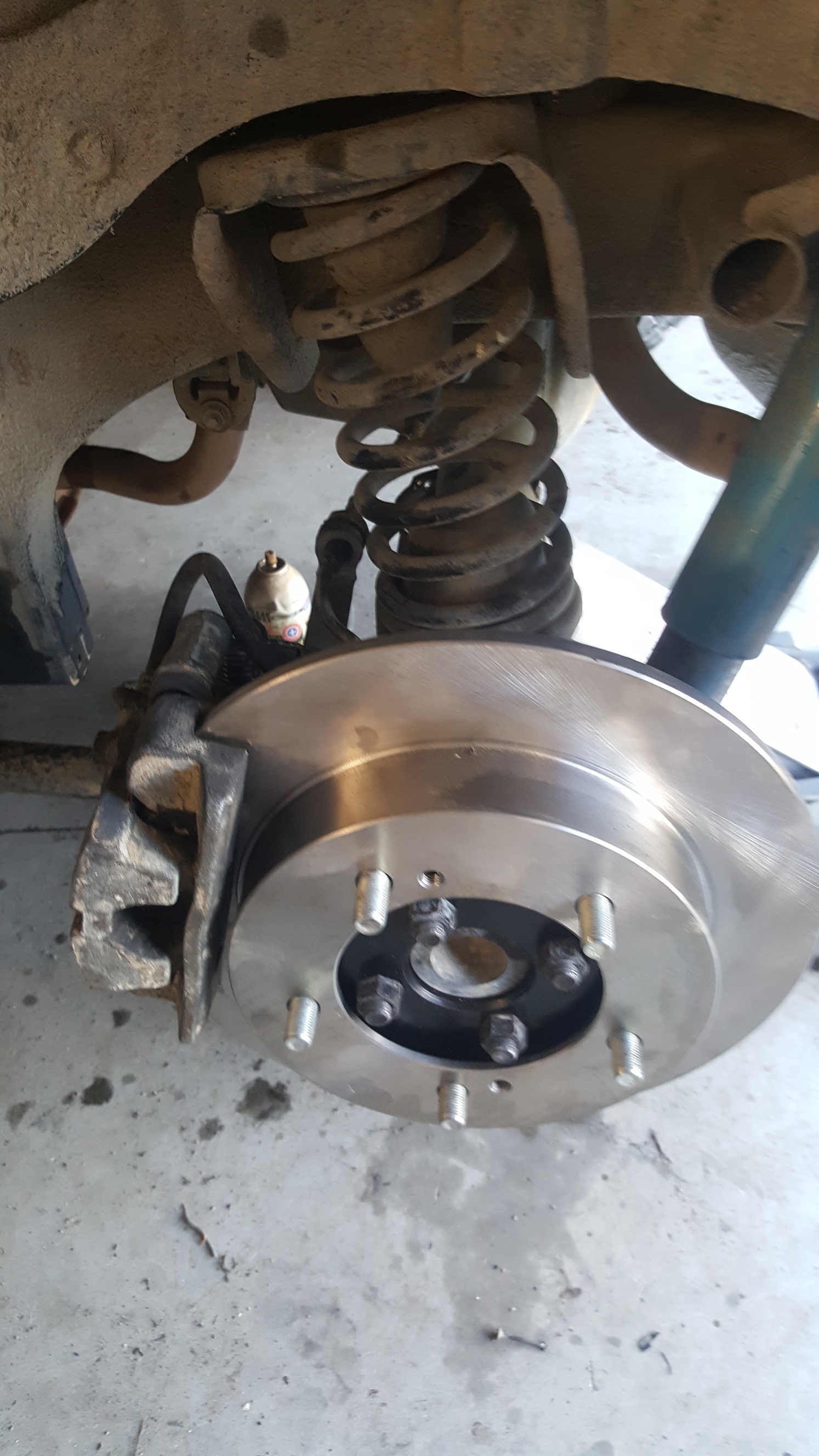

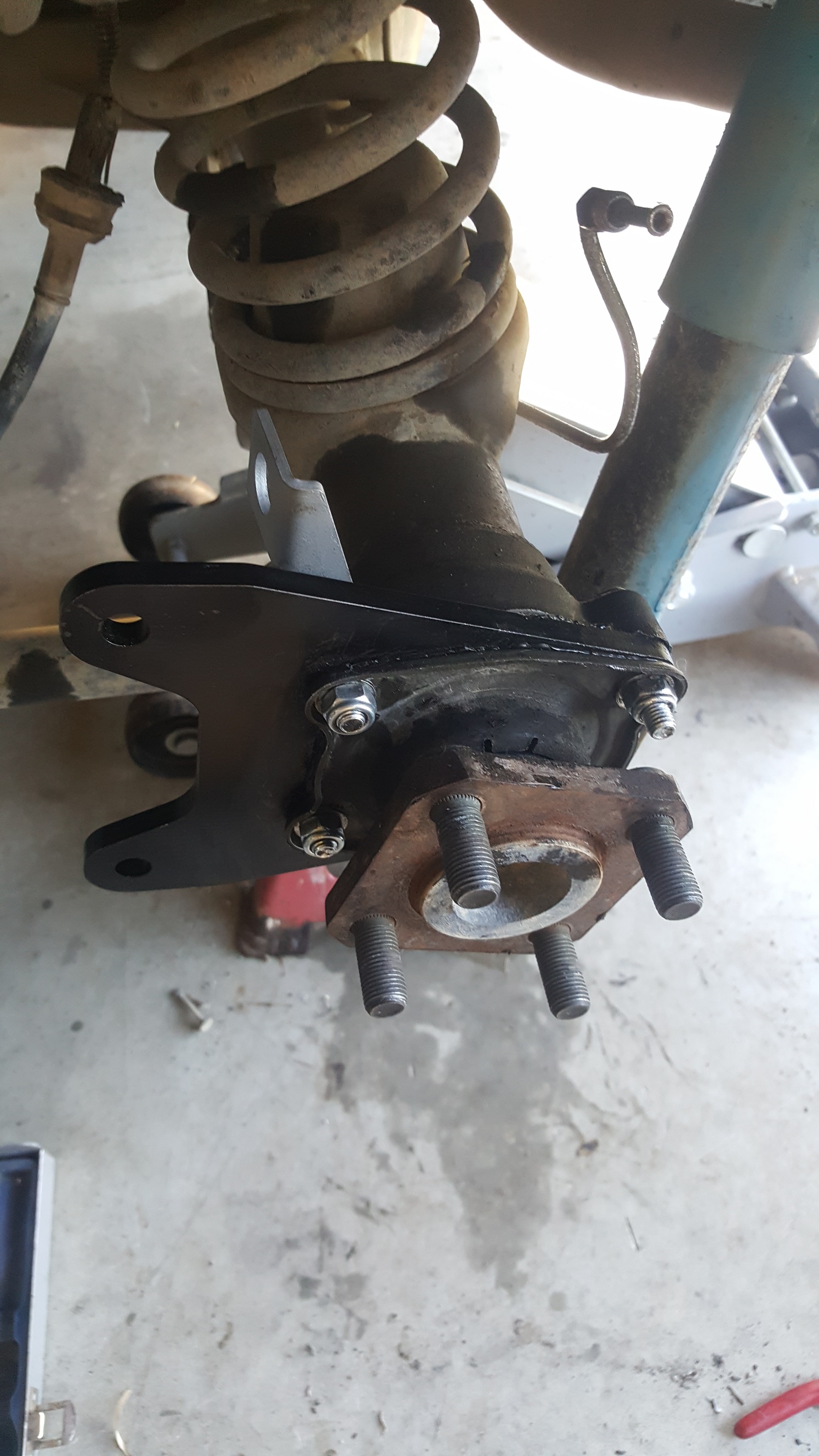

I have just done the disc brake conversion on my 92 Vitara.
Kit from zookparts.com
Rear Galant calipers
Vitara front rotors
Just a few hours some basic tools and its all go, what a huge difference.
Fit the new supplied brake lines, bleed and enjoy real brakes
