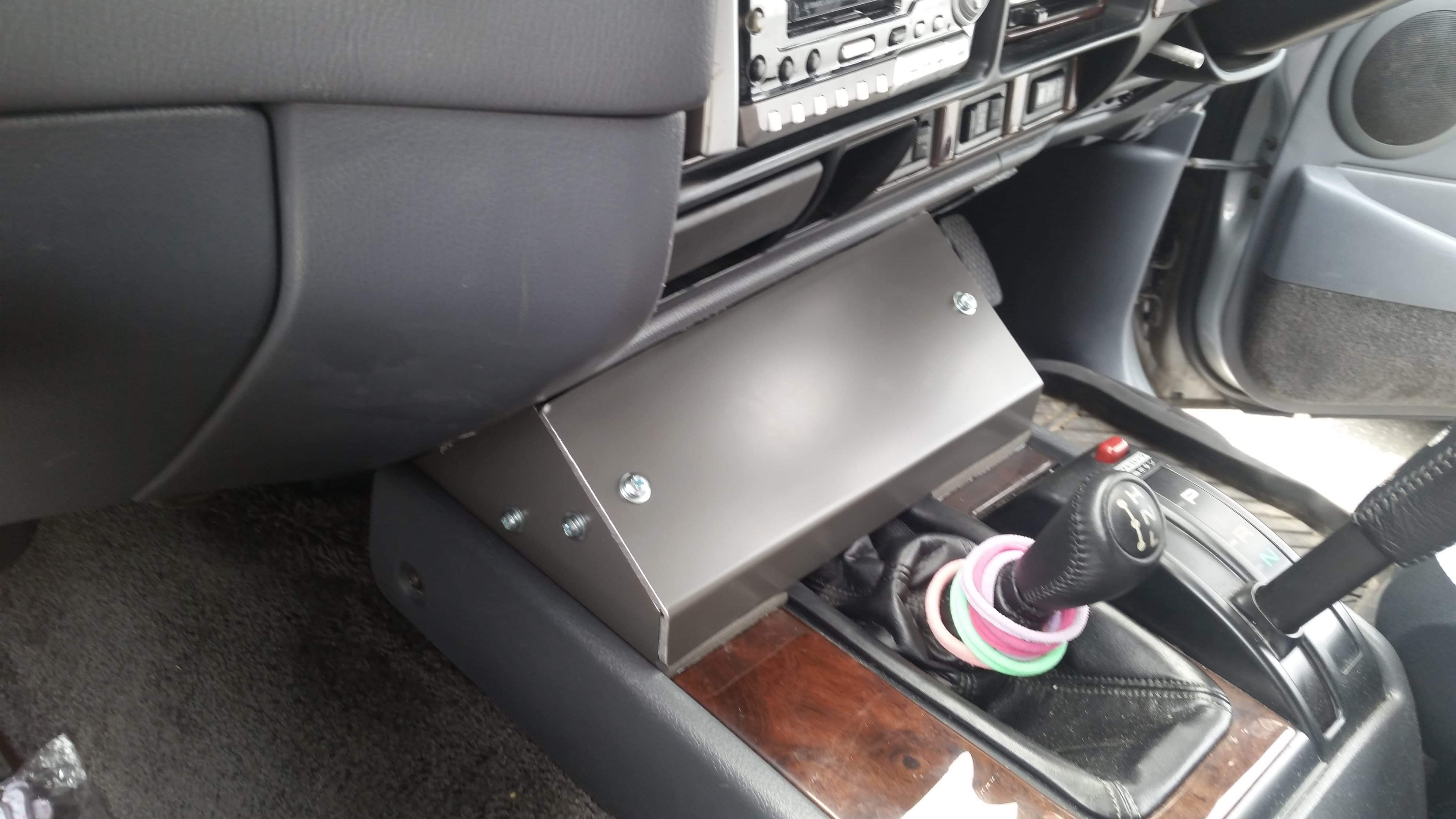

Hope tho photos load. not the best but all i have on me.

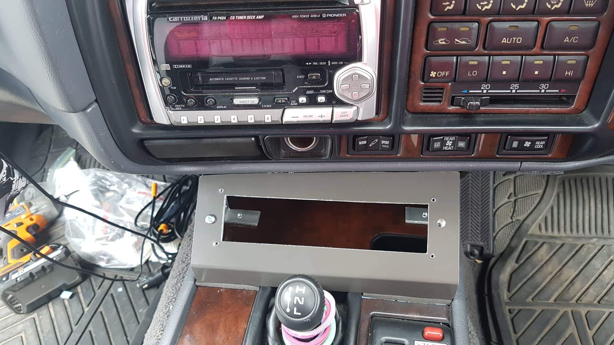

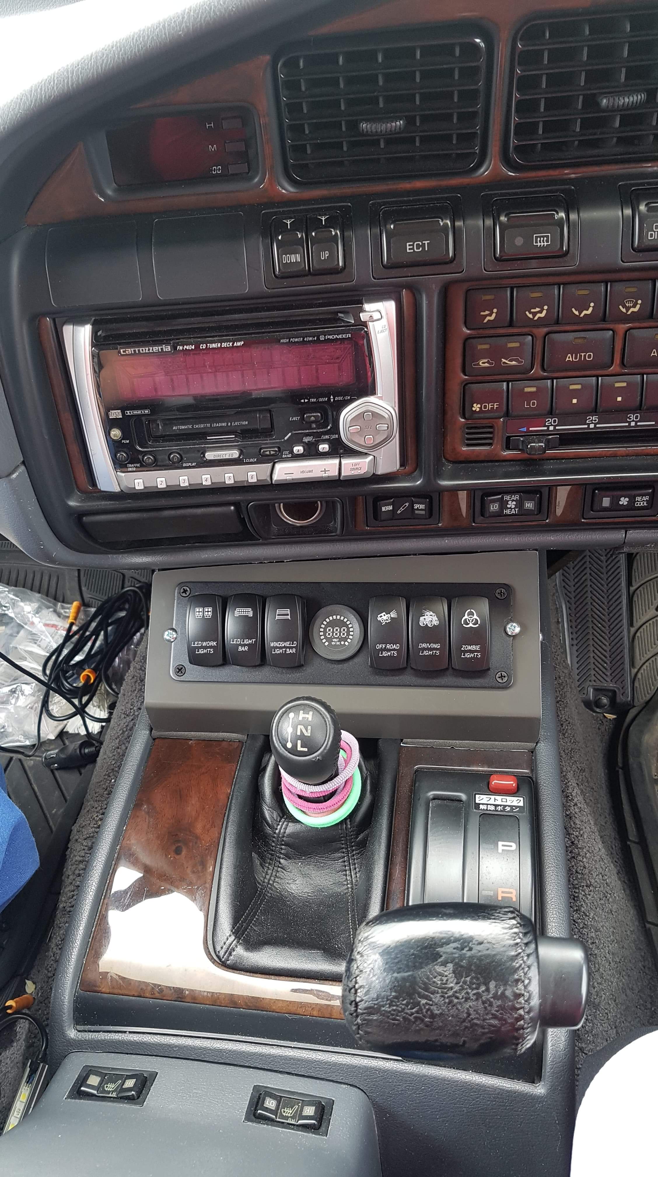

I used some ACM panel and cut to shape to fill in the space below the ash tray. then bought a cheep switch panel from trade me i believe.
works really well and has plenty of space inside the box for cables and and fuses etc.

oh and I used nicer black screws on the final product. the big zink ones were all i had at the time. and just used heavy duty double sided tape and some "L" brackets to fix it down.

Oh i do like that idea! Looks good!!
