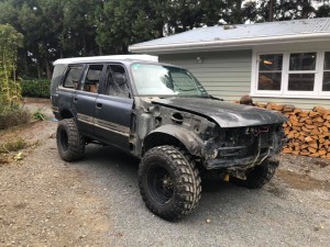

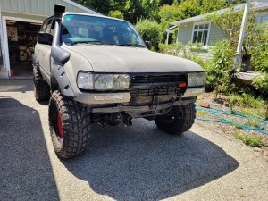

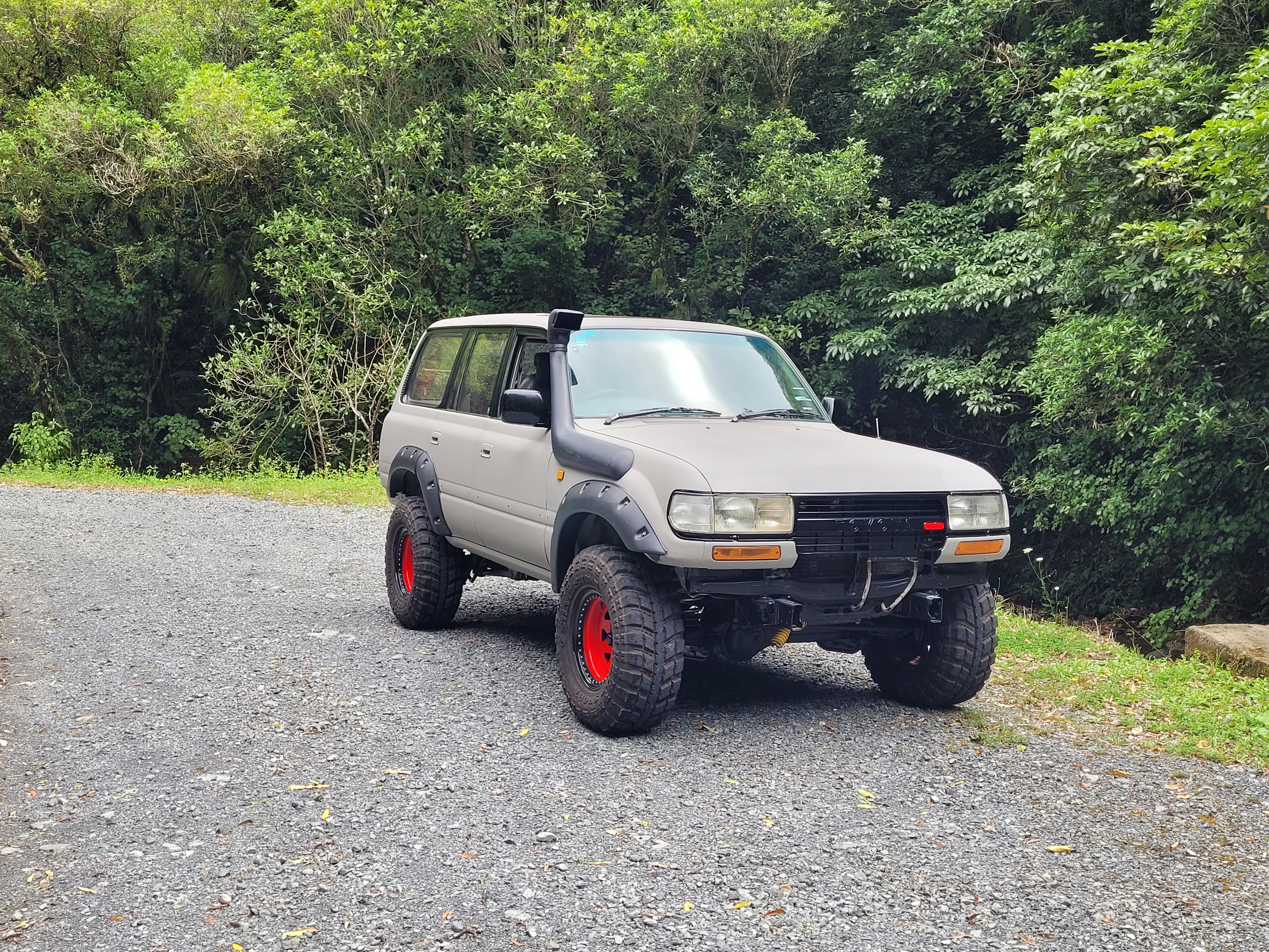

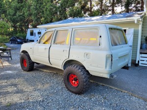

So, on my plan is the progress of my 80 restoration. It was pretty much a clean family truck and over the years has had some fun in the bush. It's too expensive to keep bashing, so a restoration was on the cards.
Here's where I started out.... (Not to shabby)
Updates to come

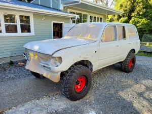

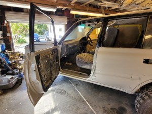

So the journey so far.... Have gone a bit OCD, first started off by stripping everything from the bodywork to find any rust. Planning to do an open door respray.
Planned colour scheme....

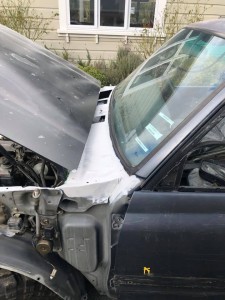

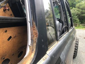

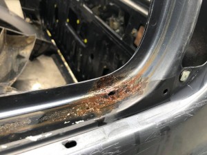

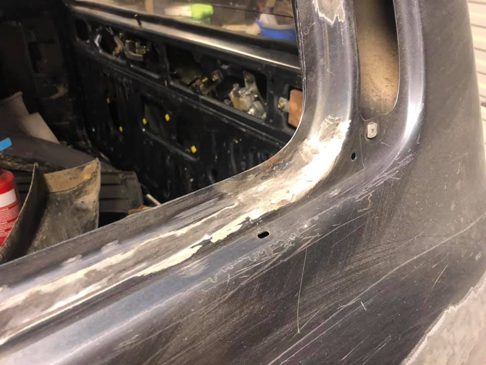

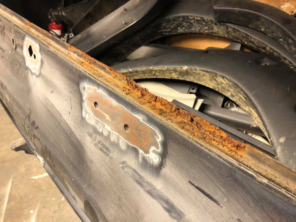

Popped out the windows to find that rust. Most common in these 80's are the rear boot windows. bottom's of doors and front of bonnet.

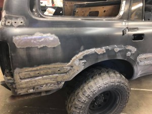

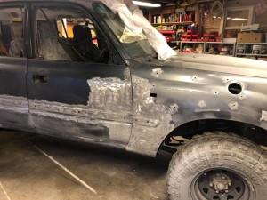

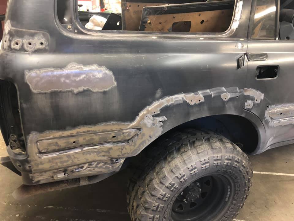

Replatted the rusty areas and took back to bare steel sections that needed some straightening out...

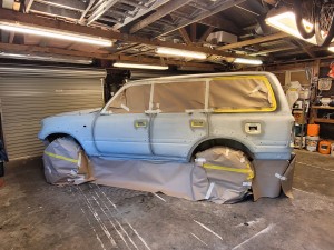

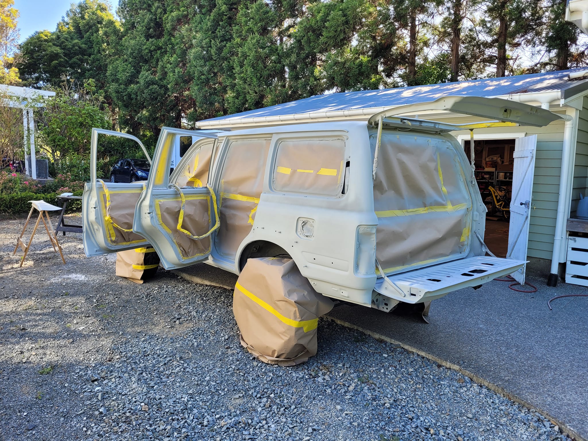

After a long break and back into the warmer weather, I've managed to get it fully primed and ready for the top coats.

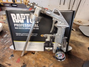

Restoration of the trim. I've also resprayed all the grill, headlight surrounds, mirrors, and anything else in matching black.
Thought I'd keep the theme with the truck body all grey. (Inside doors and jams in 2k grey)
Repainted the window section in matching black.
All external barwork will also be in black.
Final external (closed door) of matching grey raptor, using the vari-nozzle gun. (Highly recommended if you want a nice even finish)

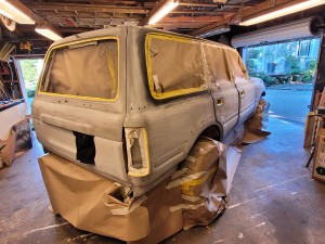

Ok, and here is the first look....
Finished spraying the Raptor and then proceeded to unwrap my late Christmas present.
The guy in this video was spot on. So followed his advice to get a nice clean finish.
https://youtu.be/5ZUlWlCKiSg
Highly recommend the vari-gun with an added gauge to ensure you maintain the right pressure. I used this gauge for all the paint applications.
So that's a hell of a lot of paint combos...
- 2 pack Epoxy primer
- high fill primer
- etch primer
- 2k red, black and Grey
- Raptor liner
The finish came out awesome!
Nice clean lines from removing the masking tape.
Will post some more photos once I've put all the bits back on. But for now a rest and let it cure for 72hours.

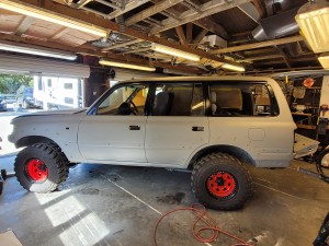

Reassembly progressing well....

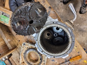

Coming together. Sprayed all the barwork and putting on some bling on, or lipstick...
Rebuilding the winch....I just love old grease, so good for the skin LoL

Ground control, we appear to have a problem
I am a little concerned with David Bowie reconditioning winches.....

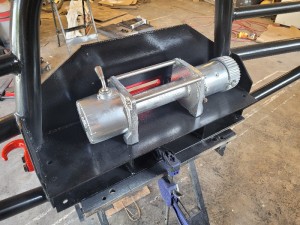

More progress today....
Winch and wiring, barwork and UHF aerial
Good lord, it might just about be ready for a WoF.
Would like to put the side trim and roof basket back on to complete it though.

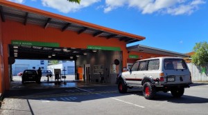

Well after hundreds of hours on this, thought why not.....let's try a WoF so I know what else needs doing.
It's only been off the road and in the garage for 4 years
And the verdict is....... not too bad really. Mainly things for a vehicle that's been sitting for a while.
Will get those sorted out quick smart.

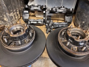

- To fix the front wheel binding and proportioning valve, I've gone a bit overboard and stripped out all the brakes. So now has, brand new front rotors, front calipers fully reconditioned, new proportion valve. While they were off and likely I may not need them, I've installed the new Terain Tamer uprated CV's and new wheel bearings.........so a big bloody TICK
- All bulbs replaced for the Fog, Number Plate, Marker and noticed one reverse light was out......TICK
- Brake warning light, well it helps to top up the fluid reservoir......TICK
- Handbrake adjusted. This has the fix for the dog bones inside the drum done and then just adjusted the cable......TICK
- Rear mudflaps, got some conveyor belt offcuts and made some up. They can be removed easily......TICK
- Window washer ports cleaned out and working sweet......TICK
