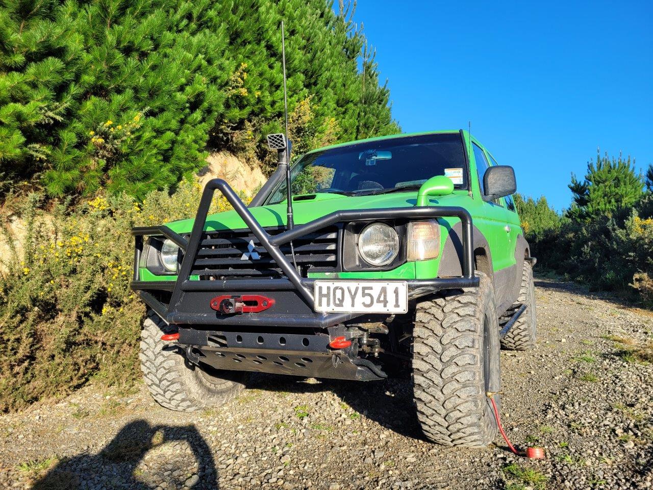

Found my next project and collected it Saturday from Napier.
Nothing like a 4 hour drive back to Welly to find out what's wrong with it.
The bones are all there for a good little truck:
Lifted, 33's and engine swap for a 4D56T (all certified) WoF and Reg.
New Chromoly rear axles and bearings
New front CVs and bearings
It's had a few hands on it with some interesting ideas, but just cosmetic and nothing a bit of time won't fix.
So on the way back home, with about 60k's to go, lost the clutch. No fluid left in the reservoir.
And left rear axle seal might be gone as it's spewed some shit out across the tyre.
Will see what else needs tidying up. Then she'll be ship shape.

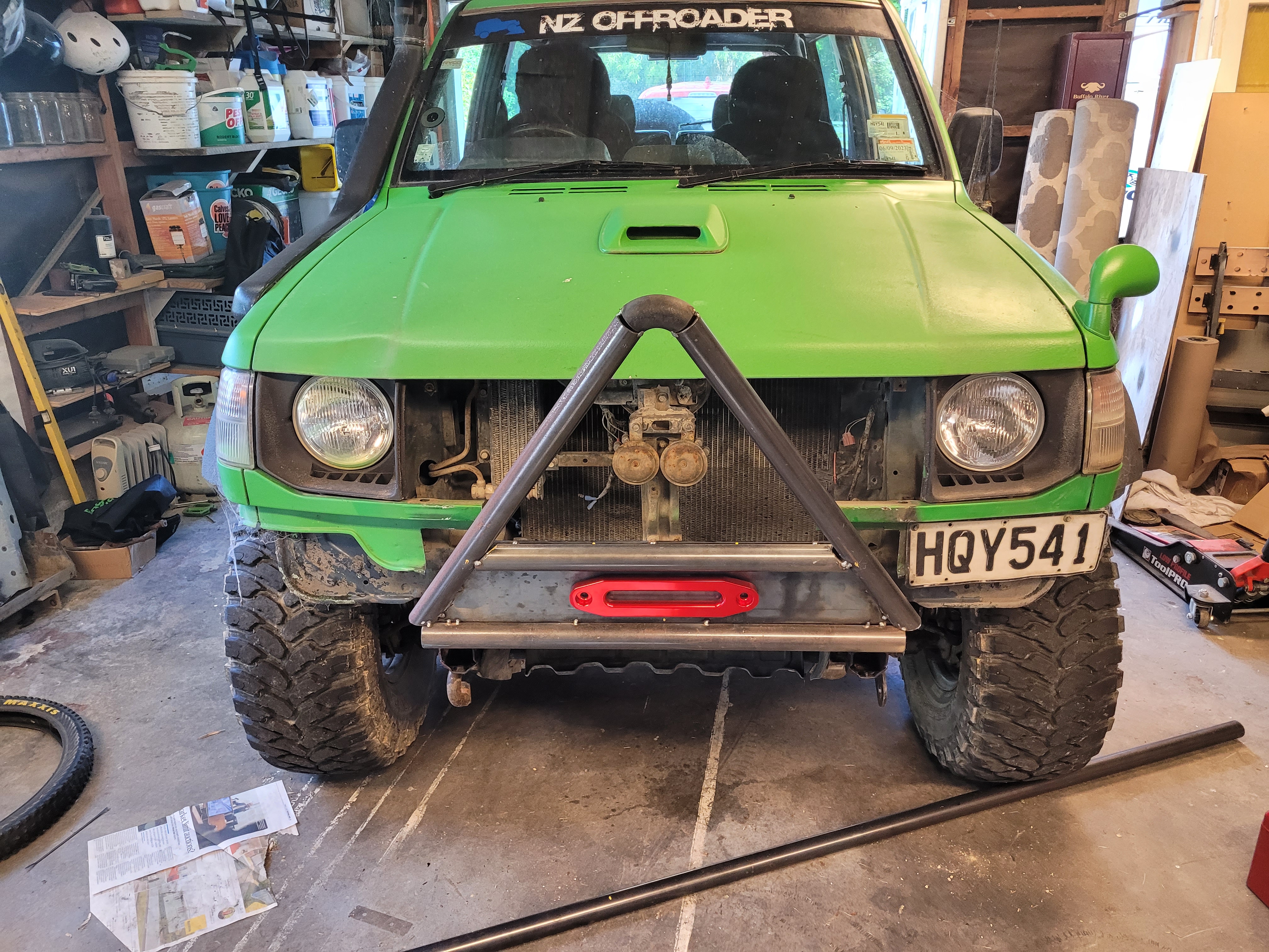

3) Build up some barwork

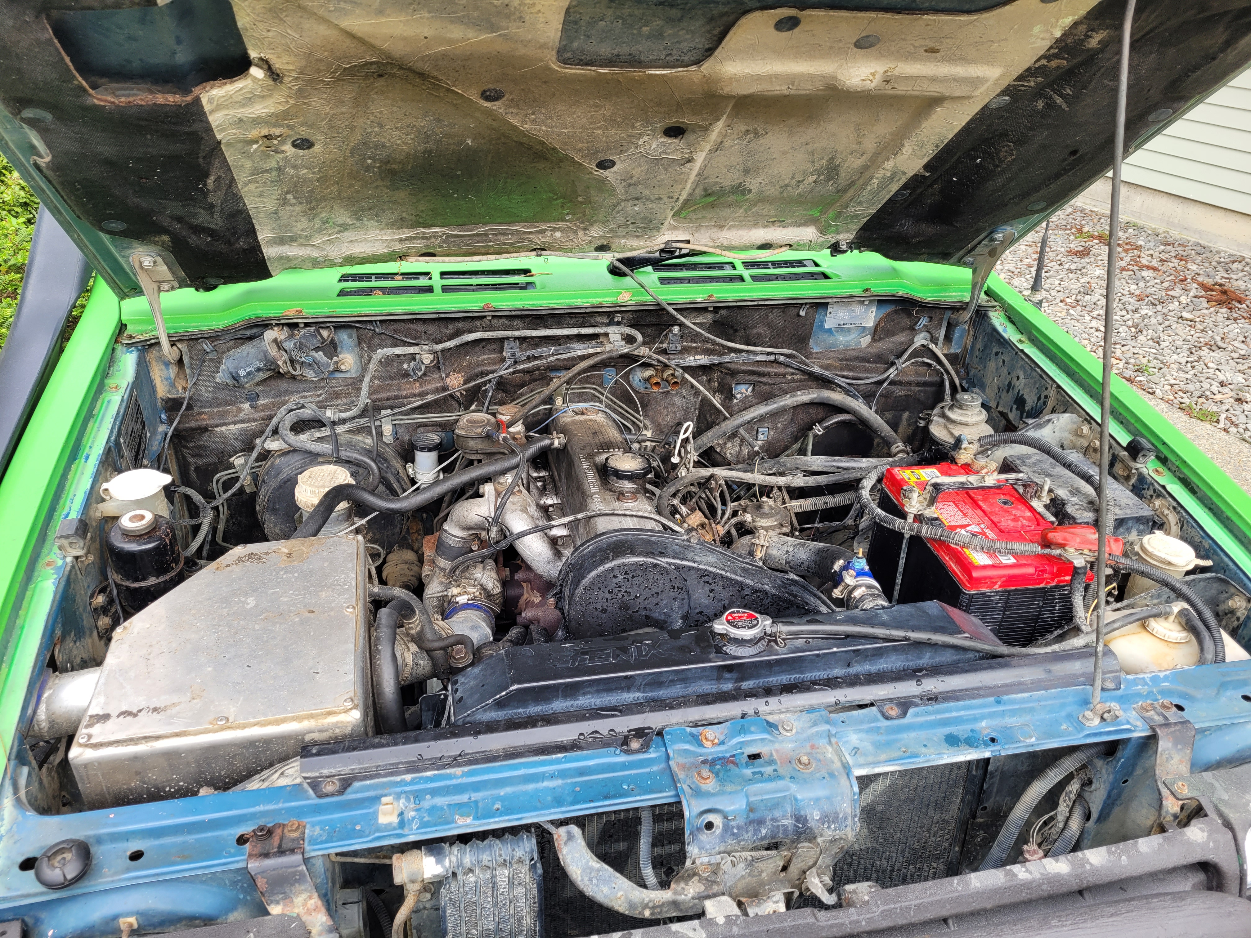

Well, it's been a bit of a slow start.
Daughter's car had to come off the road for a bit and I had to rebuild the A pillar. (Bloody 90's Hondas)
Anyway, reinstall the last CV. Wheel bearings could do with some love. The grease has certainly seem some water. Have heard that those AVM manual hubs can let a bit of water in, so will explore the pros and cons of going back to fixed. The transfer system is a bit different to the 80, where I get a 2WD option. But the whole front drive train would still be spinning with hubs fixed.
Thought I would start off with a bit of a more detailed inspection. Front diff oil looked like grey slime, transfer case had about a quarter left in it. Home-made air box seemed more like an oil transfer system with the amount of shit being recycled from the rocker cover. Will either put in a catch can or just extend the breather into the chassis (self anti rusting technique ) Radiator is being pressurised and so slowly blowing water out the overflow. I reckon stuffed headgasket at the least, maybe head. Will plan on whipping this off when convenient.
Found some rust in the back right cover of the boot. Easy fix and will plate it back up. Removed the remaining carpet and all looks good.
Wiring for the motor is as tidy as my teenagers bedroom. Plus seem to be missing a number of controls in the cabin.
Check out that earth srap bro... Winch isn't running, Well not even wired in. WTF
Seems like someone was hungry and had a chew on the drivers seat.
So for a start I've flushed and replaced all the oils for diffs, transfer, Gbox, Engine. Actually runs a bit quieter now.

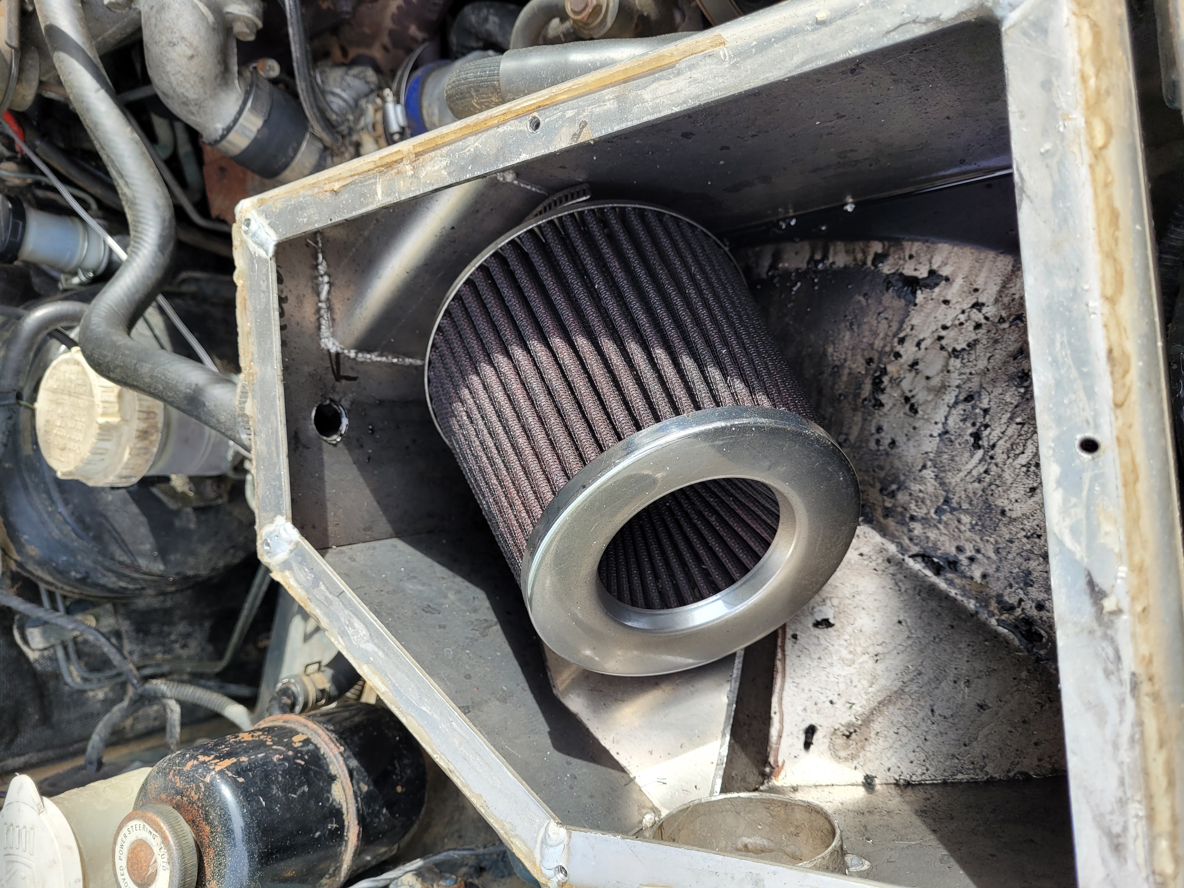

Whipped out the airbox and will replace that useless pod filter with one of those Ryco O2 Rush filters. (Better filtration and cleanable)

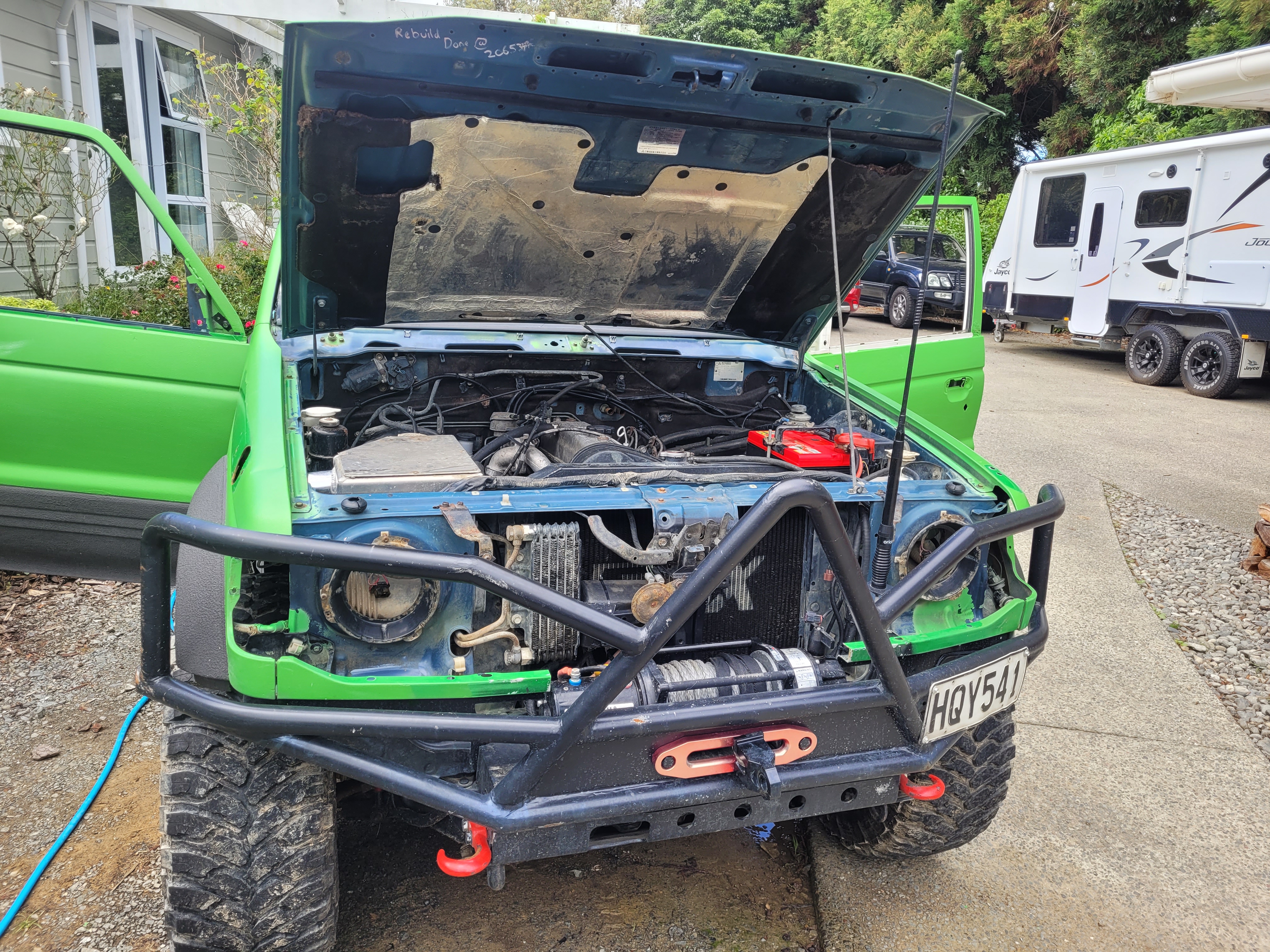

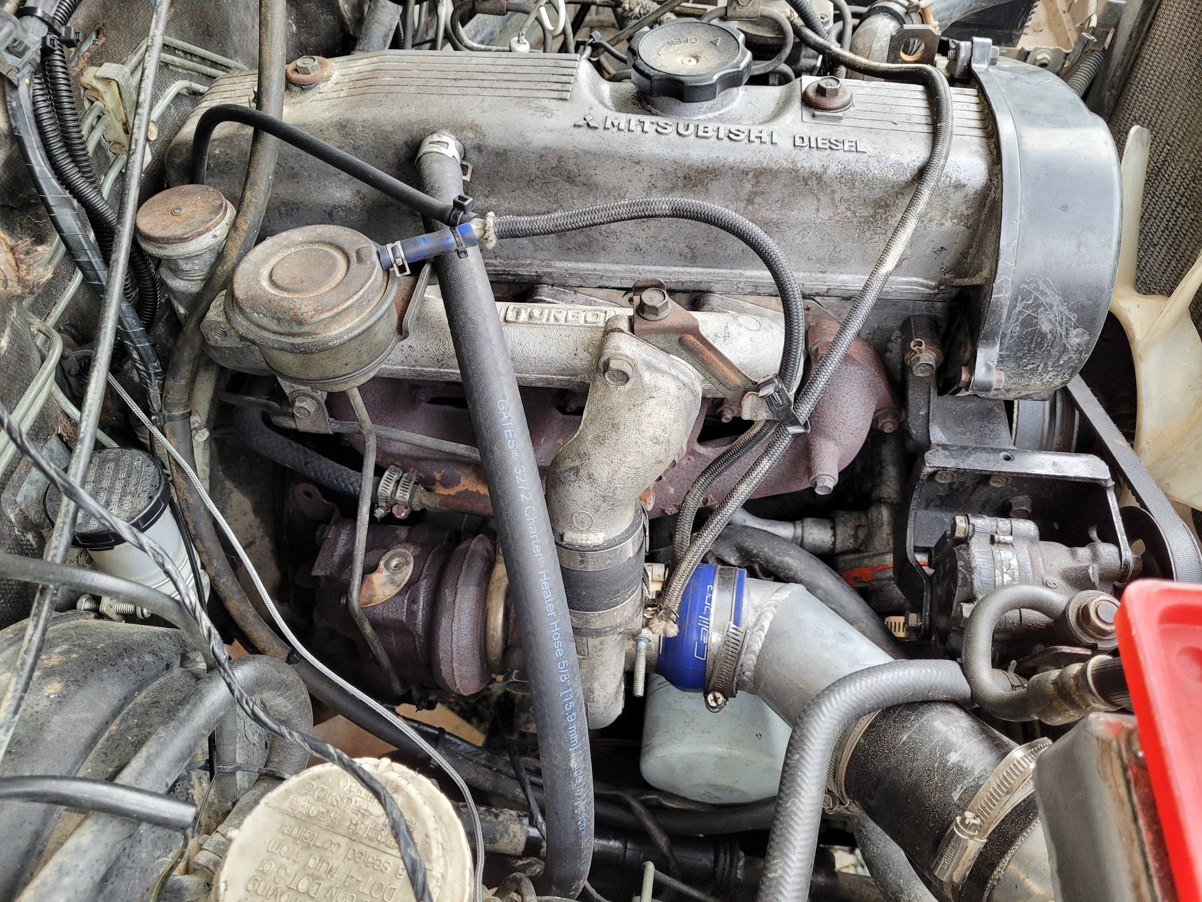

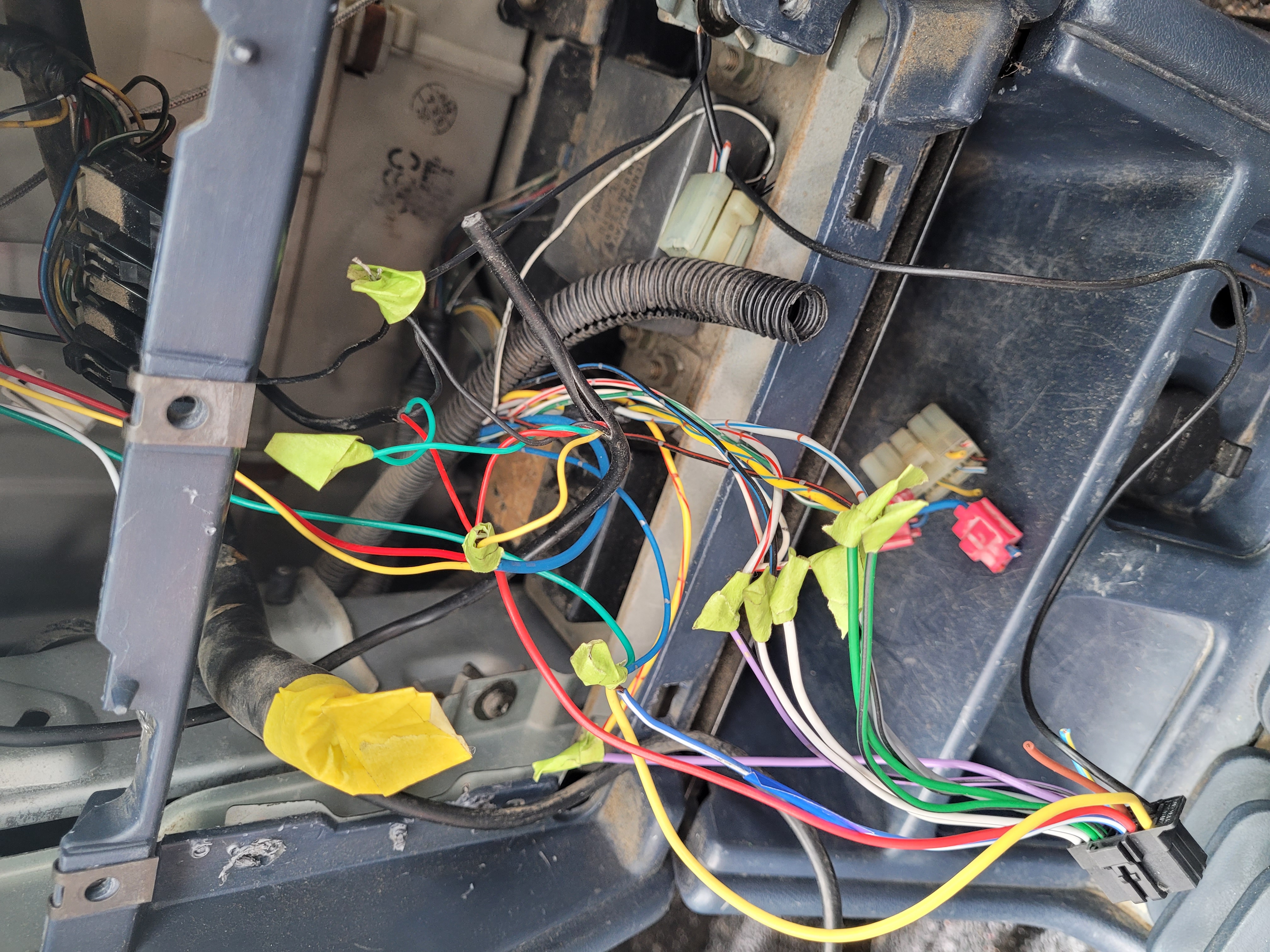

Right, decided to tackle the wiring!! What a bloody birds nest! So annoying when people just twist the wires together and slap a bit of masking tape over it
I've pulled almost all of the dash out to trace all the wiring. Since it had a 4D56T transplant, I needed to find some of the dodgy wiring and correct it. Looks like I need a new water temp gauge as the sensor wire goes no where.
There are two senders / sensors and from what I can work out, the one in the upper radiator hose housing is the gauge temp sensor (single pin) and the larger one (2 pins) in the head is for the glow plug temp sensor. (circled in RED)
LoL, that earth strap connection is a crack-up.
Anyway, I'll replace the sender unit to match the new VDO gauge.
Have pulled out all the redundant wiring and ordered some new power distribution/fuse boxes to clean everything up. I've also been through and labelled all wiring that was added with the transplant.
Still more to do, getting there slowly.

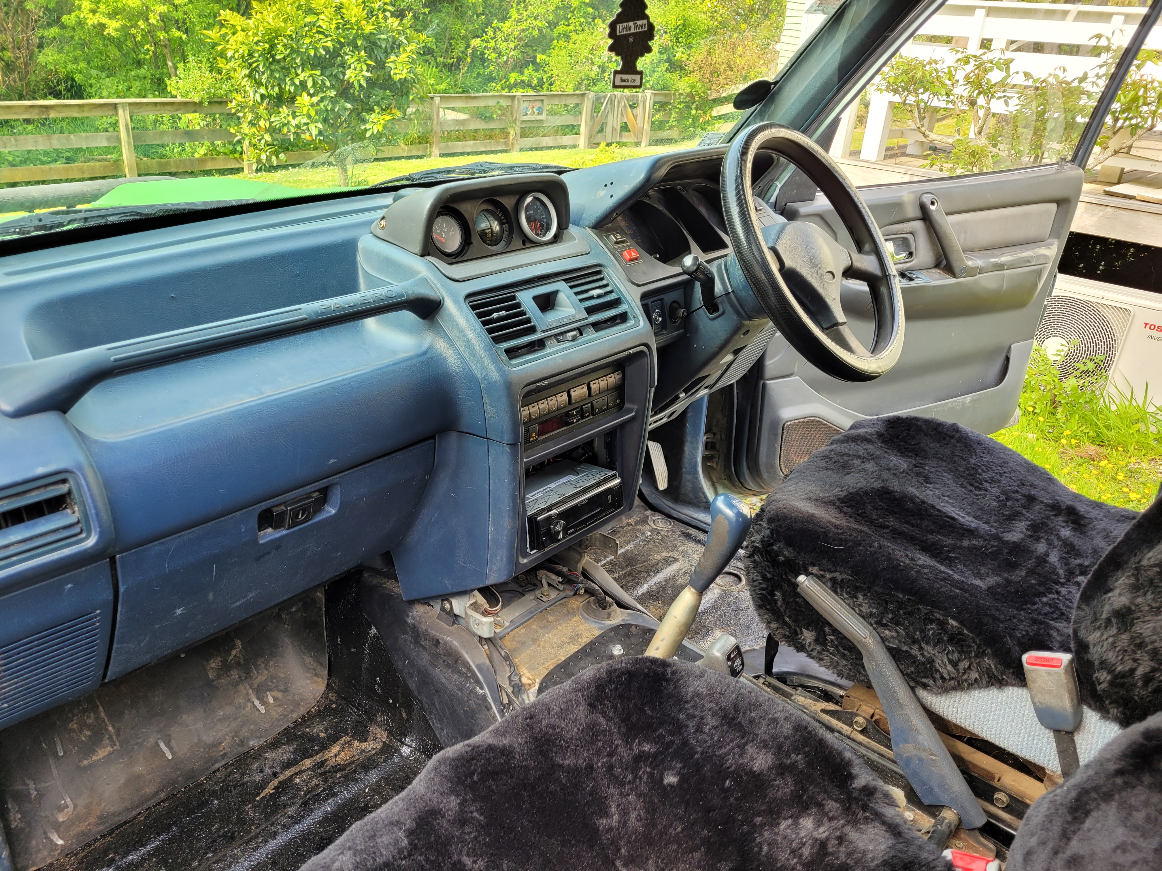

On this week's episode of putting lipstick on a pig.....
Finally got my VDO water temp gauge and matching sender. Had to tap out the old hole as it was gummed up with thread tape.
Have flushed out the radiator and engine.
More wiring... Have redone all the dash wiring and labelled everything. Honestly some people and their bloody wiring skills. Stripped out the back end also to see if there are any more treats. Also soaked the seats in soap and water blasted them. They will do for a while and will just put the sheepskin covers on.

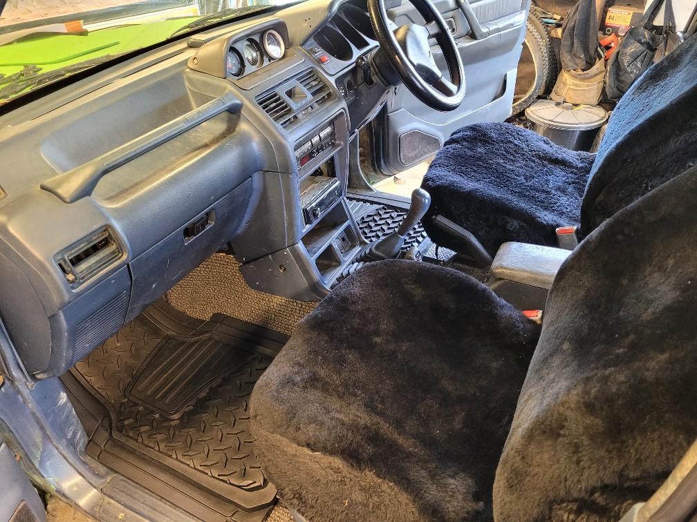

Looks a lot cleaner layout now. And those sheepskin covers, you would think you were driving a rolls. Also made a new gearbox floor moulding out of a rubber car mat. Just glued and screwed. That's all for now folks....

Only place I could find suitable was in the turbo dump pipe. Will give me an indication of Temps.
Anyway, as you can imagine it's a right shit to get at. The nuts were seized more than my back. Applied plenty of penetration lube and soaked for a while and bingo.
Removed the dump pipe and tapped the probe in.
Took it for a fang around the neighborhood with just the dump pipe.
Neighbors love that sort of thing on a quiet Sunday afternoon. Reading reasonable EGTs now, so can tickle it up a bit.

I have been told from the previous owner that the injectors need rebuilding. Not really sure how you can tell though. And how reliable that info is, is questionable.
Getting about 400-500 post turbo. With a max hitting 600. Like everything in this truck though, it's been molested so not sure how accurate the chicity China gauge is. Might just get another VDO gauge since I can get them super cheap.

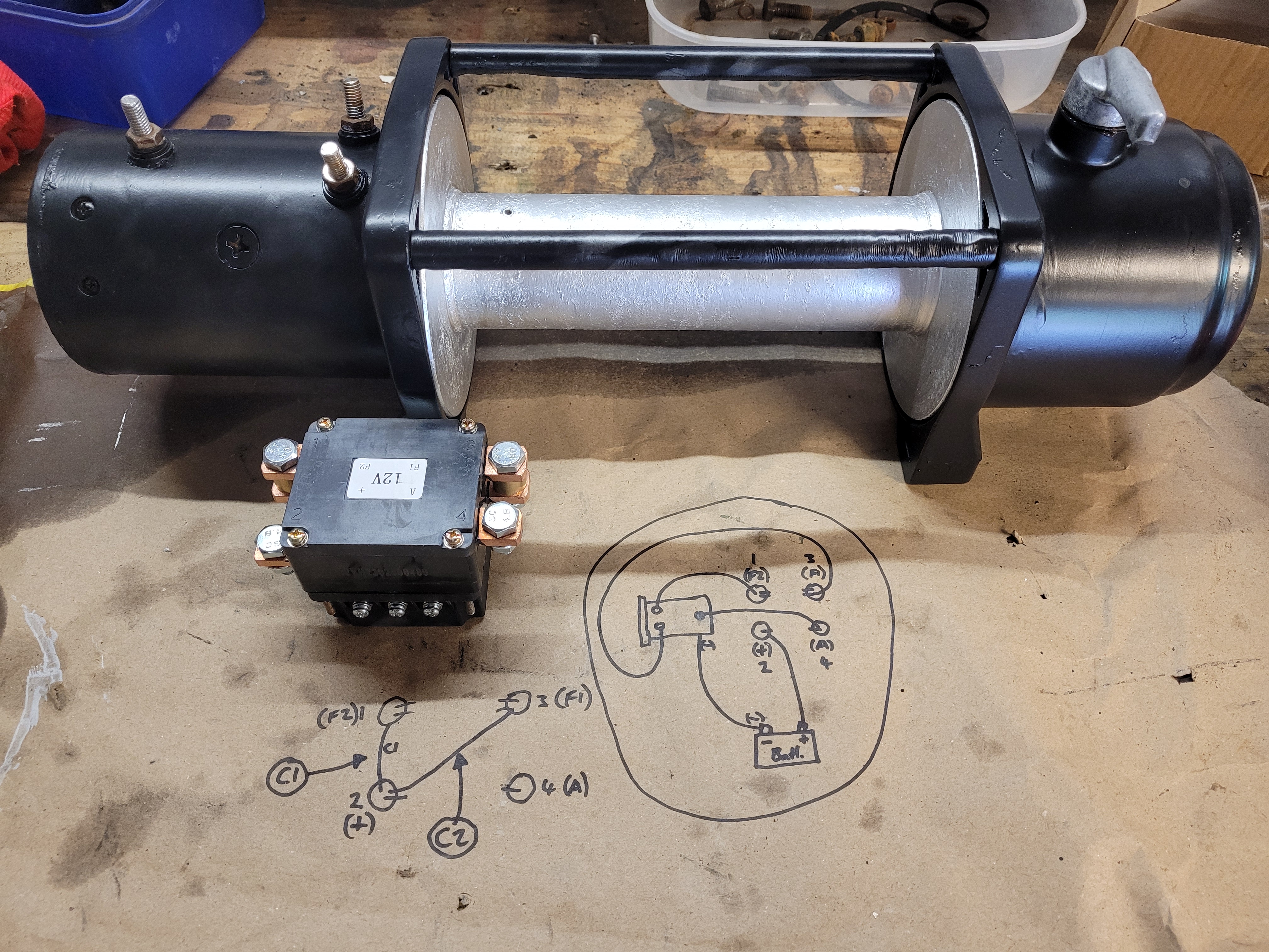

Thought I would rebuild it and oh my what a treat! Gearbox was as sloppy as the village girl and solenoid has been swimming for a while. Motor seems all good though. Fairly clean and plenty of life in the brushes. This will save me some dollars.
Turns out to be a Novawinch as well, so not too cheap and nasty.
Stripped down, new grease, clean motor, new seals and a fresh coat of paint. Will test at a later stage to see if the solenoid is stuffed.
Will look at getting some new rope also.

Ahhhh, much improved. Tested and runs sweet.
Brand new solenoid and wiring diagram for the Novawinch

Well just before the Xmas shutdown I managed to secure a custom made (6mm) winch plate, 32mm NB medium wall pipe and some welded elbows so I can build the barwork over the break.
Best prices for the pipe was from United Steel in Seaview.
Have just tacked together the middle section today and will finish the rest tomorrow. Will then weld it all up and paint.

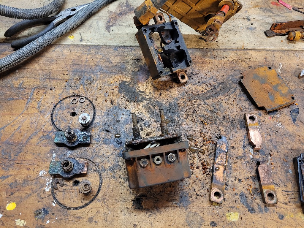

Well, my brand new dyneema arrived and thought I would wind it on, only to find the winch didn't work.
It bench tested fine after the rebuild, but no power. Jumped the winch to test the motor itself and confirmed it was a no go.
Pulled it out and stripped down the motor to find the problem. Under a bit of load, the solder heats up and as the connection had bugger all solder, it just popped off. Will re-solder all the connections properly.
Added some in cab controls for the winch also.

Well finally finished the front and rear barwork.
Whilst at it, I cleaned up the chassis area, red oxide primed and a fresh coat of black.
Will work on the sill protection a bit later.

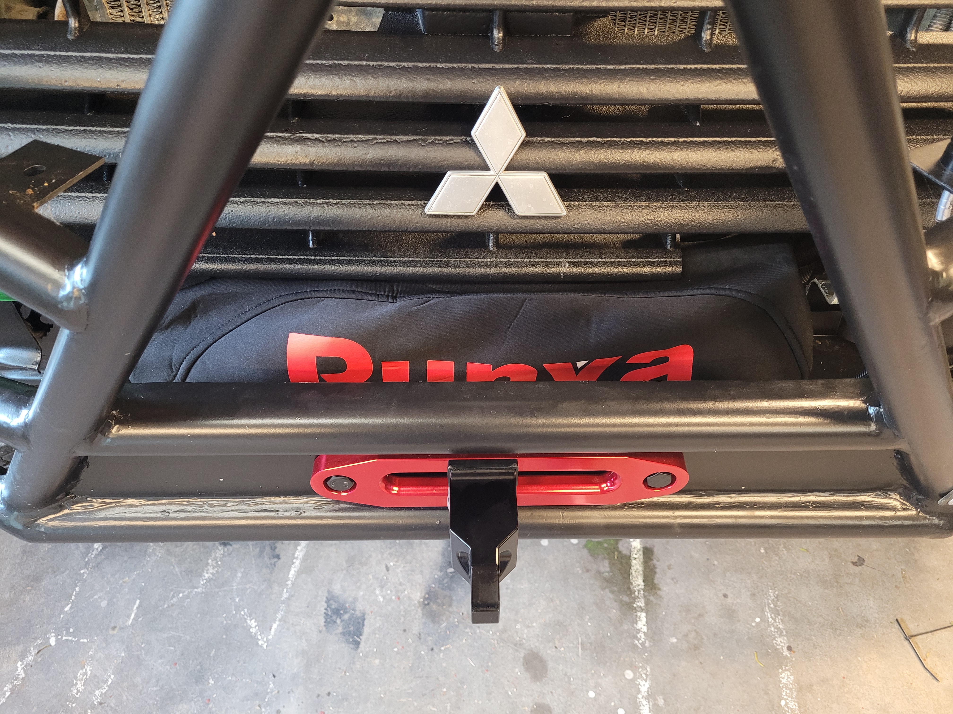

F'ing winch. Couldn't get it sorted and started playing up again. A mate was going to attempt a resolder, but what else will go wrong. Wasn't overly happy with the gearbox either. OCD mode
Obviously another used and abused item.
Sooooo, happy birthday / Merry Christmas, Ash at AFN 4x4 sorted me out. Was looking at the Novawinch he has, but the dimensions are quite a bit bigger. Went for the Runva 11XP in the end
https://www.afn4x4accessories.co.nz/winches
I remember buying Runva when they first came out on the market in NZ. Gees how time has changed them. Very well presented winch these days. Comes with all sorts of goodies.
Anyway she's in and happy now.
Sprayed some soft seal on all the electrical connections then a coating of lanolin for extra weather protection.

For this weekends adventure, I thought I would put some nice new carpet in. The noisey sealed floorpan was getting to me and I like to roll in a bit of style and comfort.
SO, I had some nice leftover carpet. At $500/lm she's the best on the market. But you need to treat it.
Firstly cut it all out and into shape. Fit to vehicle with all the mounting points. Remove and coat the entire backing with aqualine PVA glue and then place a layer of high GSM paper across the back. Refit to vehicle. Bolt everything down and let it set.
What will happen is that the carpet will hold its mounded form. Be really strong and backing cannot seperate or rot out.
Put in some nice new mats and you would think the queen was coming for a spin up Odlins Rd

Been a fair while since I last did an update. Since then I've:
- Got the EGT and Boost gauges working
- Tuned up the injector and boost to give it more power
- Got a WoF
- Installed a brand new UHF radio
- Made up the sill barwork
But most importantly taken it for a spin into Rallywoods to test it out. Performed very well I must say.
- Got a WoF

So the body restoration begins, here is the bones and the bad bits. Only rust I've found is one spot in the boot and passenger door window frame.
Stripped it all back and gave the entire thing a good scrub.
