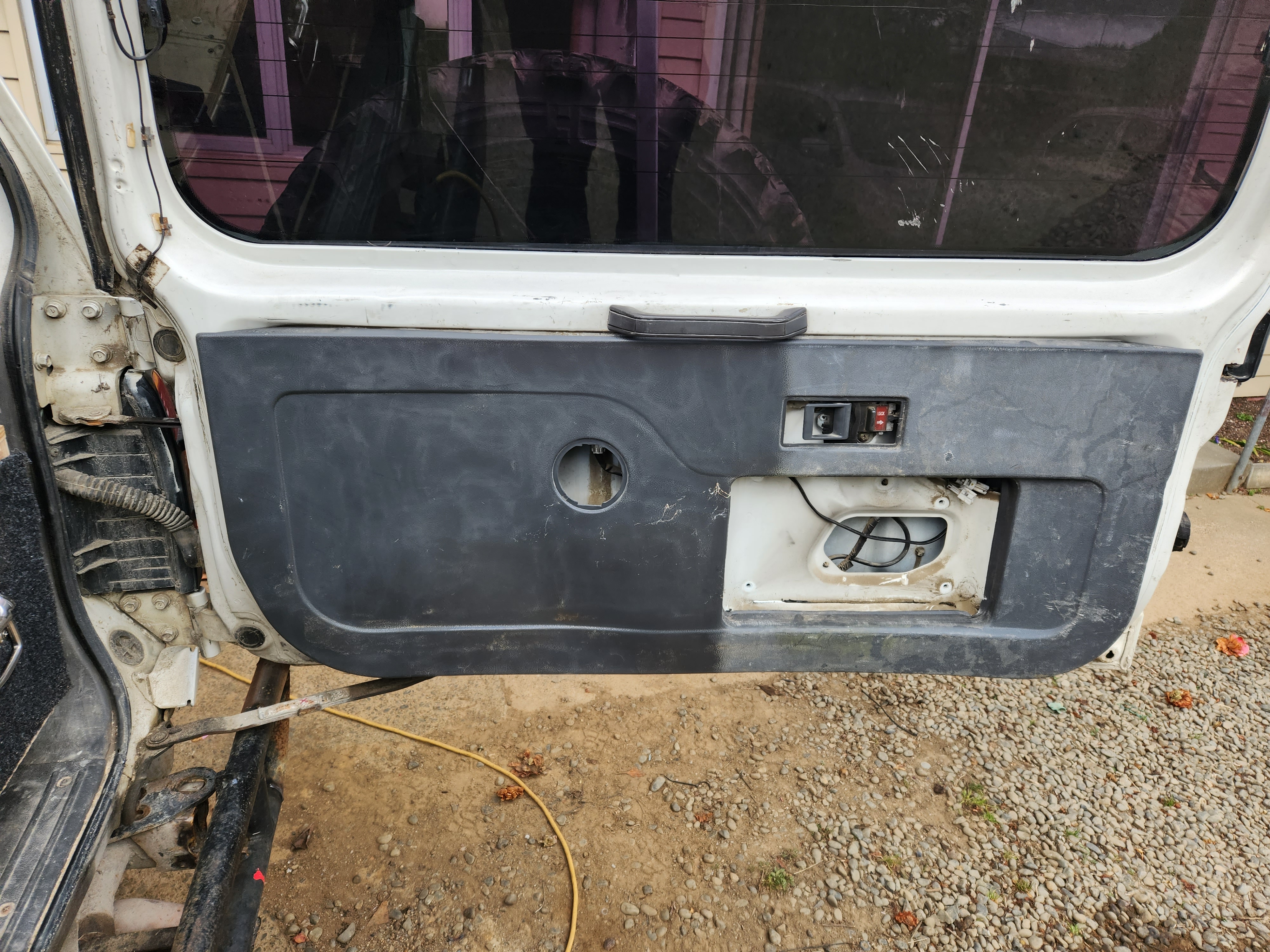

Daily up date for the day
Ran wiring and fitted the reverse light / worlk light to the tail gate tonight
While the door panel was off I decided to fit the slightly nicer plastic trim vs vinyl and card one from factory
Ended up being a bit worse for wear so decided I'll try the heat gun trick from my motorbike days and try revive the plastics
Turned out ok not a 100% prefect but about 90% better than before
Will make some templates for the rear bar mounts and then I can finalize the left side rear corner for being level and inline with the body lines and then triple check my bars are parallel with each other etc
Hope to get bull bar started over the weekend at least the center
Here's a few pics

Last night I started on the rock sliders mainly to be able to fabricate some scrub bars to cover the tyres as the beadlocks have a bit of offset
Still waiting for the snorkle to come back and the pod filter to arrive
Once I do the sliders I will get into replacing the injectors and tickleup the injector pump a bit I have a aggressive boost pin to fit to the compensator as well
