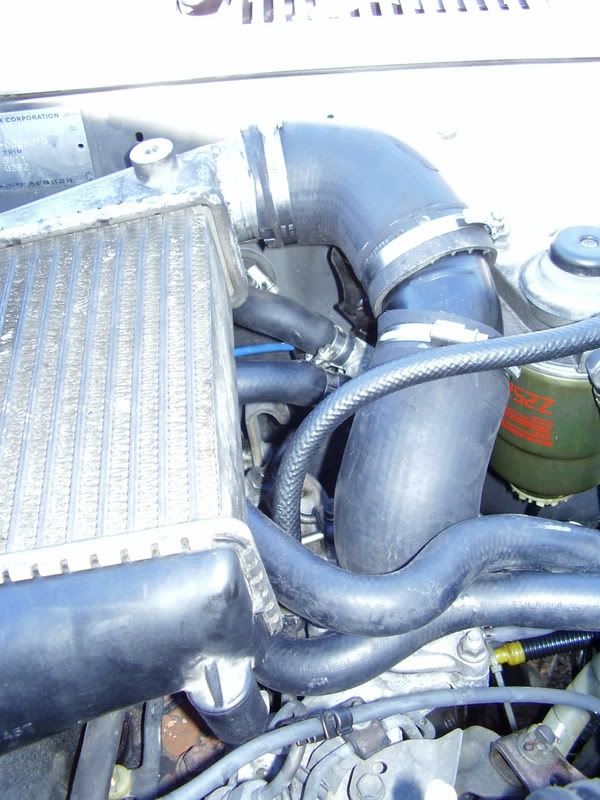

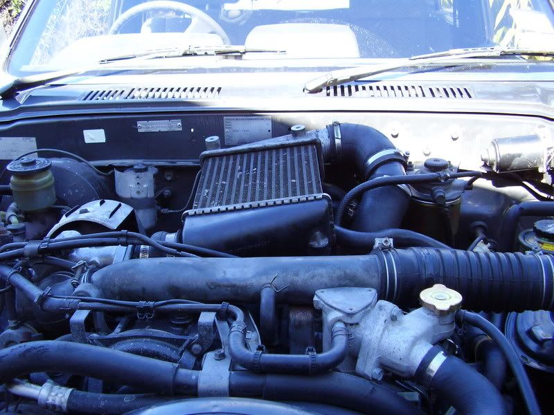

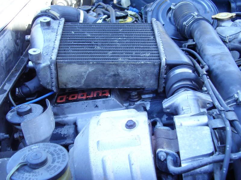

Well I finally got round to interccoling the surf. Used a couple of skyline intercoolers that i picked up off trade me with all the piping for $25!
Took me an hour and a half in total.
Even managed to get it up off the rocker cover a bit. I have some heat sheilding to put under there at some stage, but couldn't be bothered today.
I had to shift the heater tap down the firewall a bit, but that was no prob. It's only cable tied in place at the moment
Had to squash the heater hoses underneath, but it still all works!

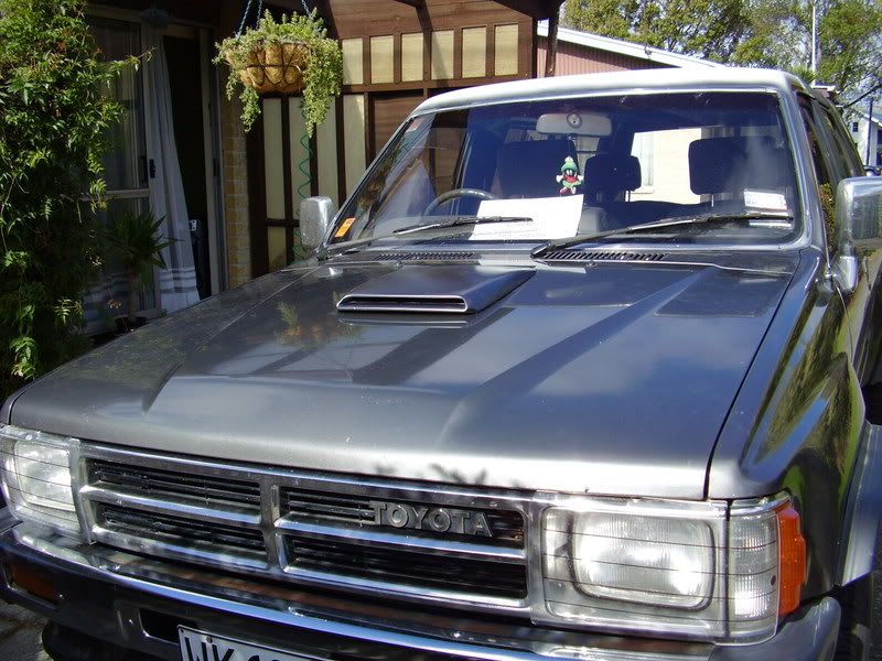

UPDATE - Bonnet scoop on now.
Makes a BIG difference once moving above about 30k's. The whole demeanor of the truck on boost is different - smoother, not so ragged/gruff on boost, quieter(!). I'm amazed at the difference.
Went for a drive to Diamond Harbour to test it out - not so much chopping thru the gears, could hold 4th on hills a bit longer (another 100m or so!) and when i got there I popped the bonnet and felt the end tanks on the IC to see the temp drop, prob about 20-30 deg, so its obviously working.
All in all, well worth the $45 it cost me(including scoop)
