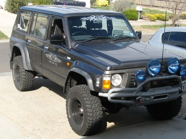

I have a Nissan Patrol GQ with a 4.2 modified diesel, with my own custom built stainless steel extractor manifold, Garrett rollerbearing turbo and intercooler, adjustable external wastegate, ceramic button clutch, modified cooling system.
I have a set of fox shocks and bump stops and Koni shocks(in the garage waiting to be fitted), a modified and strengthened front diff housing and custom front bar.

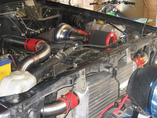

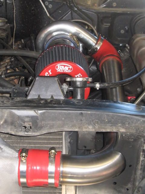

Just finished the intercooler piping etc...

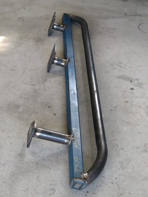

Starting on my sliders..

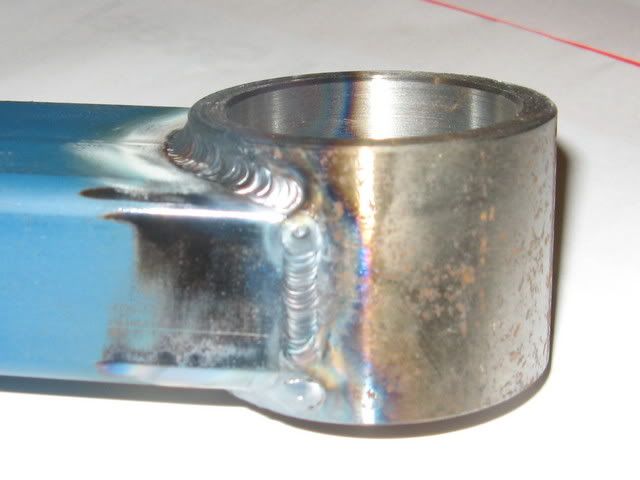

My custom H/D trailing arms.

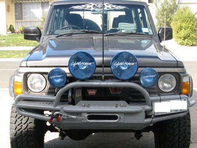

My twin winch adapter setup

thats cool 8)
UBZ
Posts: 1650
Joined: Sat Aug 19, 2006 12:00 am
Location: Twizel
Post by UBZ »
Nice Bar work :twisted: :twisted:

Nice welds! :shock:
now if only mine looked that good (welds that is), but I guess I will take the function of mine over the beauty. It would be nice if one day I could get both like yours.

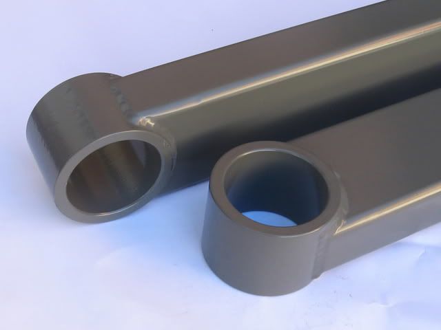

My trailing arms completed... bushes getting put in soon.

Warren,
Did you do the rear trailing arms on Hoon's truck? Looking at it at OBC 2006, they look pretty similar?
Mine are 50x25 RHS which are plenty strong enough, but those ones of yours and Hoons seem to be bigger section again?

Yes I did make Hoon's trailing arms, also, yes they are a larger section material and I'm making the eyes larger than standard aswell, but still fit original nissan bushes.

The_Wazza wrote:Yes I did make Hoon's trailing arms, also, yes they are a larger section material and I'm making the eyes larger than standard aswell, but still fit original nissan bushes.
Geez, not likely to bend or break in any hurry then...you reckon they're "Hoon-proof"?
Are you going to put some fancy synthetic winch rope on that truck of yours? Looks like wire in the pics?
Actually, these are a little bit better than the ones I made for Hoon. Hoon has the standard bush eyelets.
I'll be putting on Amsteel Blue rope one day soon. Yes it is wire for now.
Wazza
Is this because of the way the eyelets tear out? I've seen Sandy B put a bodgy looking strap from the arm, around the eye and back to the other side of the arm...but haven't seen anyone over here experience the same problem.

I make the eyelets thicker for strength. No need to add straps etc, if you make them correctly.

The_Wazza wrote:I make the eyelets thicker for strength. No need to add straps etc, if you make them correctly.
Ok, so I take it you've machined them done from thicker sectioned material?

Yes, it is from thicker sectioned material for the trailing arms.
