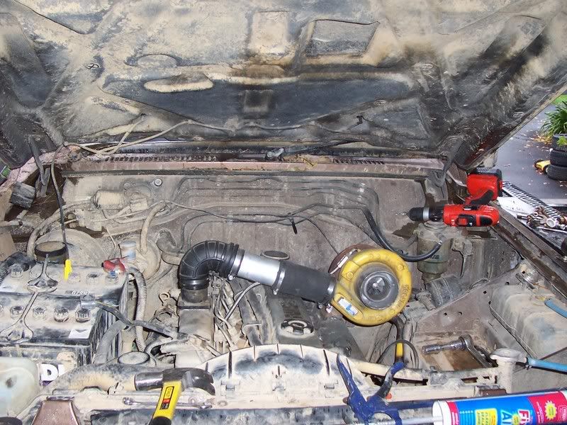

Turbo manifold made,oil feed hose/drain pipe fabricated and connected,air cleaner repositioned,dump pipe flange made but not welded yate.
Just need to sort exhast and intake/snorkel pipes now,hope to have it going next weekend.

worzel wrote:Looks good so far
keep up with progress
is it expensive to do
my mate got got a safari so will keep watching
he would love to turbo his
Kev
Probably a bit late now but there is an oil feed you can take from the left hand side. It is located by the left hand engine mount it is a small plug in the block and is removed with a small allan key.

Good work there Shanemight be able to clear some mud out of those tyres now.
Yes be nice to have some extra power thats for sure,I wont to get it going for next weekend our club is going to the farm were they had that winch comp last weekend.be great to try some of the easyer tracks(try note to roll the thing hippos like to roll round in the mud )
