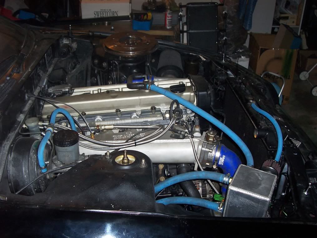

one step better is what i run on my rb30det a recirculating catch can with a sump breather
you can see it behind the drivers head light
