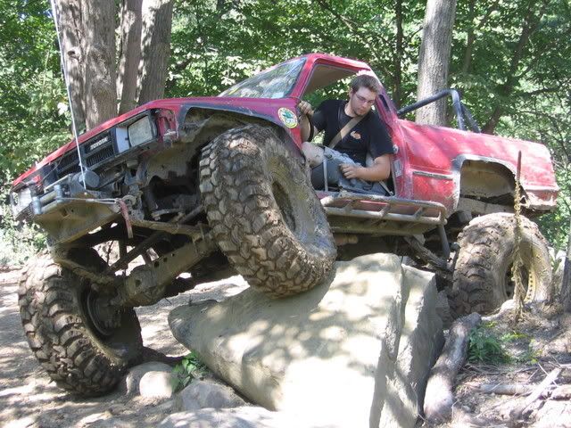

SupraLux
Complete Bastard
Posts: 2415
Post by SupraLux »
Ah, crazy-ass tech from the good old days :) This is what we need... :)
Anyone recognise that truck?
Steve
muddy_munke
Posts: 214
Post by muddy_munke »
Cheers for that. Could be interested in some soon..
Look forward to pictures...
muddy_munke
Posts: 214
Do I win something cool when I say who's truck it is??? 8)
Connan's by any chance? :D

SupraLux wrote:Anyone recognise that truck?
oo oo oo I know!!! me me me !!!
Who knew Prados could fly?
