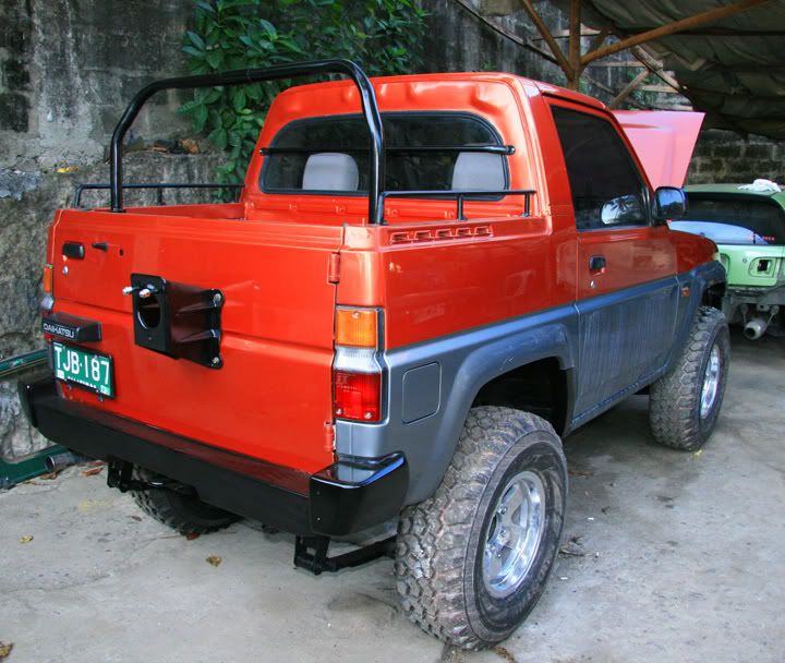

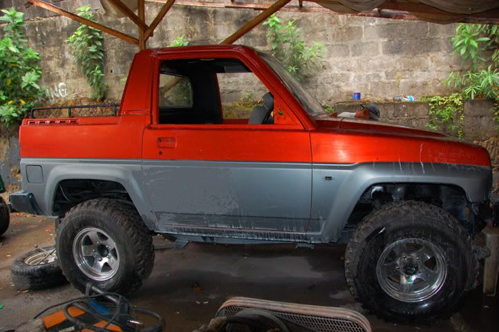

I run 32" MT on my Feroza with no problem. I did a 2.5" body lift and a 1.5" suspension lift. This way I don't have to
crank my torsion bars alot. For the rear, I replaced the shackles with an extended one. I also place a spacer between the upper A arm to minimize camber problems. And I converted

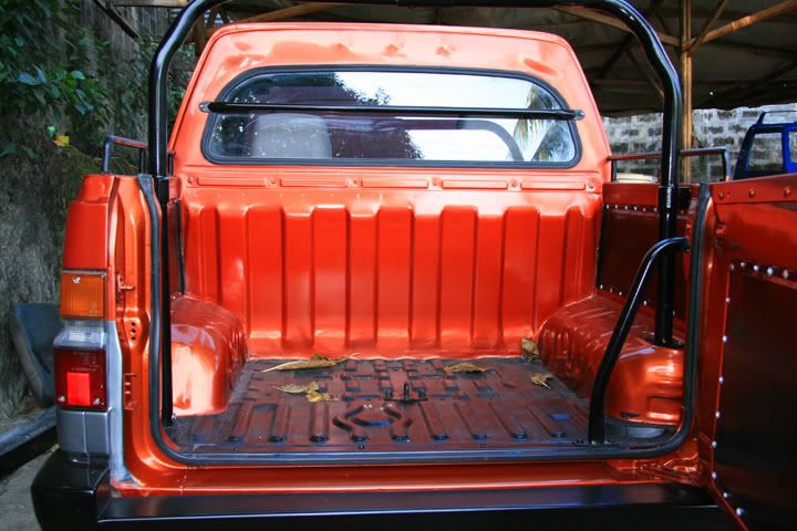

it into a full time mini pickup. Here are some pictures of the pickup as taken 3 weeks ago while still undergoing a repainting job. I will post the latest one when I have the time to take new pictures.

now i like that.
how do you find the power drain with the 32''s and what vehicle did you take the back out of to seal the cab kind of thinking of doing something like that to mine.
and did you space the front diff down at all?
what part of the country do you hail from?

The power is still okay although I noticed that fuel consumption has gone up. The Feroza use to consume
8 kms/liter city driving, now it is down 6kms/liter.
I used the divider from the starex pro van. Here in the Philippines they sell vans without windows at the back specifically
for business delivery. Some owners convert these vans for passenger use and remove the divider between the front and the
back. This is what I used.
I do not understand your question about spacing the front differential down.
