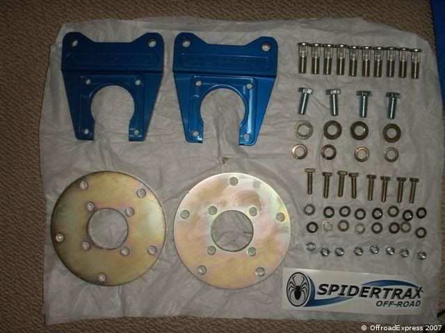

I have just bought a Spidertrax conversion set in from Rocky Road Outfitters in the US. I will try a put a pic up of them with main dimensions for you if that is of help?

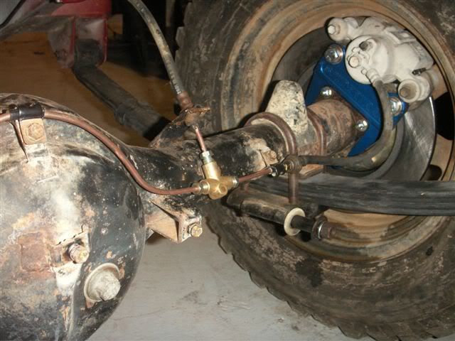

Unsure of the axle flange mount . You can use either 413 callipers/discs or vitara calliper/discs, not mix between the two. On LilPig Ive used vitara callipers and discs. On the new toy Ive used 413 front callipers and discs. Both have been with the spidertrax kit, but they dont advertise this as a samurai/413 AND vitara/sidekick kit. brakelines are the same between the two, just "flexed" the flexi hose too meet the brake pipe on both

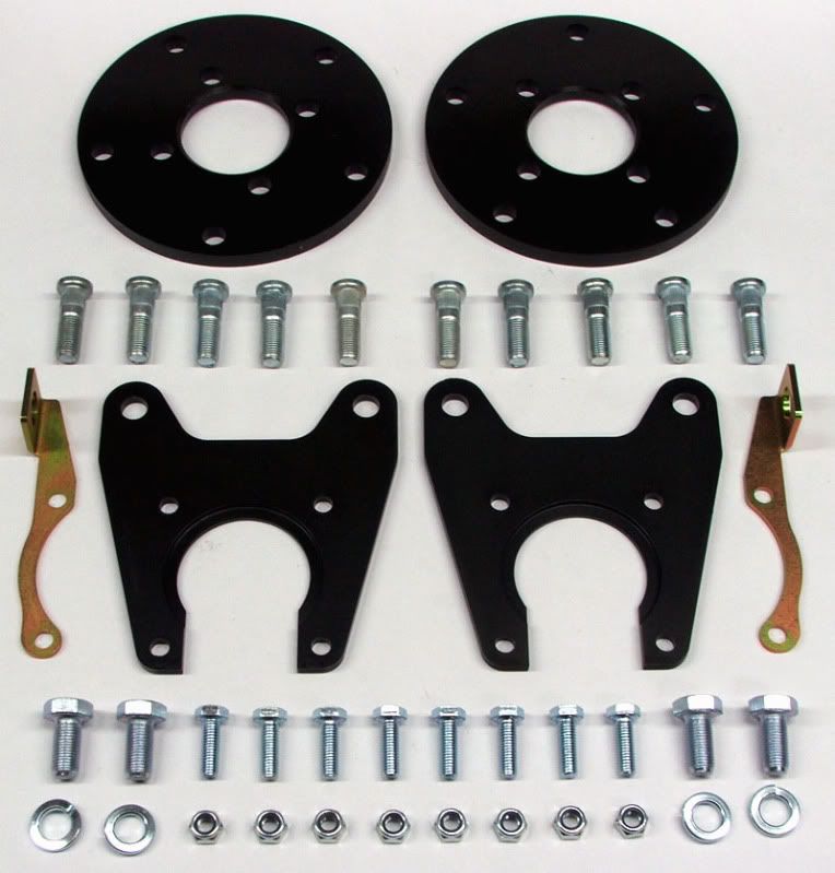

I make a kit to run stock front calipers on the rear, and another kit to run Mitsi Galant calipers with built in handbrake:
Ben

That's a fine looking bit of machining Ben. Do you sell either kit? I had not thought about the handbrake - the centre one seems fine but would be interested in the built-in handbrake. Thanks - Tony.

Hi Tony. Yes, I do sell the kits. I've sent you a PM.
