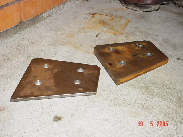

Hey, I'll see if i can find the spacers and send em down, if they no good, copy the shape to make 10mm ones.
These are the spacers (thats the 20mm next to the 10mm)
Tge 20mm mounted
And the 10mm for comparison
There may be a slim chance if you grovel enough i might be able to twist someone's arm copy the 20mm one's i have and make ya 2X 10mm plates

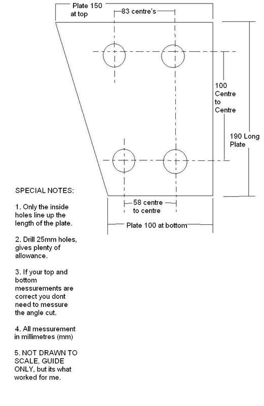

hey, does anyone have a simple drawing and dimensions for the spacers?? then i can mill some out at work, just need the drawing?? what are the hole's centre to centre??

Alright, got my "A into G" and found my notes I made at work for the plates.
I used 12mm plate and it cured my vibrations. Here I Microsoft Paint 'ed a quick guide for future reference.
** PLEASE NOTE I MISSED A MEASUREMENT OFF MY DRAWING, I WOULD MAKE THE RIGHT HAND SIDE CENTRE LINE FOR THE HOLES 25mm IN FROM THE RIGHT HAND SIDE OF THE PLATE, MAKING THE EDGE OF THE HOLES THAT ARE DRILLED TO BE ABOUT 12.5mm FROM THE EDGE OF THE PLATE. MAKE THE BOTTOM RIGHT HAND HOLE 40mm UP FROM THE BOTTOM EDGE OF THE PLATE **
You can make both sides the same, just flip plate over for other side of cross member.
So now you have a starting place and the rest of the hole messurements can come off that and simply using the right hand side of the plate as the Datum line and the bottom right hand hole centre. Remember to lay it all out on the plate first before any drilling!!
Best of Luck and I hope this is clear enough!!
