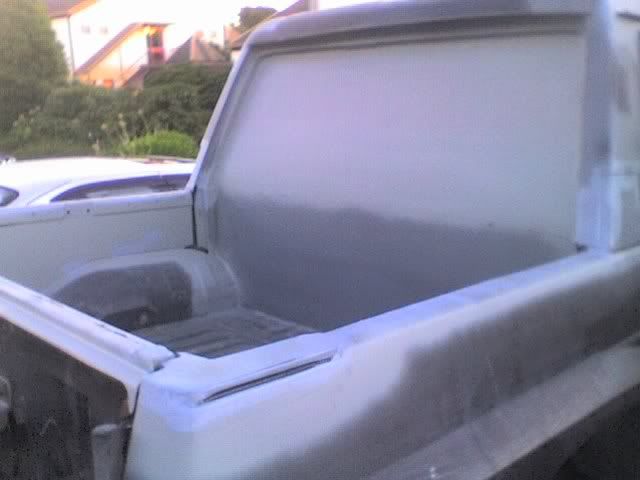

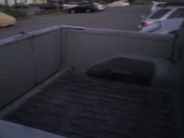

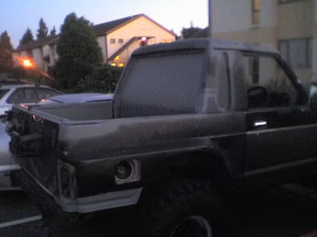

contour
Posts: 115
Joined: Tue Aug 28, 2007 12:00 pm
Location: Roxburgh
Re: wellside ute safari
Post by contour »
Well i have finally got my ute conversion done with a few other mods as well thanks to scott.
just got to put new door and guards on then paint
