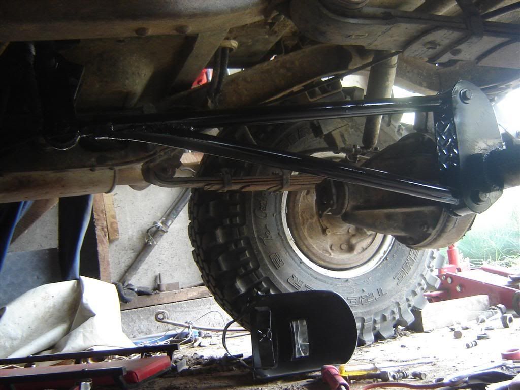

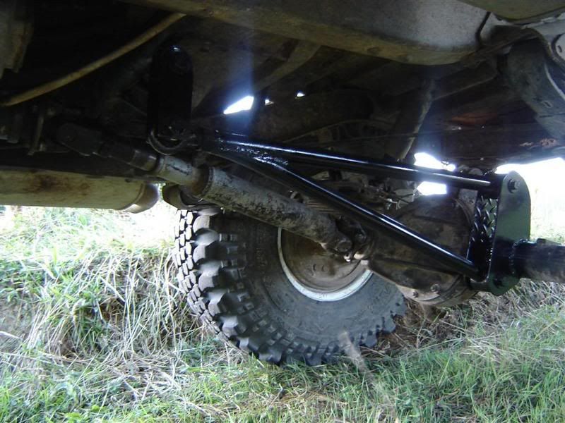

Re: petefj40's new mods
[quote="petefj40"]Hi guys.
-1.Rear diff stabilizer. So i don't shear any more pinions. :oops:
this is the new bar i made to prevent axle wrap(smashing pinions and bending springs) :D dunno how good it is yet as i havent given it a hard time :twisted:

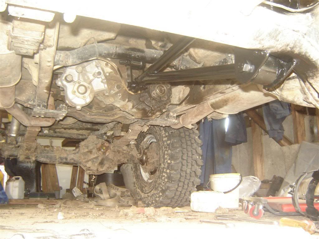

Looks good wopass!! Do you have any other higher res pix of the job?? I'd like to see more if that's cool?
Where mines going to be anchored is on the cross member between the chassis rails. Now the tank is out of the way it should be easy. Can't wait to give it heaps once the job's done. With the 33's on I'm hoping to get the front wheels in the air. As well as smokin them hard out. I'll be youtubing the video. Watch this space. 8)
My twin brother has a farm near Westmelton. He's into his V8's more than I am. :shock: He's planning on building a burnout pad next to the barn this year. I have 14 worn out 18 inch tyres behind my garage just waiting for this pad. :lol: :lol:

First progressive pictures. :D
petefj40 wrote:Looks good wopass!! Do you have any other higher res pix of the job?? I'd like to see more if that's cool?
something like that :wink:
Post by petefj40 »
Cheers wopass! Looks great!
My setup will be very similar, only, it'll be shackled at the cross member not welded.
Awesome! 8)
petefj40 wrote:
Awesome! 8)
it is shackled at the cross member only the top bush tube is welded to the cross tube for the fixed point, then has a shackle to enable forward and rearward movement of the springs and has a srewed rod and eye which is floating to enable the rear axle to flex without any binding at all. dont know if its going to work yet or not...should do but will only find out when i give it a hard time at the next rally :twisted: ...if it breaks....ill just make it even bigger and stronger :wink:
as my 40 has 36" wheels and does a bit more hard work :P the rear axle probably see's a lot more applied tourque than yours :lol: so i would imagine that your builder will have something cool in mind,having said that, you should show him the pix of mine to give him some cool ideas :wink:
