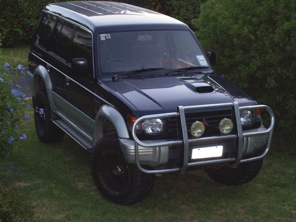

Get a NZ new LWB Paj. These came with a factory fitted rear diff lock which will over come some of the short falls in having an IFS front. I have fitted Nissan LWB patrol rear springs which has lifted it 4", wound up the torsion bars, flipped the ball joints, trimed the bump stops and fitted 33" mud tyres. It goes really well on road with more than enough power to turn the tyres. I have towed my LWB patrol winch truck on a heavy transporter trailer with this truck, It handled it OK. Off road it is surprisingly capible.
I have not owned a 3.0l surf so can not comment on those, but the diff lock should be a point for you to consider.
Here is how it looks with the lift
