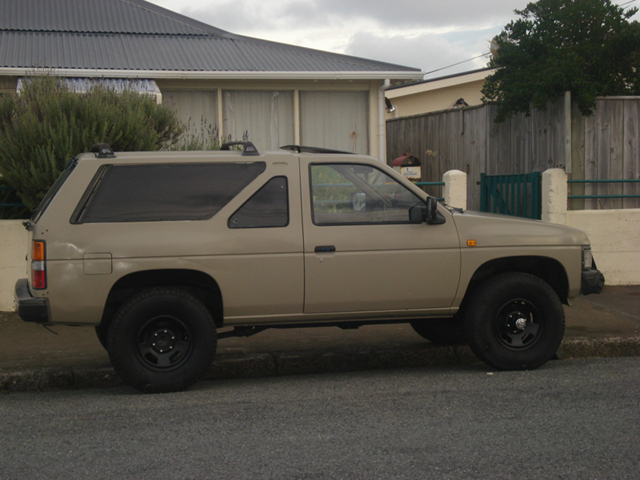

Hi Crooza just wanted to say I think your paint job looks really good. I like it how you used acrylic lacquer instead a modern 2-pack.I painted my vehicle with the exact same Dupont Lucite Acrylic Lacquer.
I chose Toyota Dune Beige #416. Ironically my vehicle is a Nissan but I couldn't care less about brand racism etc
Anyway I have painted several vehicles with this stuff. Couple of tips I learned to achieving factory like finish:
1 - the number of coats will determine the tone
2 - a week or so after painting,carefully colour sand the entire vehicle using superfine graduating wet/dry grades - 2000, 3000. This will remove high spots, imperfections etc and blend everything together
3 - after colour sanding cut/polish the entire vehicle with aggressive compound
4 - after cutting, hand wax using some carnauba marine wax designed for gelcoats
5 - wax every month
If you damage it on the trail, no dramas, prep the area, spray 10 coats, blend, polish, wax!
