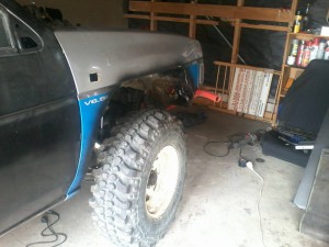

Been keeping myself busy tinkering away at the truck trying to get it ready for the 28th Feb for the NZO & Scarles meet & greet. Decided I would do a guard cut to get a little more clearance for my 33"s. I took about 2 inches from the front gaurd & will be looking at cutting the whole bottom off the rear quarters off too. I decided to do this because i'm not going to be doing a body lift as i'm not too interested in having a gap between my bars and body of the truck as they were built for the standard body height.
#budgetmodifications, #cheapbodylift :lol:
I'm slowly piecing the interior back together, well what's left of it anyways!

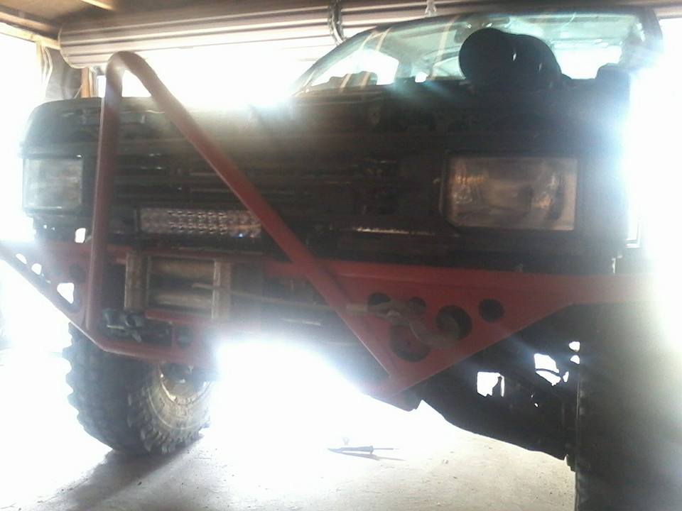

Light bar is now mounted & completely functional!
Sorry about the shitty photos.. The lighting isn't very good & neither is my phone :lol:

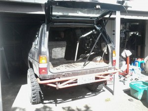

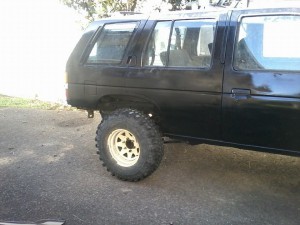

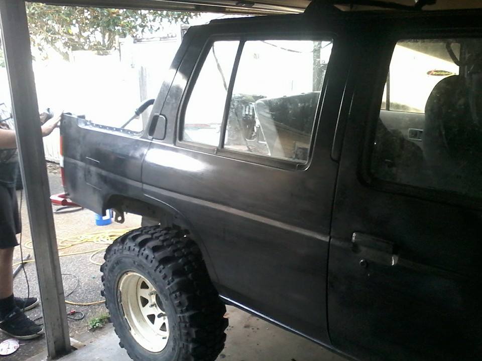

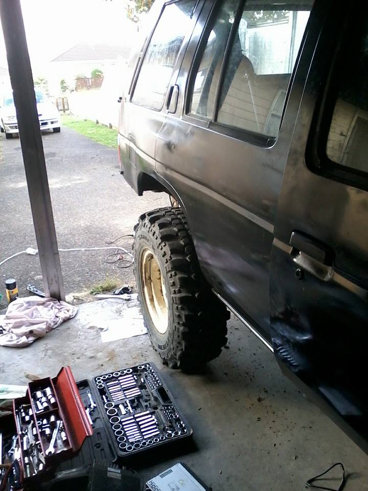

Have some photo's of the rear quarter cut that I've done! I was a little bit hesitant as to how it would turn out but I'm really happy with it! So far I've only done the drivers side as it's getting a bit late & my neighbors hate the noise of me working on the truck :| but fair enough i guess the noise of a grinder is a bit annoying :lol:
Will upload some more photo's once it's complete tomorrow!

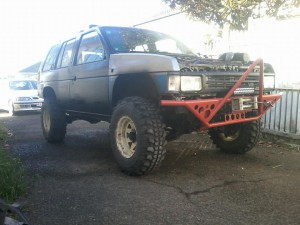

Trucks all ready to go for tomorrow at the NZ Offroader & Scarles meet & greet in rosebank road! Hope to see you guys there!! :D

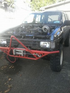

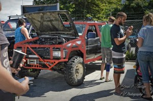

So, I made a last minute decision to take the truck up to Hull Road today in Dairy flat there as it's fairly close to home if anything were to go wrong, which it did...
I was lucky enough to catch it in time before it overheated too much and did any damage but it developed a leak at the thermostat housing and drew in some air into the system. The temperature fluctuated big time which was an obvious hint that something was wrong! I have now figured how to resolve the cooling issues (no it's not put the radiator back in the front where it belongs! :lol: ) I've got a little list of things that i'm going to do, as follows...
- Remove thermostat and repair housing
- Double clamp ALL hoses
- Run not only the water pump on the engine, but a electric water pump back at the radiator in the back there to help the water circulate a bit better
- High pressure radiator cap (currently it is 0.9 i'm looking at going to 1.3)
- Rather than reversing the fans like I have to have the air drawn into the cab, I will have them forcing the air out with a duct facing to the rear of the truck with a shroud over the front of the radiator to create a vacuum effect to assist with drawing the air out
- Cover the exposed connections that are in the back of the cab in case for whatever reason they were to blow-off or disconnect
If there's anything that you guys can think of that will help, i'd really appreciate any assistance with it! :)

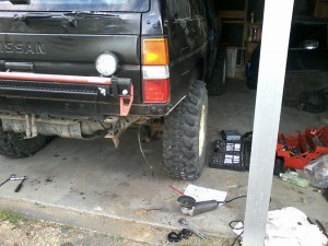

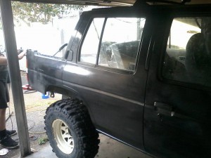

So, it's been a while since I've posted any updates on my truck. I've been working away at it slowly and made some pretty dramatic changes recently! Been thinking about ways to locate the radiator outside the truck but still located at the rear. I decided to roof-chop the rear end and shorten it by roughly 500mm. The chassis & all.
It's still far from done (obviously) but i'm making good progress at the 'stubby' conversion. I started by removing my radiator and mounts aswell as the windows and rear door assembly.
I practiced masking up and cutting the roof off my parts truck to see weither or not i actually wanted to go ahead with it. After that, I masked out my good truck and double checked all my measurements about a million times so that it was all square. Begun cutting the roof off and left the rear section of the truck in tact.
It then looked a little something like this

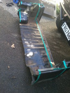

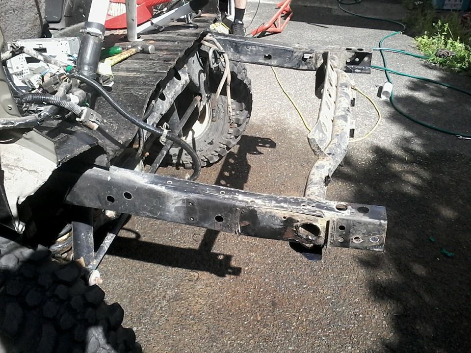

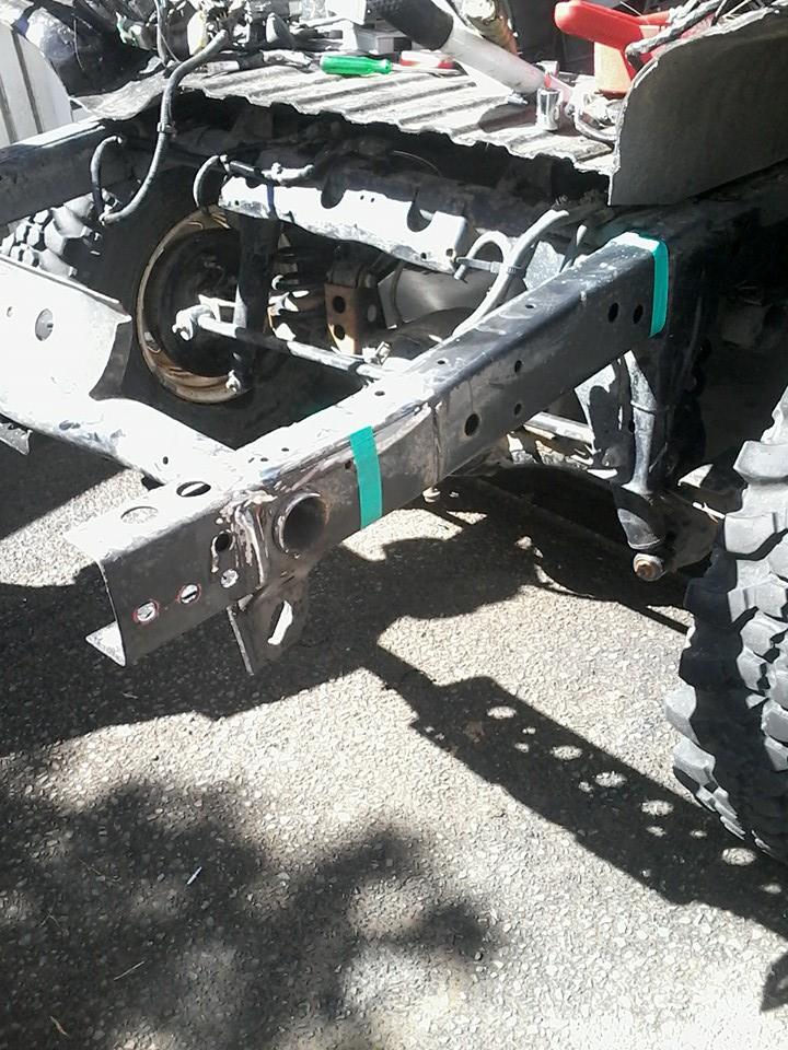

The following day I continued to mask up and measure out the "tray" or rear end of the truck. Removed the fuel tanks & lines and prior to cutting it made sure what fuel cell options were readily available that i could now use. Measured where i could place it in the rear and then re-marked where i would make the final cut to the rear of the body.
Once i had cut the rear section of the body off, i measured up the chassis and started on that..

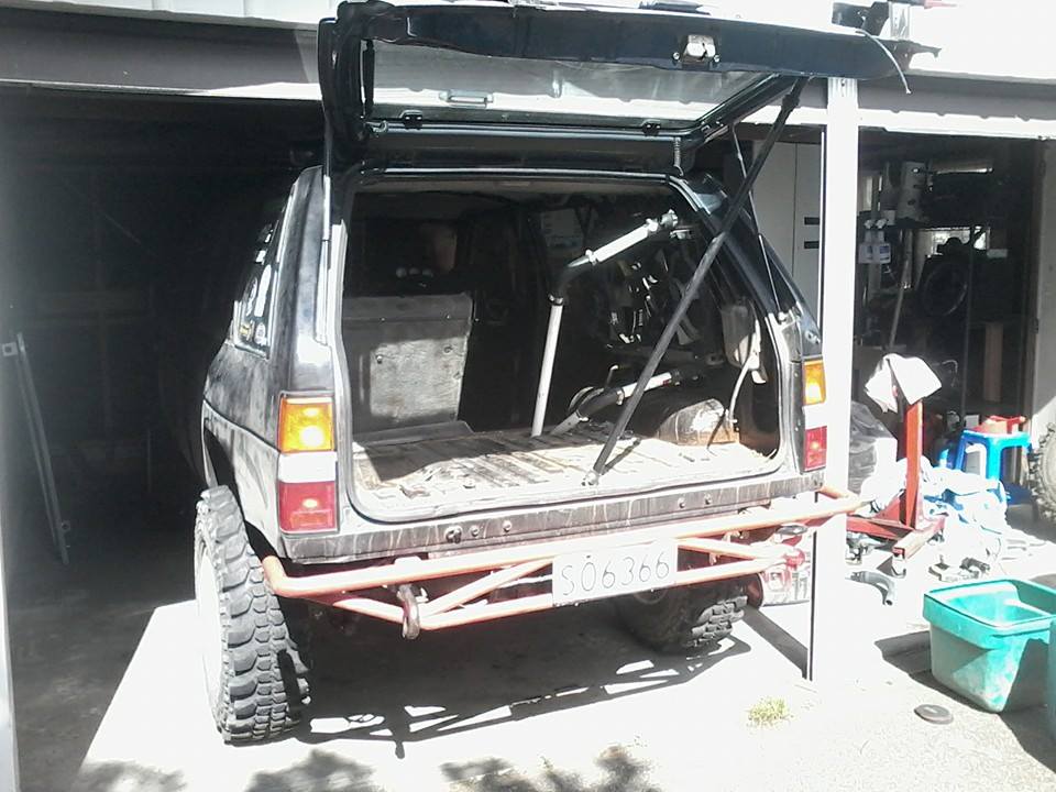

So as it sits at the moment.. The truck looks like this
The cabin will be completely enclosed in the rear when complete. My radiator will then be mounted on the back of the rear panel and the fuel cell bellow it. I'm in the process of making a 6 point internal roll cage before fabricating the rear panel to enclose the cabin. Thinking of doing a full exco cage and some pretty ridiculous bar work in the rear to house my spare wheel aswell. It's coming along fairly quickly and i have alot of ideas floating around. I'll post up some photos which are rough ideas of what I'd like to do in the way of a exco-cage

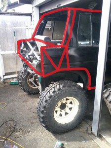

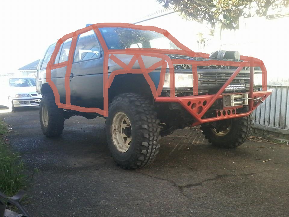

Excuse the shitty drawing's (i'm no artist and it was done on paint) :lol:
These were some rough ideas of an exco-cage. I will no longer be running the front fenders and will just run the bars instead

why not chop it to the C pillar, then build a tray to carry tools and spareaswell...or is that the plan?
some thing like this?
MUDFINDER
Posts: 109
Joined: Sun Nov 02, 2014 4:23 pm
Re: 1994 Pathfinder Build
Post by MUDFINDER »
Crash bandicoot wrote:why not chop it to the C pillar, then build a tray to carry tools and spareaswell...or is that the plan?
That's pretty much the plan but the tray is very very short :)

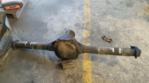

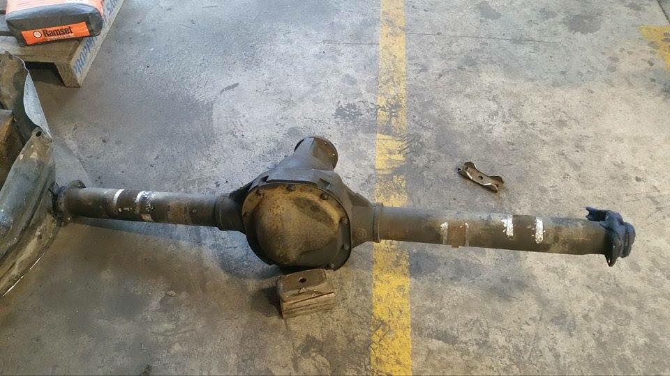

Alright! I haven't picked them up yet, but it's more or less official.. I've got myself a live axle setup sorted :D
Have sussed Jeep cherokee complete front diff with brakes & hubs, suspension coils & arms for a bloody good deal through a friend! So once pay day comes around this Wednesday i'll be off to collect those!

Ok your going to want to truss the shit out of that housing... and dont try to run 35s on it unless you want to throw thousands into upgrading the internals... its weaker than the Nissan R200/C200 diff that's currently in the truck.
Doesn't look like its a split axle vac disconnect which is goood
IMO Better to grab the D44 from that Waggy in the other thread

yep, id be getting the wagoneer axles, six stud too.
