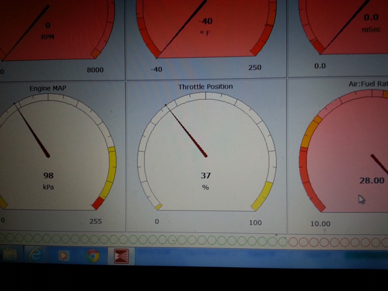

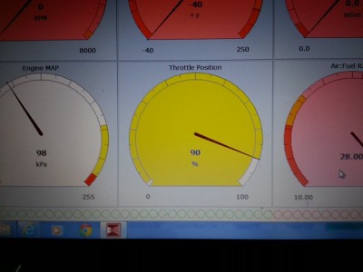

Yeeeeeeeeeeeeeeeyyyyyyyyyyyyyaaaaaaaaaaaahhhhhhhhhhh
Im so fu**en excited i quickly changed gauges to TPS and when i have no throttle it says 100% and when i give it full throttle it says 20%...please tell me this is back to front and is the problem.
Feel like a 15 year old on their first date again..do not want to be going work

Paulballz wrote:Yeeeeeeeeeeeeeeeyyyyyyyyyyyyyaaaaaaaaaaaahhhhhhhhhhh
Most definately is.
Here is how to fix it directly out of the megasquirt manual:
To hook up your throttle position sensor (TPS), disconnect the TPS, and use a digital multi-meter. Switch it to measure resistance. The resistance between two of the connections will stay the same when the throttle is moved. Find those two - one will be the +5 Vref and the other a ground. The third is the sense wire to the MegaSquirt® controller. To figure out which wire is the +5 Vref and which is the ground, connect your meter to one of those two connections and the other to the TPS sense connection.
If you read a high resistance which gets lower as you open the throttle, then disconnected wire is the one which goes to ground, the other one which had the continuous resistance goes to the +5 Vref from the MegaSquirt® EFI Controller, and the remaining wire is the TPS sense wire
Use the "Tools/Calibrate TPS" function in MegaTune to ensure that you have an ADC count value well below 155 at closed throttle, and above 178 at wide open throttle (WOT). This will ensure that you are not in flood clear mode while cranking (ideally, your TPS at closed throttle will be 20 or less), and yet still able to activate flood clear mode. Many TPS are adjustable by loosening the screws and rotating it a bit. Also verify that the ADC count increases as you open the throttle, otherwise you have the TPS wired backwards. You should recheck the TPS range each time you change the idle position or reassemble the throttle linkage.
Good Luck!

Thanks oldyella done as you said and got it sorted now reading correctly..
