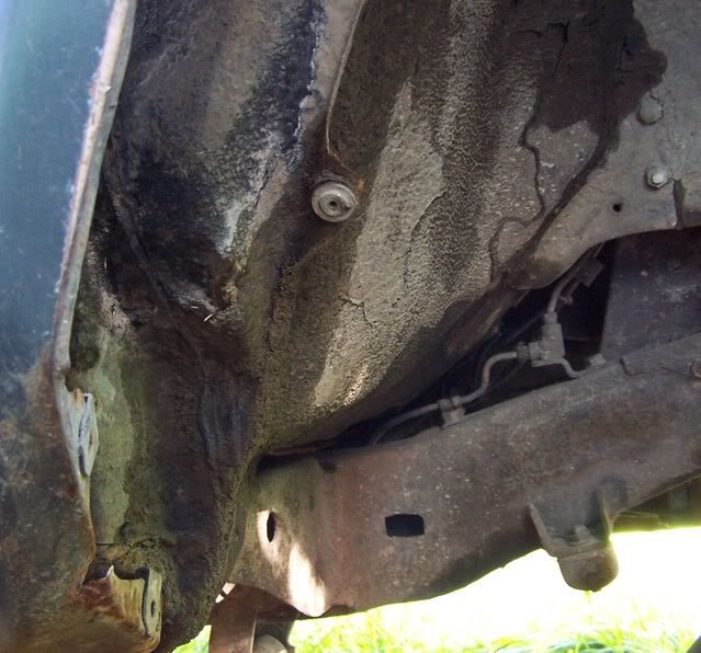

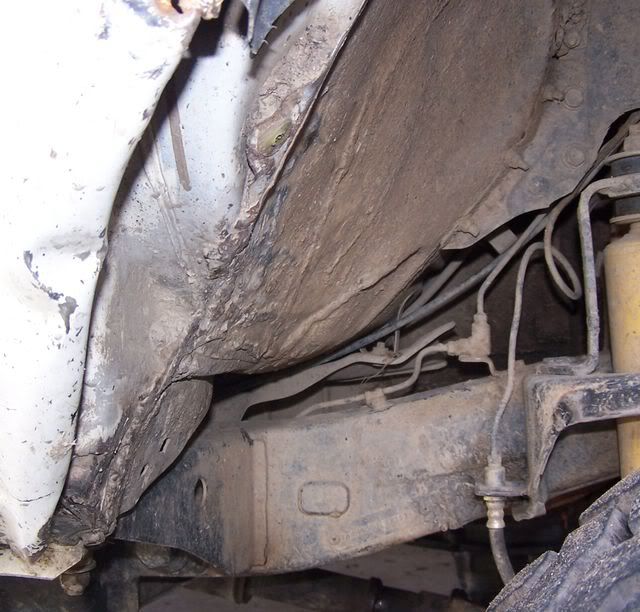

A lot of people with hiluxs move their axles forward to fit bigger wheels which means the suspension and steering are altered.
I simply hacked into the body with an angle grinder and hammered the body in and mig welded it up again. This gained 70mm and enough to run 35x12.5 tyres
Before the hack
After the Hack
Cheer Richard

the main reason I put rears up front was to get a better aproch angle for the rocks as when I have the 37's on my wheels are about 50mm back from the front of my rig.
chopper
looking at that pic did you get your front door fixed :lol: :lol: :lol:

Hi Chopper
Your approach angle must be awesome.To climb rocks you would need it, but an angle like that would be an advantage for any 4 wheel driving.
As well as cutting the body. When I fitted the nissan suspension I moved the axle forward an inch so I think I could run 37s as well in the front. To fit them on the rear I would have to take the angle grinder to the body in front of the rear wheel.
The drivers door was fixed quite easily. Fitzy's brother John who is a panel beater said , just put a socket by the hinge and close the door and it worked a treat. :D :D :D :D
Cheers Richard
