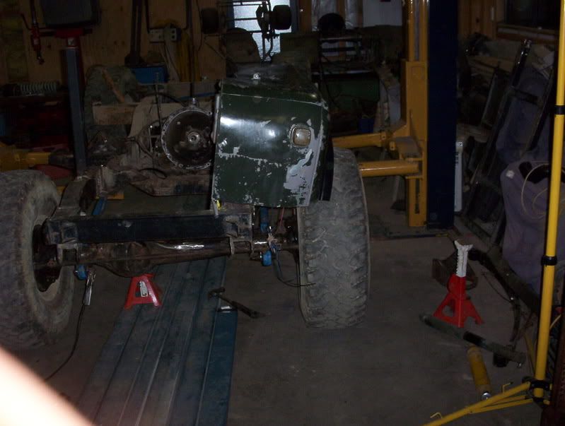

SupraLux wrote:Nice looking HUUUGE axle, btw... nice and wide... what does it measure hub to hub?
Steve
Outside of wheel to outside of wheel is 1710mm/67"
turoa
Pyro Junior
Posts: 3112
Post by turoa »
I know its been awhile, but heres a crap pic of the width with the guard in the approximate place. There wasnt very good light and all the other pics I took were'nt very good and this was the best one.

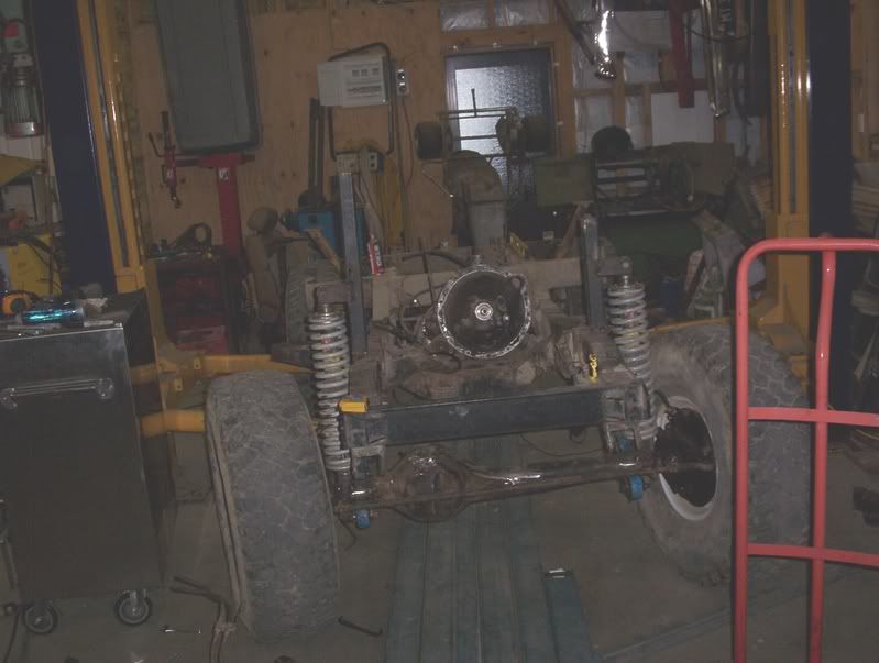

little update. I got the chassis rolling today.
And for the people who look really closely, those are NOT the shock towers I am going to use. They are there so I can alter the height once all the weight is on it. Then once its right, a shock hoop will be made.
And that is NOT the way the coil over will be mounted. The top is on the wrong way so we can mount it easily. It will be mounted properly when the hoops are made 8)
niblik
Posts: 3307
Post by niblik »
are they going to be sitting that close to the chassis rails 2s? if so, a point to think about is when they articulate downwards and the other side goes up, the shock/spring unit will move slightly towards the chassis rail? wouldnt it? i dont know by how much though and i'm sure you've nutted all that out though.. :D
nice work fella..
keep us posted on the rest of it.. :thumleft:
p.s.. get out of the chatroom and in the shed.. :wink: :lol:
turoa
Pyro Junior
Posts: 3112
Post by turoa »
unfortunately, they were for a very heavy duty vehicle (from a J**P.... typical) and they are also nitrogen charged so sitting there, they are on full extension. Hopefully there wont be a problem with them, but ill need to get all the weight on and do some flexing to test it.
