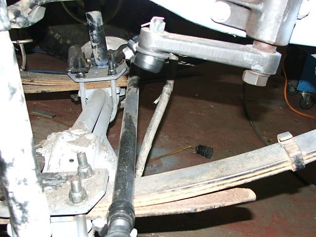

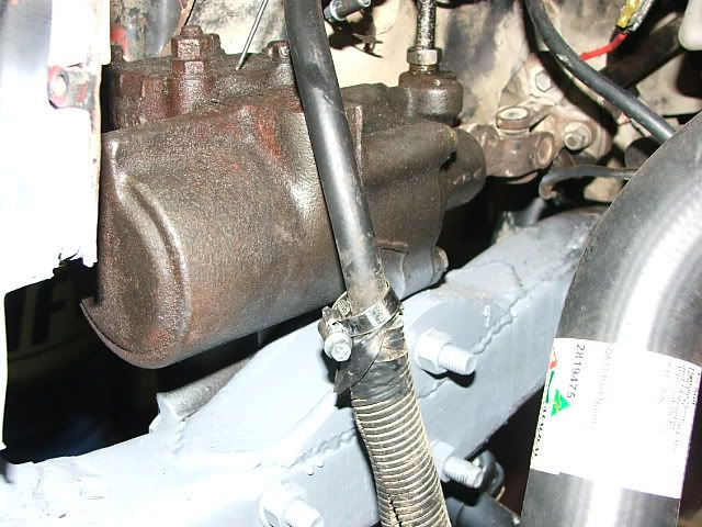

Steering box mounted
The flat pitman arm make this so much easier... you can see in the second shot there is nice clearance between tie-rod and drag link and I've managed to fit the original steering column

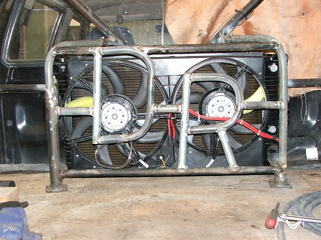

starting with the back end I ran some pipes up through the deck then decided to use them to make a bit of guard for the fans
had a heap of short bits of 19mm plumbing pipe and a couple of old tie-rods so :lol:

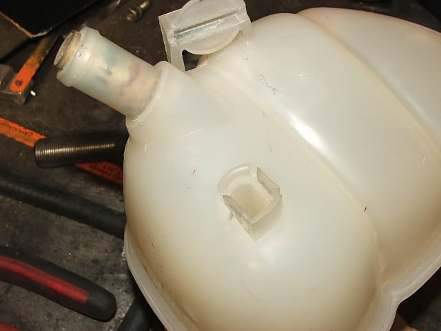

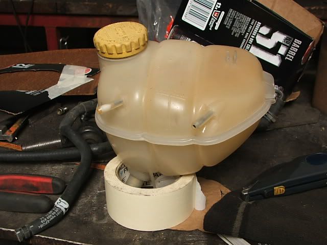

I'm now trying to mount the header tank wingnut got me :roll:
from where I'm sitting, I'm certain it was the cheapest thing he could find.... took me ages to work out how to mount it, here's a shot showing the factory mounting :roll:
a 6mm rod will fit into the hole and there is a spring tab next to it..... this one had me scratching my head for a bit but think I've got it sorted 8)
should have pic's tonight with a creative answer

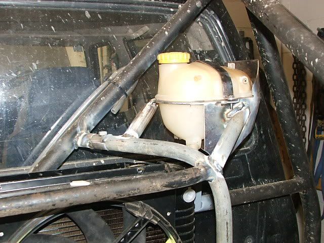

Sorted the water bottle, added a bit of protection since its sitting up a bit exposed

De-Ranged wrote:Image
D R - De-Ranged bar work
That is some cool sh!t right there!!!! Nice 8)
