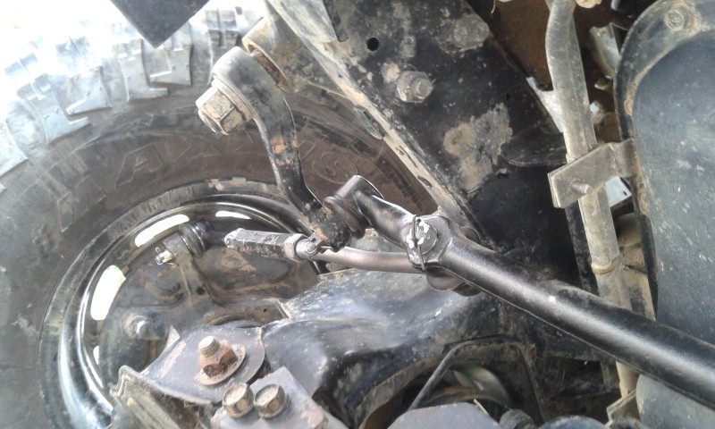

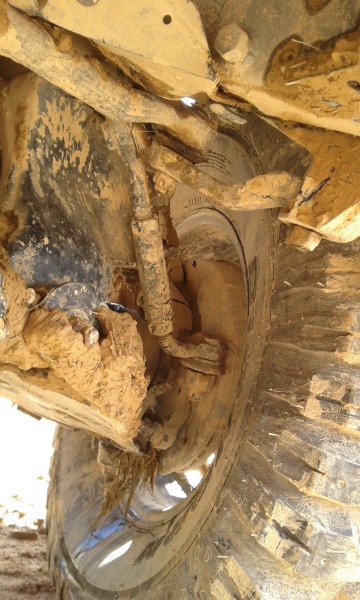

So my problem is grovling around in the driveway in the dark with a floodlight probably doesn't help.
the cross-rod looks extremely close to the sump and the inner tie-rod ball joint clips the chassis. I'm looking at the idler arm and even though it has the brace, it looks like what I did on Saturday not only bent the tie-rod, but also the idler arm slightly....
Check it out the upward force from this...

Yep, it looks bent orrite....I reckon we need to reinforce it like mine...you rough bugger!

She wasn't driveable.....
Surprisingly, I managed to get the tie-rod out and using those big new indestructable bars on the front of the truck, beat the living crap out of it to straighten it again. Worked a treat.
Next time I'll take the vice mounted to some box tube that is inserted in the hayman reece hitch.

OK, all sorted now.
Turned out I had done some real damage to the steering. Idler arm was bent up by about 15mm.
So it is all in now and I'm just playing with the 'eye alignment' now.
I used a 2WD center-link.
4WD outer tie-rods, (16mm, left hand threads)
2WD inner Tierods (18mm, right hand threads)
Existing adjusters and nuts, and just had the right hand threads of the adjusters and nuts tapped out to 18mm x 1.5mm to match the 2WD tie-rods. (Thanks DEATH_INC)
The center-link does run fairly close to the chassis, but seems to clear it ok.
If that idler arm gets bent again, will look at the steering box replacement for that side.
Cheers guys for all your help. Now to try the same spot where I broke it last time and see how it holds up :-)

any point in putting this in a truck at standard height? no lift, 31" tyres?
1992 Nissan Terrano
Paulballz
Posts: 183
Joined: Mon Jul 25, 2011 3:01 pm
Location: Whanarei
Re: 2wd steering mod for Terrano
Post by Paulballz »
31" are enough to bend the standard steering components cowman, i done this when i installed my 31s even before i wound up suspension...But obviously biggest problem is once torsions are wound up the angle of the arms...Hence i need to do something...Anyway point of reply whether my truck was standard or modifyed the standard steerings crap once it gets in the rough so anythings got to be worth doing
