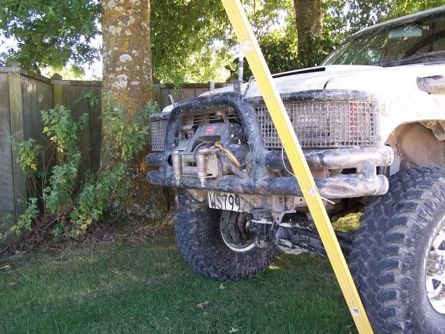

yeah i guess mid mount it is
have a fair bit of weight over the back now ... have a 120 liter fuel cell behind the cab.. and a deck with 5mm steel treadplate ... its probably about 120+ kg's by itself
all good needed a bumper for cert anyways :D
after that ill ethier straighten it up a bit so it pulls into the body ... or sell it on trademe for the 150 bucks it cost to make :d
without the winch there the front chasiss bar becomes the issue ... maybe i give it a 2" suspention lift ... but honestly .. i dont want it that high

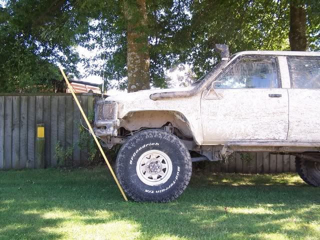

Those pic's are deceptive.
It has a better approach angle than a safari or cruiser with a standard PTO set up, and a shit load better than most standard electric winch applications.
Mid mounted winches are all good, but for practicality on a weekend bush truck, front mount all the way :D

DieselBoy wrote:Those pic's are deceptive.
thats what i thought, i was just imagining where an original bumper would be sitting, only one way to find out, get out some straight edges and do the math

Hey Wayne, looks nice. Move ya radiator onto the rear deck, move the winch back and down, then move ya diff forwards. Aim for an approach angle like this 8) :twisted: :lol: :lol:

Jafa wrote:Hey Wayne, looks nice. Move ya radiator onto the rear deck, move the winch back and down, then move ya diff forwards. Aim for an approach angle like this 8) :twisted: :lol: :lol:
Your approach angle needs more work Jafa :lol: :lol: :lol: :lol:
On a serious note Wayne, Jafa is right because the better the approach angle the more capable the truck is but for ordinary people like me those approach angles are not needed even to do serious 4 wheeling.

i do see your point
ill take some piccys later db is kinda right it is a little deceptive because my winch is 900 off the ground..from the middle of the fairlead
ill put a board up later and take a piccy
ps i hate you jaffa :D ... but i know its a great idea :D ... bar rteh fact i have a 120 l fuel cell where the rad woud have to sit...lol

vvega wrote:Image
You are right Wayne ,that looks good. The original photo gave a false impression
