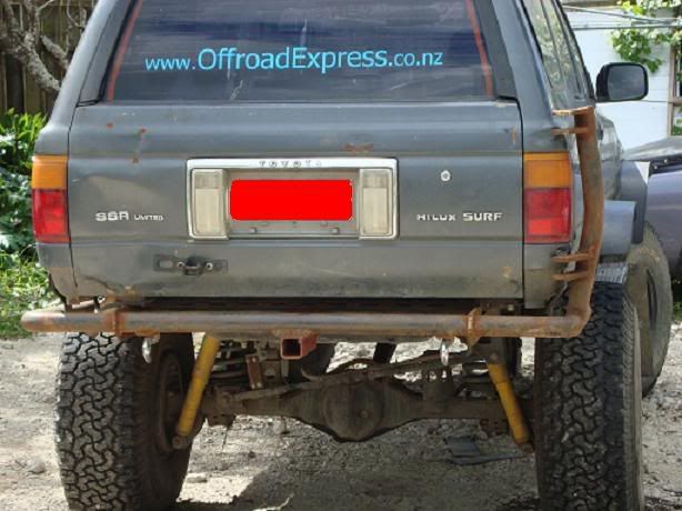

well bit of an update,rear bar is 99% finished,hooks on,removalble tow bar made up and spare wheel carrier with jerry can fitted,only thing left to do is put on passenger side vertical protection bar and paint
as of the other weekend the truck has now had bunnings flares added :lol: ,look heaps beta by being strait making the truck look higher cos they dont droop down covering half the gap,so im happy as with those

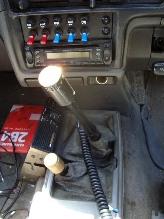

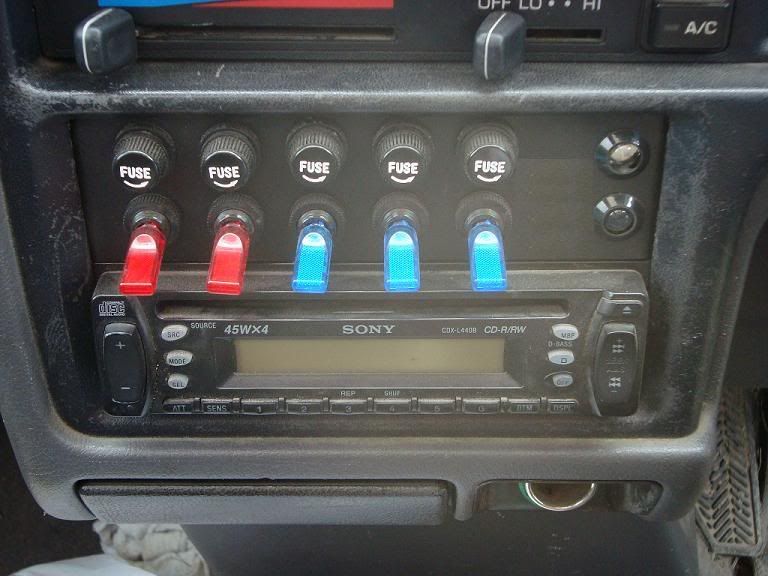

also got my new dash board control plate set up,nicely colour coded with some flash leds and in dash fuses so i can pop them out easily if i was to get pulled over :mrgreen: dont wana be caught with roof spots forward and backwards that work at anytime
speking of that got new reversing spots/work lights fitted,just ran a singe relay with double power feed,just with a 1way thingy on the feed from reverse light so thats made things alot easyier to see at night
along with all this im still attempting to make a start on my front bar and have now got a cb to install,lol,slow n steady wins the race

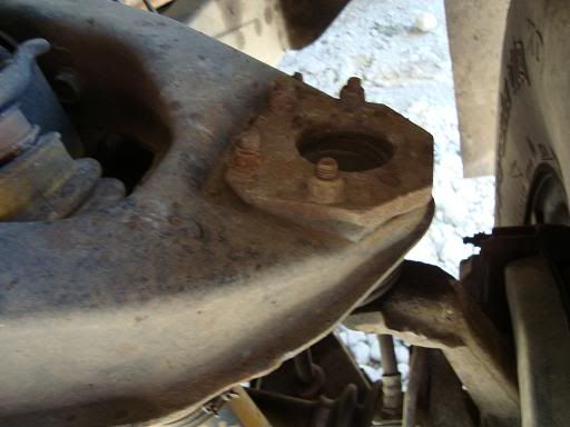

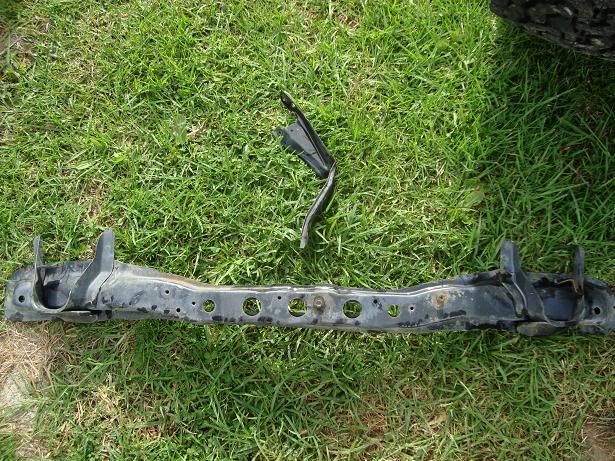

well few more pics,this is the pre mentioned modified arm
and a of last week the cbs installed

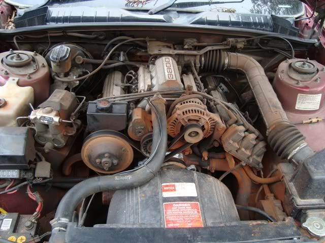

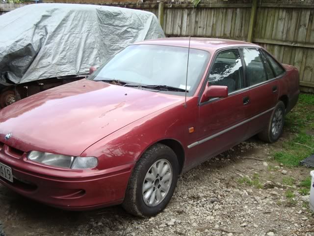

ok so been ages since ive updated but have been moving forward with things slowly :lol: ,here ma donour vechile,its actually a 94 vr commy ( previous owner had it completly wrong :roll: )
have tracked downa guy that can do a computer with stage 3 memcal for $100
have also talked to the exaust supplys guys and priced up a full 2.5" xaust with 2x flowmaster mufflers at under $300 so just got to get motor in so i can see which way im gona plumb it and go buy the parts,this should give it pretty good flow aswell as be usable and suitable for when the super charger gets added
a big thanks to tim whos been helping me through the wiring issues so i now know i just need a vn wiring loom and that'll get that part sorted
earlyer in the week i got the snorkel off and have flaper disked that back as it was starting to rust :roll: thatll serv me right for just spraying it with a can and rushing to get it on the 1st time

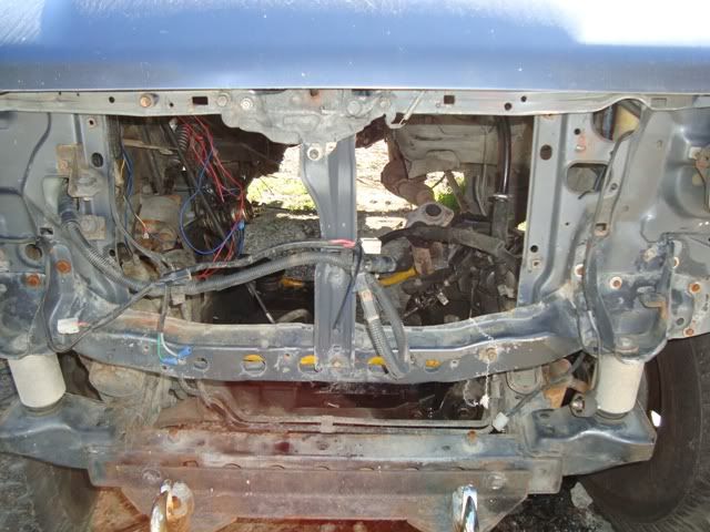

also got stuck into it this arvo after finishing off oscars truck,now have motor and box out,bumper and rad out plus few other extra bits removed :D
have also checked out the motor a bit,have picked up a new heater adaptor fitting from autolab which will fix the water leak the motor currently has,a whole $17 bucks worth :lol: ,but i do need it as id prefer to keep the heater option in my surf,motor once out im gona give a birthday,plugs,leads,oil service,fuel filter,and will need new xaust gaskets as they are slightly leaking,and them opnce in a good old rad flush and some injector cleaner and i think itll be good as new
have also picked up a new 4 in 1 tacho while on sale so thatll cover all the bases of watching the motor carefully in an attempt to pick up any issues before it costs me more moneythan i dont already have
plan for next week is to get the r150 box in and make sure i can utilise my old gearbox xmember otherwise ill need to modify or make a new 1,also going to remove the 3.8 ,so i can get that floating in the engine bay to start sizing things up,aswell as making a start on new engine mounts
mhm,thats alot of writing,enough for now

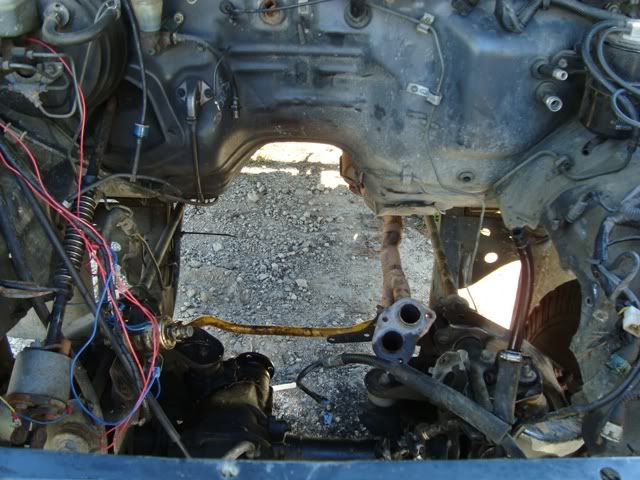

ok well more pics and updates,hers shots of the empty engine bay i have to work with

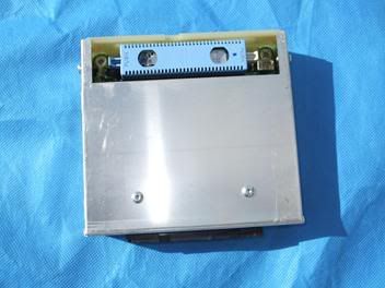

ok,well bit of an update,not much been happining latley due to lack of funding which wont arrive till feb / march next year but still managing to get a few things done
picked up my stage 3 memcal off trade me guy
(this is a vp comp as i canot use a vr computer with manual box,up until vp the autos where cable driven,vr and after its all electronical so there must be a auto box talking to the comp to make it work)
after that went to pick apart and got vn comp plugs for $15
(vr plugs wont match vp comp due to little tags being different,all wiring is the same tho so just a matter of popping all the pins out of each plug and reinserting them into vn plug in correct order)
also got a set of stainless steel extractors off trademe which are now just waiting to be put on
motor has been pulled from commy and water fitting replaced,motor was then just sat back in engine bay till i make more progress with bellhousing
gimmemud
Posts: 1043
Location: North Auckland
Re: 1990 TUF LUX
Post by gimmemud »
muddyhilux wrote:ok,well bit of an update,not much been happining latley due to lack of funding which wont arrive till feb / march next year but still managing to get a few things done
Get a stanley knife on to those little tabs on the plug and it'll fit on any comp. Done it on mine and seems it might be a bit easier than changing all the pins.

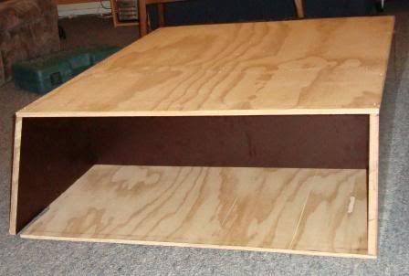

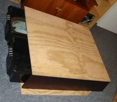

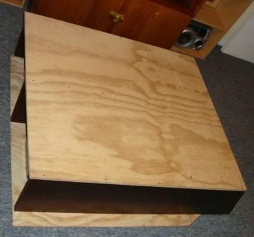

finally starten to do lil things here anbd there,knocked up these draws tonight,fit all my gear and stil space left,in vechile shots to come,bit dard now :lol:
back compartment can only be accessed via folding down seats but looks like its not ther from the boot/kind of :lol: ,but yeh,good for packing bags in before going away,n just helps keep things tidy,also gonna look at putting tyre on top of box and straping down,its ok on the rear bar at present but yeh,just so much weight and over hang im having second thorts but will see what hapens,also doesnt way anything like i thought it would so happy with that too

muddyhilux wrote:Also gonna look at putting tyre on top of box and straping down,its ok on the rear bar at present but yeh,just so much weight and over hang im having second thorts
Yeah, I have the same problem, and mine are only 33's ...
