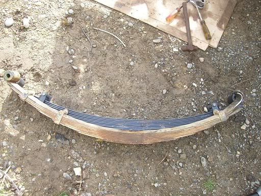

smurf182 wrote:Keen to hear recommendations on new products or if anyone has a set kicking around in the shed that would be ideal.
I've always liked OME springs and the ones in the front of my 70 series cruiser are awesome and articulate really well for what they are but I dont recomend the 40 series OME springs the 50mm lifted set I stuck in the front of my cruiser are 50mm lower than the broken lovell springs I took out of it, they sit about 50mm off the bumpstops and are stiff as a board and dont move much when it comes to flexing :?
