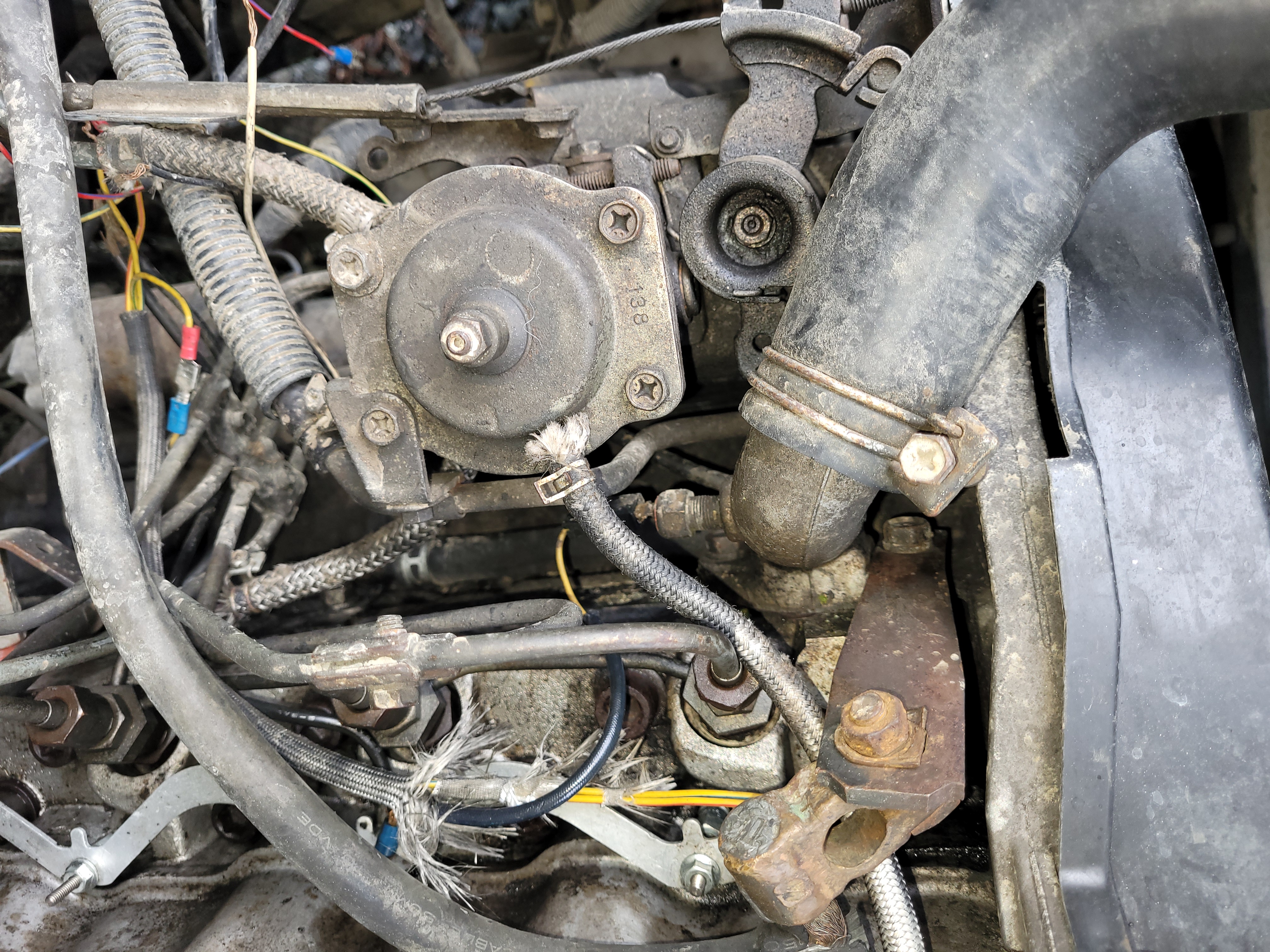

Wiring for the motor is as tidy as my teenagers bedroom. Plus seem to be missing a number of controls in the cabin.
Check out that earth srap bro...
Winch isn't running, Well not even wired in. WTF

The existing thermostat had been put in the wrong way and had been jammed open with some wire. WTF
New thermostat (correct thermostat) looks much better. A bit tricky to get in as you need to put a dab of high temp silicone to glue it in place.
Runs perfectly now. Maintaining around 80 degrees and gets only to 95 on a long uphill with my foot in it all the way.
