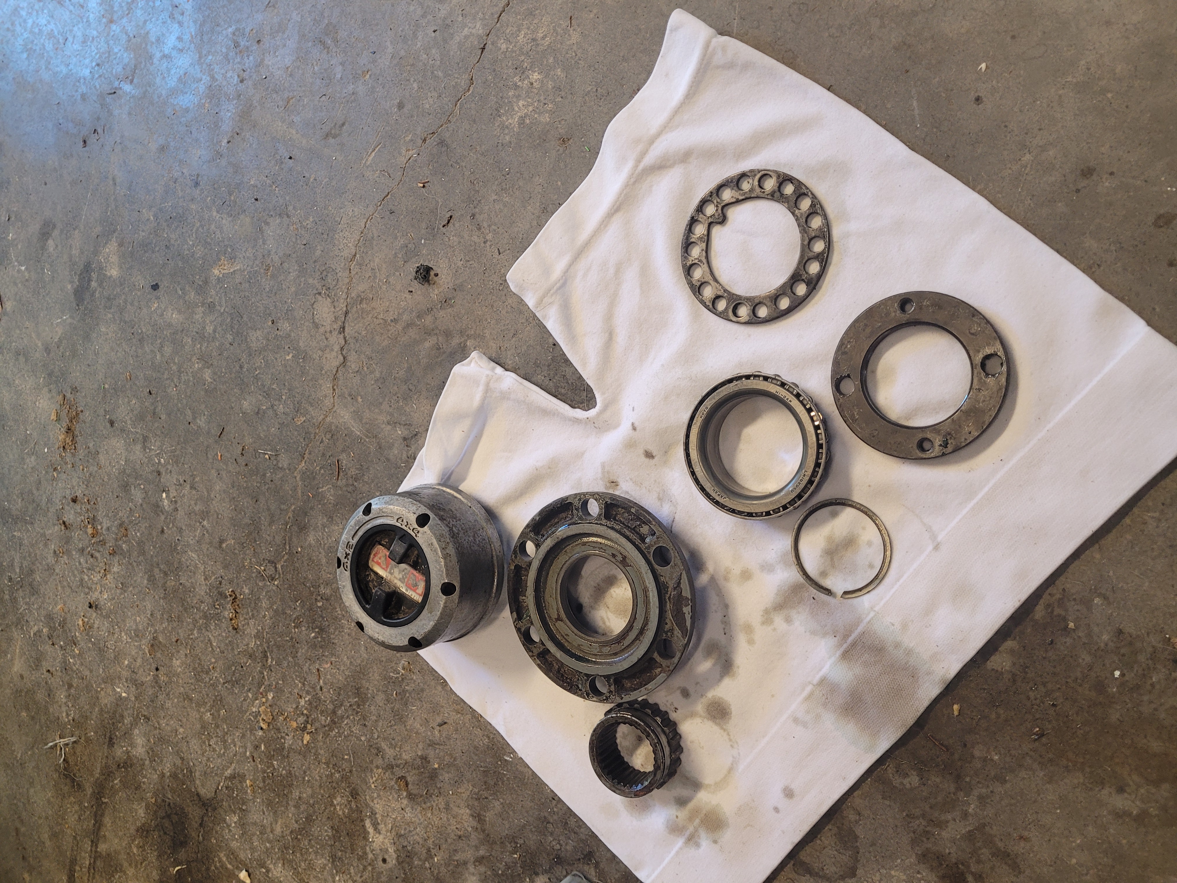

Front left wheel bearing a little bit of play. So a rebuild was in order anyway.
