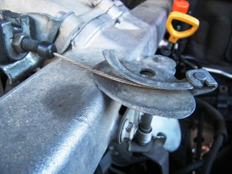

So twice now, once while giving it the right slipper heading up the passing lanes just out of Moerewa, and again in 5:00 traffic yesterday while again with the gas on, the accelerator has stuck on momentarily after taking my foot off the pedal, only for a couple of seconds, but enough to give me the shits.

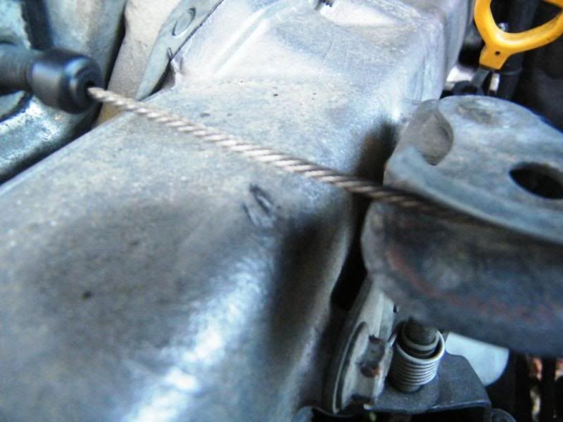

Today I thought I best have a nosy to see if there was anything obvious. 30 seconds after opening the bonnet it became fairly evident what was going amiss.......
Simply bending the bottom up should have solved the issue, but it had the potential to be real farkn nasty.
Is this a regular problem, or is mine an isolated case?

Damn nasty .....but why did it bend??
Is where the cable is attached on left hand side too low & tending to bend the bottom of guide ...if its bent once it WILL bend again.

I agree with above in so much as that cable approach angle looks to low.

tallsam66.... nah the cables seated right. I can only assume that when the new engine has been put in its been bent while off, and hasnt been picked up once its been bolted back on, or, judging by the scoring on the inside of the fitting below the cable, that its been well bent at some stage and not been fixed properly. I'll have another look at the cable angle tomorrow. I'll be keeping an eye on it for sure.
