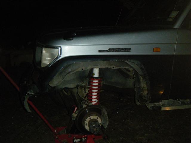

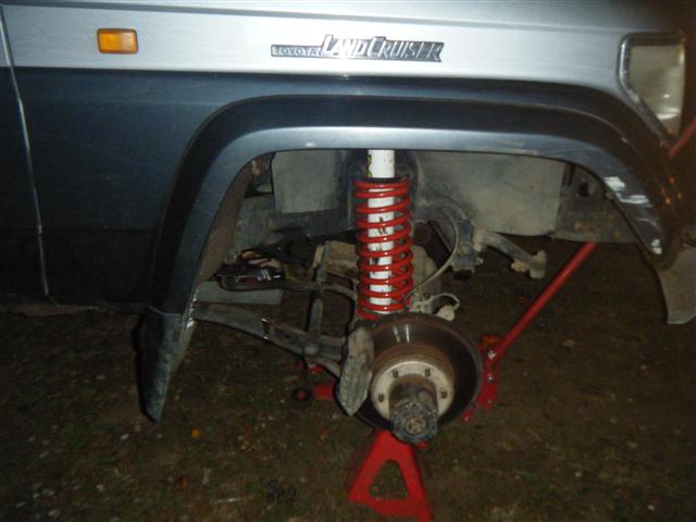

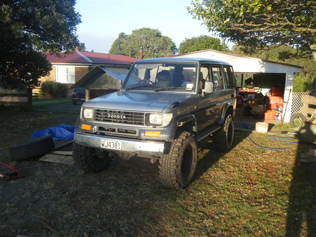

Anyone here fitted these? need to trim rear of front guards, cant even turn without bad rub. I knew id need to, but have never done panel work, so just wondering how you guys have cut and folded yours. got spare panel steel if i need to fill/cover a hole.
Pics help and any advice will be much appreciated.
Some pics to keep you all happy. Will look better with bar work. but thats 3rd on the list.
78 Series Prado Guard trim for 36's

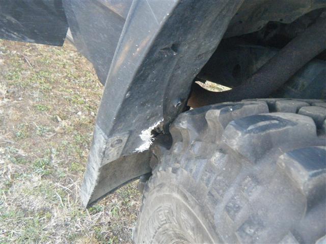

Calvin, did you trim your rear guards at all? mine got a bit munted when articulating or getting a decent bump.
Re: 78 Series Prado Guard trim for 36's
I haven't done my rear guards as yet... Only get slightly kissed, but that may change with the new softer springs...
Also my tyres don't stick out too far... As my rims produce a similar offset to that of the factory alloys.
A chap in our club is using a set of rims with -44 (15x8?) and they hit real bad....
Might need to extend the bump stops...
Yeah my rims, 15x8 have a huge offset. stick wayyy out. oh well, just have to pave the way there then. rather trim than lose the little articulation i have. maybe when i get my other set of rims flipped, ill get them slightly less offset. then run those as rears. yeah have got template printed out but left it at work. looks like it should work sweet.
