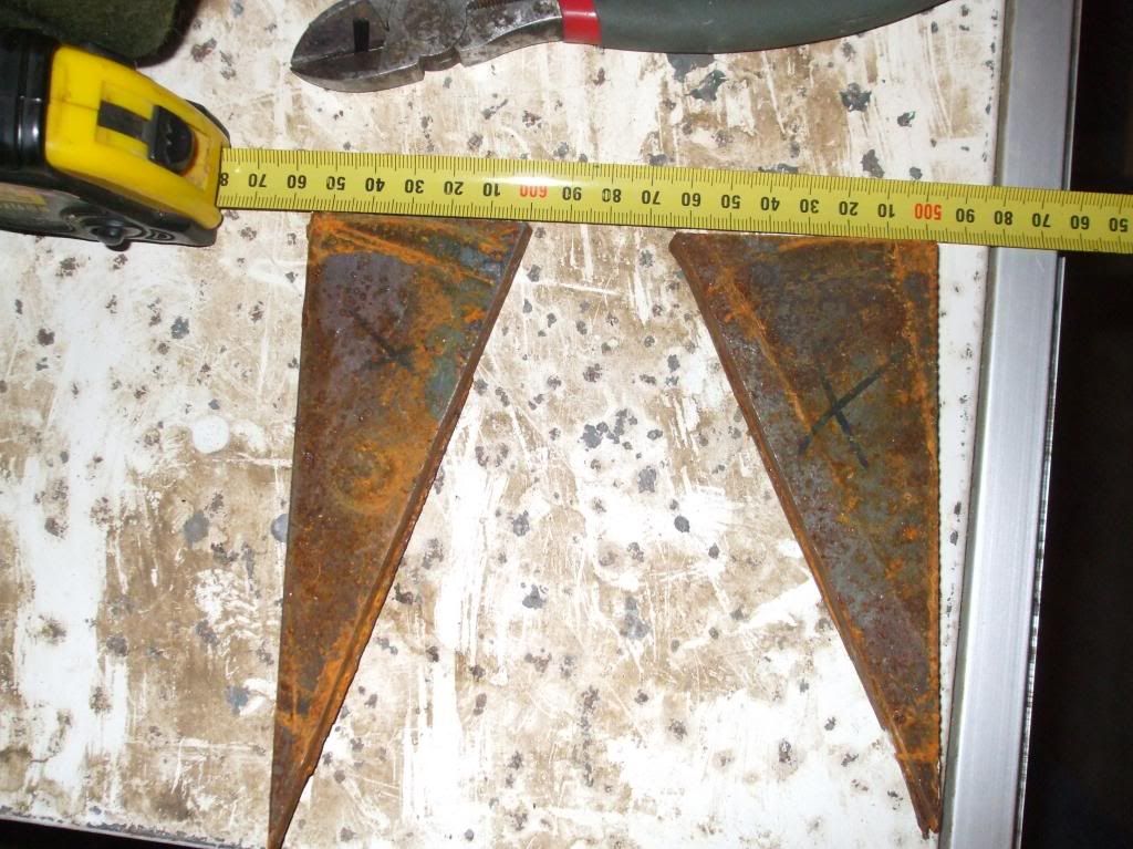

take the bumper and subframe off. measure the distance between the two mounts.
use this as the measurement for the length of plate you need to cut.
center the drum on the plate. not the winch but the winch drum as the motor housing and gearbox housings are not equal. mark the holes and drill accordingly.
measure in 65mm from both sides along the front edge of the plate.
draw a line between that mark and the back corners of the plate.
you should get something like this when you cut them off
http://i1309.photobucket.com/albums/s621/crashbandicoot2/DSCF2656_zps9171c0af.jpg

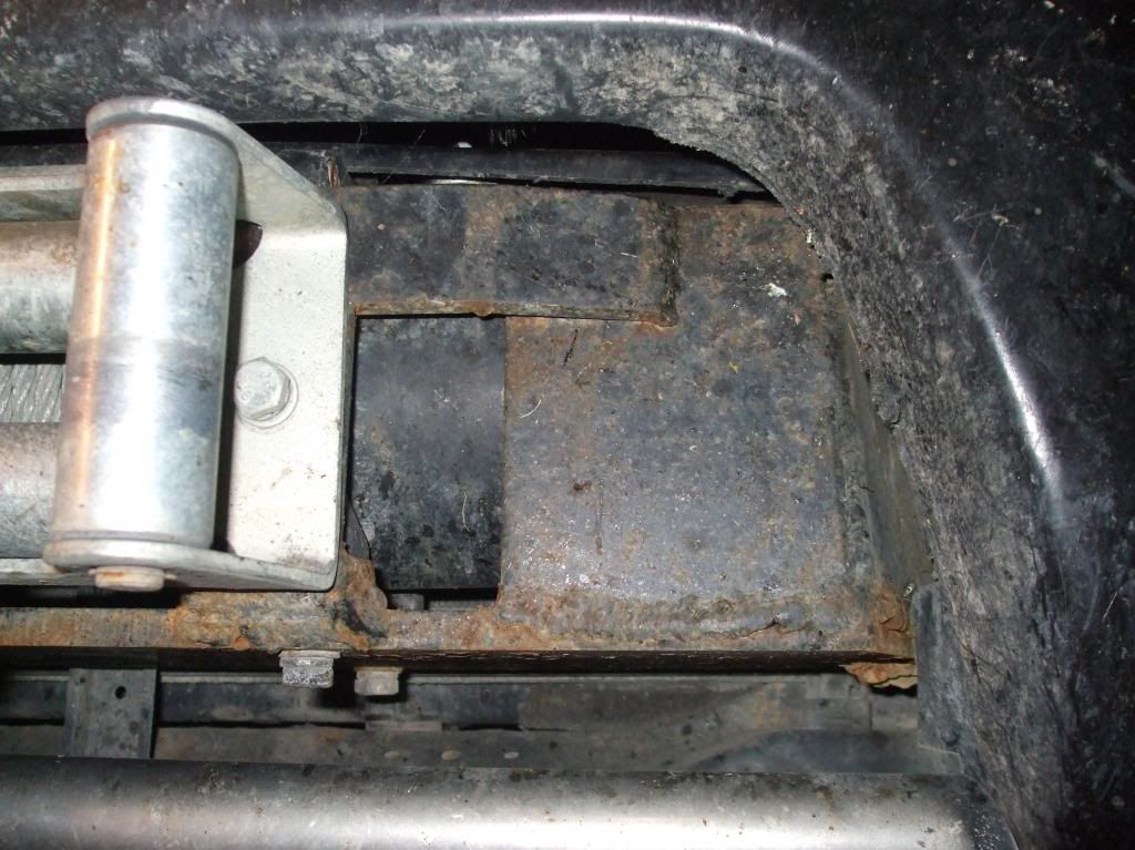

you now need to make some mounts for the fairlead. my principle was dead center no higher or lower. the center (vertically and horizontally )of the fair lead is the same as the winch drum, cant go wrong with that,
grab some 50mm x6mm and bridge the gap accross the front of the winch mount above where the cable will run.
then either side of the drum weld in some more 50mm x 6 mm vertically like this ....
http://i1309.photobucket.com/albums/s621/crashbandicoot2/DSCF2649_zps07617e74.jpg
thats the major stuff.
weld it all up paint it put the cables on the winch (then bolt it in)
after that mount the solenoid pack. the cables are just the right length to do it like this...
http://i1309.photobucket.com/albums/s621/crashbandicoot2/DSCF2644_zps51f0d075.jpg
