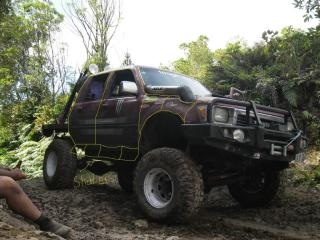

This is the plan plus a cross on the roof and also one under the front windscreen

The only issue you have with the double cab is the "B" pillar clearing both doors and keeping it in nice and tight. ( I seem to recall the mad pom having a problem with this anyway).
Have a look at other Dcabs that have been done, and see where they put the support.

Yea have heard that... And will take it into account we've had a read up and study up but I like the idea of having one so we gonna give it a go and c what happens will keep u posted
