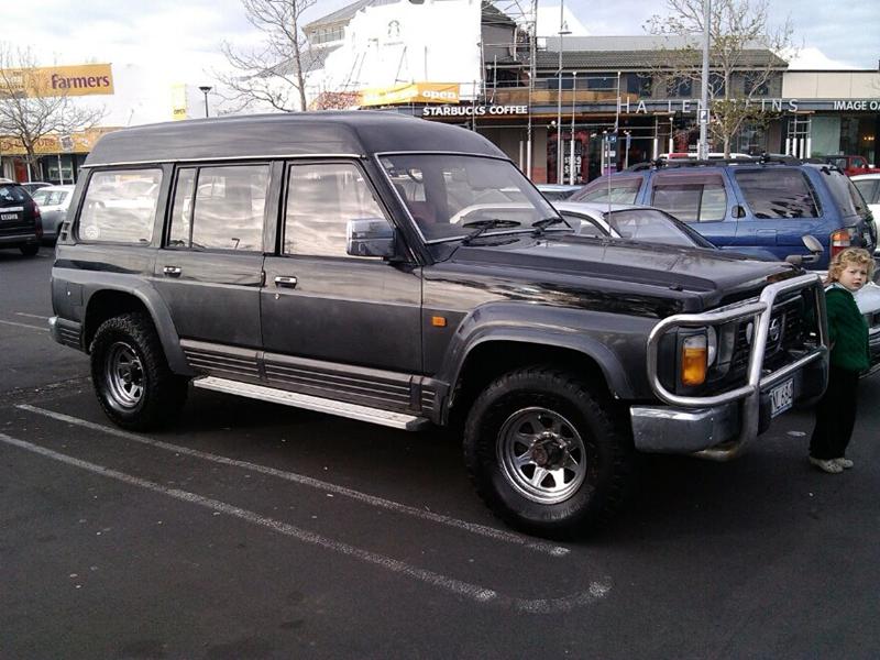

awesome guys, Thanks for the help.
just picked one last night.
Manual, high roof, 220km on the clock and in way to good condition but that will soon change...
Just ordered in a set of springs and shocks ready for the weekend. might chuck some pics when im done.

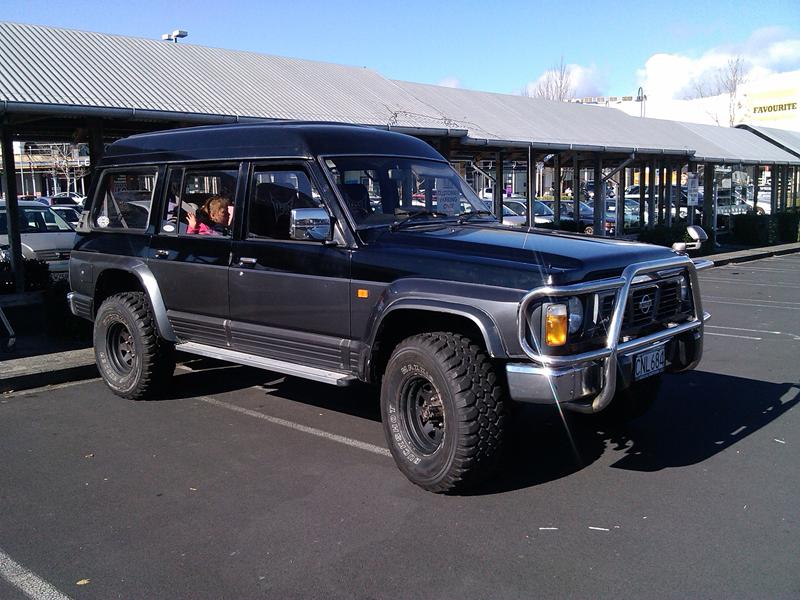

I have a lwb Saf non turbo, I have the 60mm cobra HD springs and 35s i still get massive travel i just cut the guards front and rear, Also i have the rear quarter chop and get only just a very small rub on the rubber flare not the guard at the rear. Im very happy at how it travels on and off road.Hope this helps
Re: Safari LWB Y60 set up
Tafftunk - Thanks thats exactly what i went for (without the choping and 35's) just with 33's. Awesome ride doesnt seem to effect steering at all. Put them in with KYB extended shocks this weekend, done 200kms on road and all good so far, still needs a propper test though.
