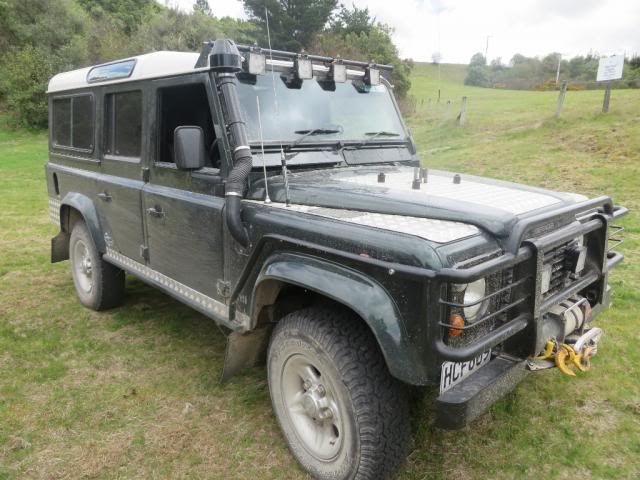

It survived a 6 day mission at labour weekend with only a few issues
First issue was hilarious, ubz said there was water pouring out the back from the rear windscreen washer. Considering there is no switch for the windscreen wiper and washer, and the wiper has been removed, how was that possible? Even stranger was that it stopped when I unplugged the gps. Turned out the power and earth i borrowed from the washer switch when i removed it, wasn't actually that, it was the circut to make the washer motor go, so plugging something into the multi plug like the gps turned the rear windscreen washer on. Hilarious!!!
Pretty sure the water pump is making strange noises, and it kept blowing stop and reverse light fuses, but other than that, its all good
The shiny paint didn't last long either

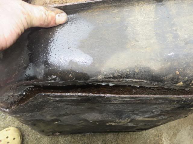

Thursday night I arrived home to a Diesel slick running out the back of the truck. I had filled it up on Wednesday night. Yipee
Nothing for it but to put on some old clothes and go get covered in Diesel. I have now found the downfall of having a dual tank system, you gotta have a lot of containers on hand to drain the fuel into
The tank has had a good hit in its previous life, the dent to the actual tank is a lot worse than what the tank guard allows you to see. I filled the gap with silicone a few months a ago, but obviously it was to far to late and what ever has been going on between the guard and the tank has finally caused a leak.

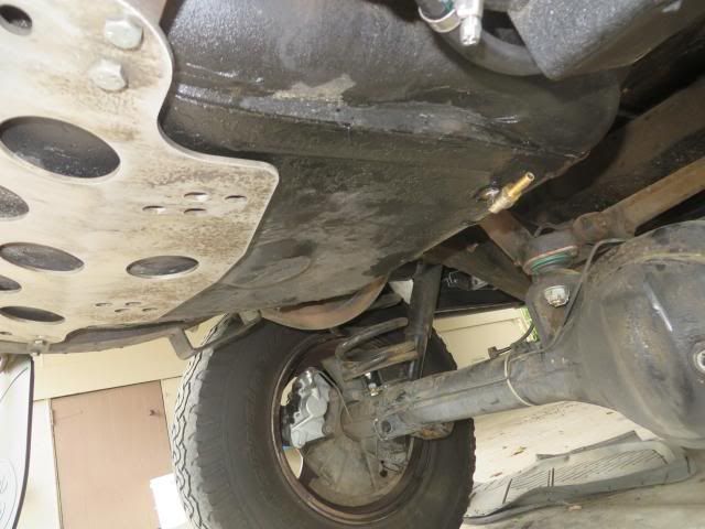

Been churning all day on the issue the of drain plug on the new main tank being different to the old main tank.
The problem being that drain plug is used to link the main and aux tanks together and equalise the level as the fuel from the main tank is used.
Its a pretty ugly system, but it works:

I ended up finding a M14 Banjo and Bolt that fitted the drain plug, its in and working a treat

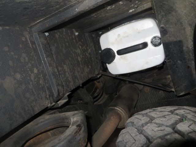

I have been mostly doing boring un-post worthy stuff, replaced all the bushes and ball joints on the front end, new clutch, rear main, H.D clutch fork, slave cylinder just that sort of thing.
A couple of fun things that I have managed to get done and remembered to take pics of, are the roof rack, which started off as this:
....and ended up as this:
The stainless container takes 11 liters of emergency water, it will always be full. The jerry cans will always be empty when on the roof, they will be carried inside the vehicle when full and put into the main tanks as soon as their is room so they can go back on the roof empty. The tin box, buggered if I know, but I'm sure it will get used. The empty space in the middle will fit an empty 20L water drum if required. Might even chuck a full sized axe up there. The basic idea is to keep it really lite up there.
I also needed to increase the water storage capacity, so sneaked in another 20L drum under the rear guard, taking the total potential water capacity to 91 litres:
Strapped in with a little tie down:
The support frame:
Bonus is that a 20L Jerry can of fuel could go in there instead.
