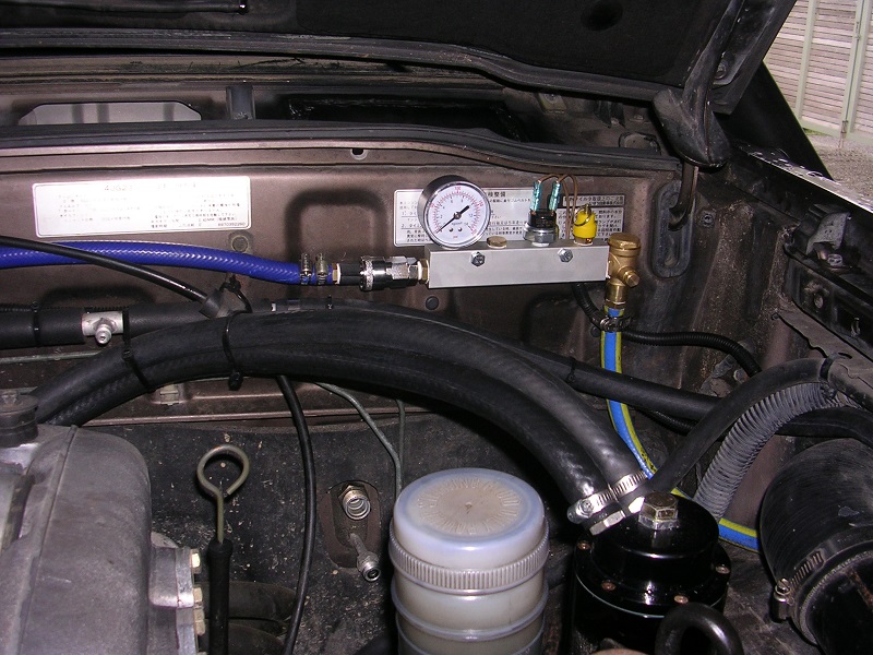

I put together a manifold which has an unloader valve on it, then a number of ports for my fittings such as pressure gauge, safety valve, pressure switch, quick connect coupling etc.
You can get away with a lot less but it's handy to have it all setup permanently like this. Cost was about $100 I think for all the bits and pieces.
I used a high temp hose off the compressor as it gets very hot under load and the plastic hose can slip.
