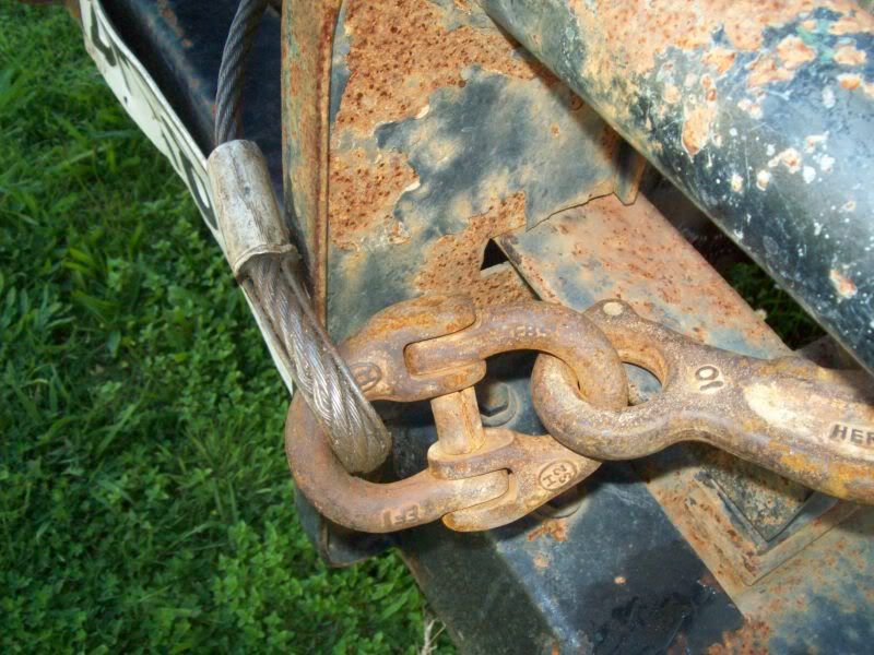

hi i have some synthetic rope with a stainless timbler and need to conect it to my hook some how does anyone have any ideas. i have tryed a shackle but it wont fit. and what sort of rating it may need. the winch is a warn m8000
Re: conecting winch rope to hook
go see steel and tube an get at lifting chain joiner they are rated

coxsy wrote:go see steel and tube an get at lifting chain joiner HAMMERLOCKthey are rated
more proof that i don't know everything thanks :D

went into a local store (wrightsens) they had hammerlocks in there but none of them were rated any higher than 1ton. i need to get some steel from steel and tube anyways so might have to take a trip down to whangerei now. what sort of rating would be suitable?

I'd suggest a quick trip to Cookes if you're going to Whangerei - they'll have something that would suit you just fine. Hammerlocks can also be known as Chain Connectors.
http://www.cookes.co.nz/whangarei
As for what rating you're after, consider the following quick calculation :)
Assuming a vehicle weighing 2t.
2t vehicle stuck in deep mud (ground factor of 2) = 1t rolling resistance
lets assume the mud is on a hill of greater than 45 degrees (weight of vehicle x slope in degrees divided by 60. This works up to 44 degrees - 45 degrees plus, just add weight of vehicle) = 2t
incredibly, all 4 wheels are locked! (.25t per wheel station on vehicles under 5t) = 1t resistance
pull required = 4t
plus a small safety factor of 1/4 = 1t
Total pull required = 5t
This is a worse case scenario based on a vehicle weighing 2t. A hammerlock with a Working Load Limit of 3t would more than suffice (working load limits for terminal tackle (chains, hooks etc) can be safely doubled in the recovery role).
However, a more pertanant question to me would be what size loop is on the end of your rope, and what size hole is in your hook? You may find that a small hammerlock will not fit and you would be better off going by size. Also, ensure that the WLL of any hammerlock you choose to buy is at least half that of the rated line pull of your winch. This will ensure that you can't overload it, no matter what configuration (1:1, 2:1 etc) you are using.
Any questions, please ask :D

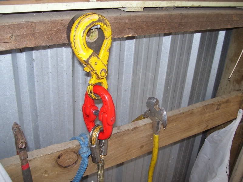

This is how my overbraid ropes been spliced, I didnt splice it myself so dont ask me how to do it :mrgreen: :mrgreen:
darinz wrote:I get 2 comps plus general use per rope before I retire it to a backup rope or it goes onto a support crews truck. My co-driver has a rope that was used for 3 cpmps and has now been on his truck for 2 years and it is still going strong. This 10mm Dynamica so not one of the cheap brands but you get what you pay for!
monstr wrote:I can usually get at least a years worth of comps out of 1 rope then its used as a club rope ..
thats the reason i went with the dux overbraid, if i look after it, it will last many times longer :mrgreen:
and as steve said, its the same to splice as normal synthetic rope you just have to peel the O.B back,
or use a hammerlock
or better again is take it back to carolyn and get her to do it for you ,smak a bigger thimble on it :wink: she is after all the best :mrgreen: and you will end up with a primo job
Sadam_Husain wrote:This is how my overbraid ropes been spliced, I didnt splice it myself so dont ask me how to do it :mrgreen: :mrgreen:
thats the factory machine splice from where they make it over in nordisk or sweeden,germany or whereever the factory is :wink:
