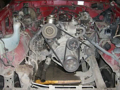

i realise the 2f is vastly different to the 3b powerhouse i'm running ( :lol: ), but if it helps i could post up a pic of power steering pump on mine fer yee? just holla if ya want it up.. if not, no harm no foul..

niblik wrote:i realise the 2f is vastly different to the 3b powerhouse i'm running ( :lol: ), but if it helps i could post up a pic of power steering pump on mine fer yee? just holla if ya want it up.. if not, no harm no foul..
8)
Yeah post it up always good to see other ways people have done things
Didn't barbie drive a jeep??
Re: FJ40 2F power steering
Thats where the pump sits on a 3F, its the same block as a 2F :mrgreen:

Cheers,Dam thats a long belt :) Ive seen a couple of 2fs with different pumps mounted there. one i saw used a crown pump/reservoir with a big custom made bracket to suit an a extra pulley on the fan hub which was the sorta thing i was thinkin of doin

Fakey wrote:Dam thats a long belt
Nah there twin pullys and 2 belts, both go from the crank to the waterpump pully then split their respective ways. I gave the pump, brackets and pullys to the guy that brought that motor off me, Abbo's mates got it all now but I dont think he'd want to sell it? :mrgreen:
