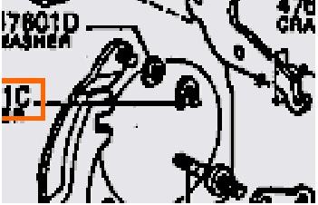

In the process of replacing the brake shoes and cylinders on my Hilux, I managed to stuff the little U shaped snap ring that holds one of the handbrake components on. This is what I've broken. Where can I get a replacement? Can I just use a circlip? The springs etc are all still in one piece but quite rusty. Do they sell kits with all/some of the extra components?
It's part number 47601C on here
http://www.toyodiy.com/parts/p_J_1985_T ... _4706.html

Circlip with a washer behind will be fine.
