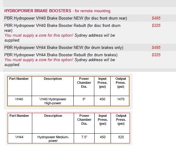

dunno about the hilux stuff but I'm running 2 boosters, I stuck a VH40 remote booster inline on the front brake circuit and my 10 ton cruiser pulls up like a 2012 commy with no effort on the brake pedal :P 8)
