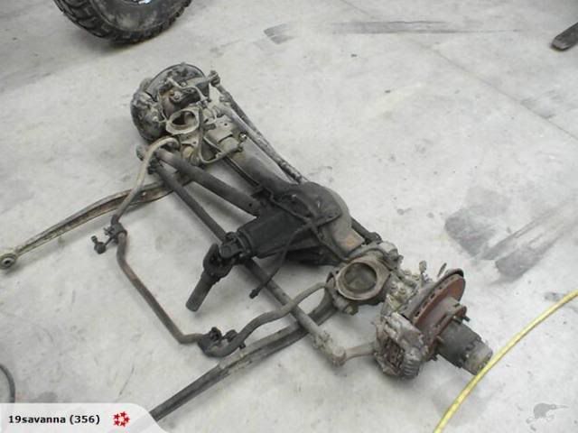

hi guys im needing some help as i failed cert - to much body roll
so can someone please put up some pictures of there front sway bar on there 78 series prado, where it mounts to chassis, a parallel shot looking down chassis so can see both the chassis and axle mounts for sway bar
or even better there sway bar on a 130 surf with a prado solid axle
cheers john

Sorry I dont have any pix but........ What you need is a 78 Prado swaybar. The prados have bolt on chassis mounts bolted onto the inside of the chassis. You need these too. Simply weld the Prado bolt on mounts to the Surf chassis once you have the swaybar bolted to the diff. Really easy if you've got the parts. The links are easily available in a multitude of lengths.
If you cant get your hands on the chassis mounts then you should be able to fab some up easy as

this ain't in my surf yet but is my 78 series diff i picked up,you can see sway bar and the links used.i never got chassis mounts but will be making some up easy enough.hope its somewhat helpfull
- jonossiksilvia
- Posts: 727
- Location: christchurch
Re: need pictures of 78 series prado front sway bar
Thats perfect cheers
