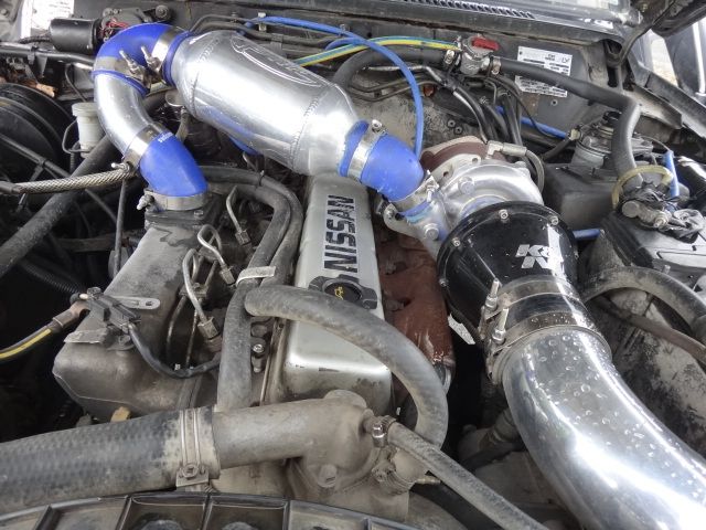

sibainmud wrote:Image
Those two pipes painted blue.
Are they off the Nissan Mistral/R20 Terrano II.
Or did you make them?

travis2ninja wrote:Those two pipes painted blue.
they are silicone bends
you may be able to get them at repco/supercheap etc
Re: Intercooler options
Posted: Tue Jul 23, 2013 1:41 am
by travis2ninja
No, those two pipes that are bolted to the Intake manifold and Turbo.
Also that pipe that runs from the crossover pipe, down to the injector pump for the boost compensator. When i put the intercooler on. Where do i attach it to? Because there is no pipe fitting on the intercooler itself. Do i make it longer and tee into where the waste gate actuator is, or drill and tap like you have done?
Posted: Tue Jul 23, 2013 6:23 am
by sibainmud
Made the pipes. Drill and tap somewhere easy to get to and that is where the boost compensator and aftermarket gauge are plumbed in.

You wouldn't happen to know what kind of pipes are on the Nissan Mistral?
Or is is a different manifold and turbo housing?
Posted: Tue Jul 23, 2013 12:28 pm
by sibainmud
The two hoses that you see are the standard ones off the mistral. They do have different manifolds and the later model garret turbo. I did mine this way apart from my tubes , everything else is standard factory. Makes for easy replacements as I seem to need from time to time :twisted:

Mine is off a Nissan Mistral/Terrano II...
It measures at 245mm x 240mm x 70mm
